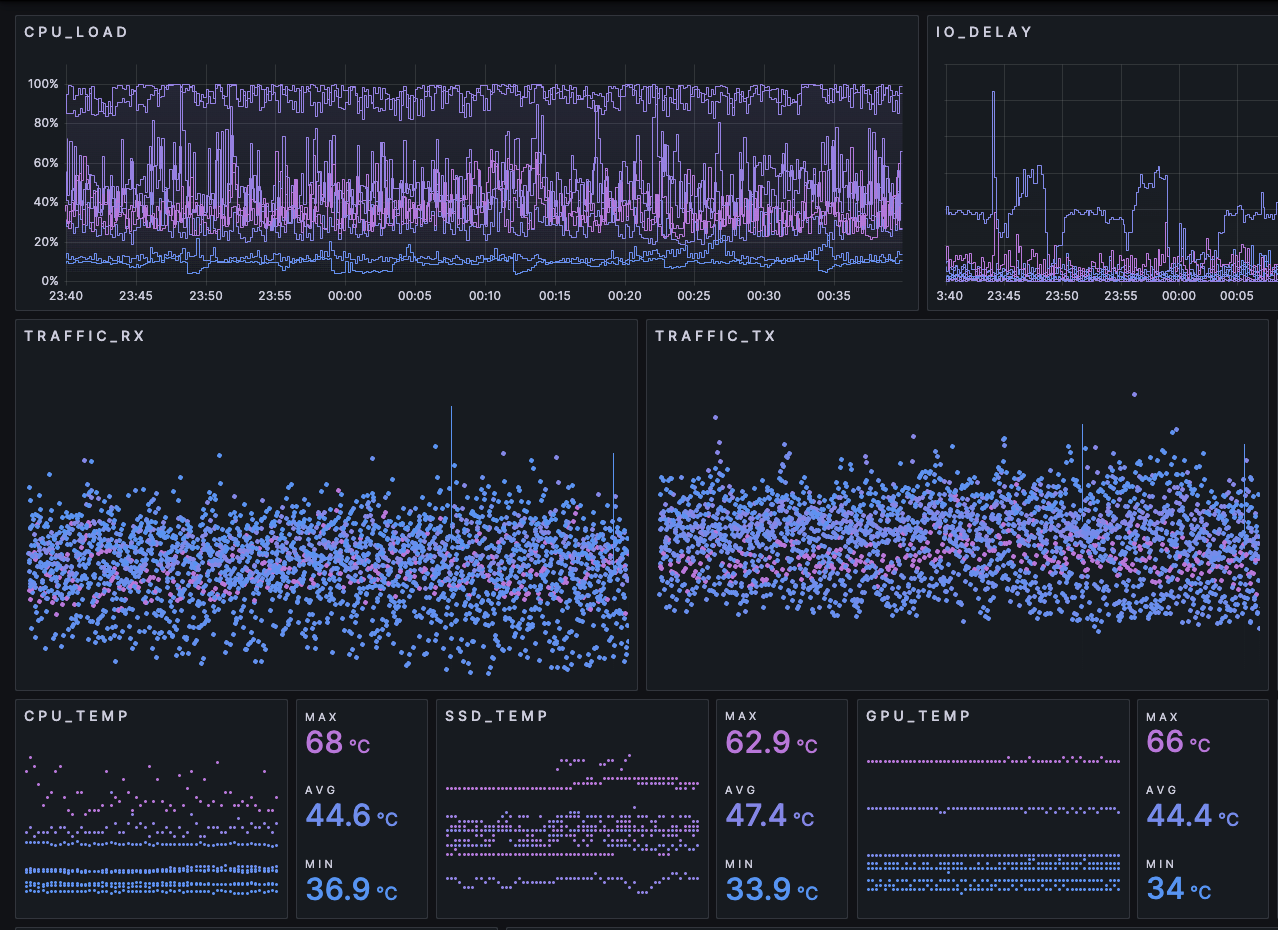

For which service? The adblockers handle about 30 clients, here's the cpu usage for two debian VMs running those dockers I mentioned:
