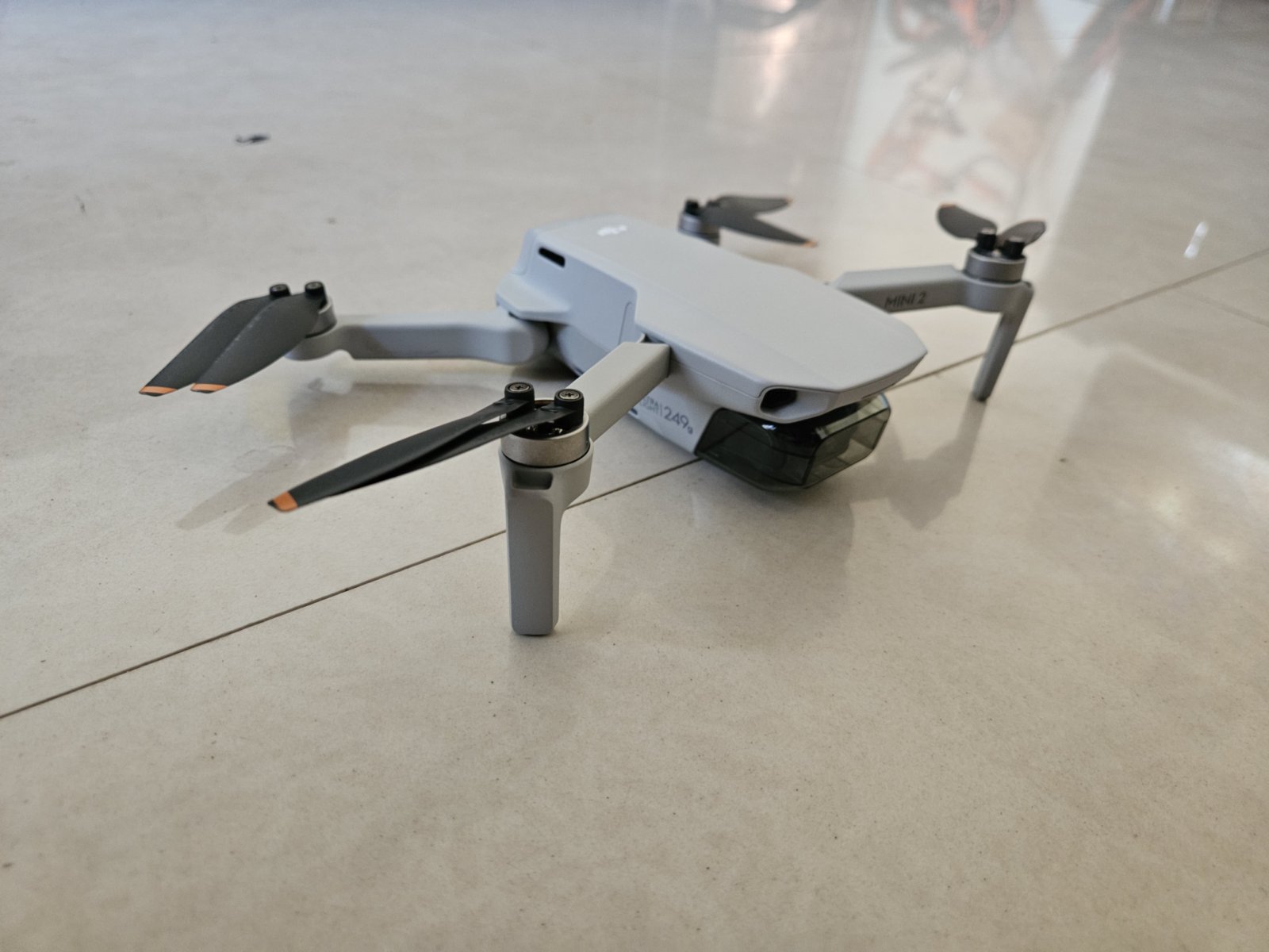

So DJI Mini 2 has height restriction of 120 Meters but this needs to be done everytime the drone is started, as it gets stuck to 15 m.
The process is to reset all settings once the drone is connected, then start the drone again and then the height is set to 120 Meters.
Its little annoying to do this everytime so is there a better or permanent way of doing it ?
is there a video showing how to do this.. I use rainbow app to use to raise it above 15 m
Update the DJI fly app.
Now do this:
1. Start the drone and RC.
2. Click on reset all settings in about section.
3. Drone will switch off in few seconds.
4. Restart the drone and check the limit. It should be 120 now.
