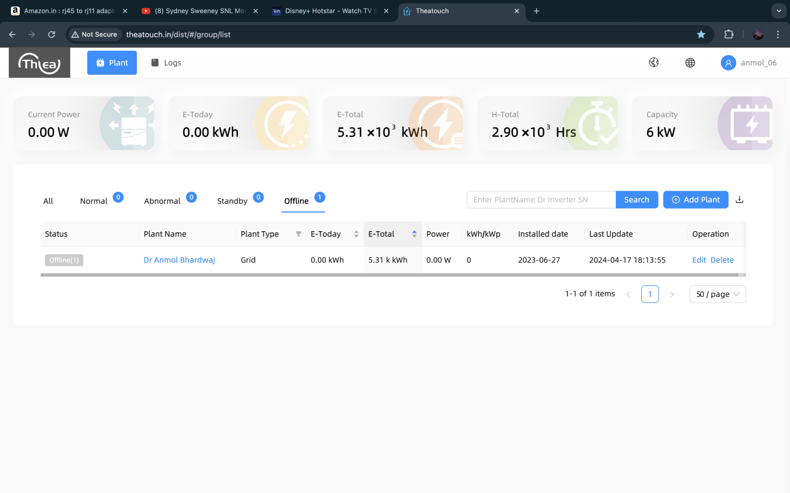

got it installed last june costed about 3.3 L for 6kw plant this is after subisdy.
the cost would be covered in 4-5 years for me.
now for bills I used to get monthly bills of rs 3000-4000/month now its reduced to 700-1000
usage is just for my home.
currently its generating 30-32 units daily

will be upgrading this 6kw system to 10 kw soon by adding one more inverter of 3 kw capacity and 8 panels.
