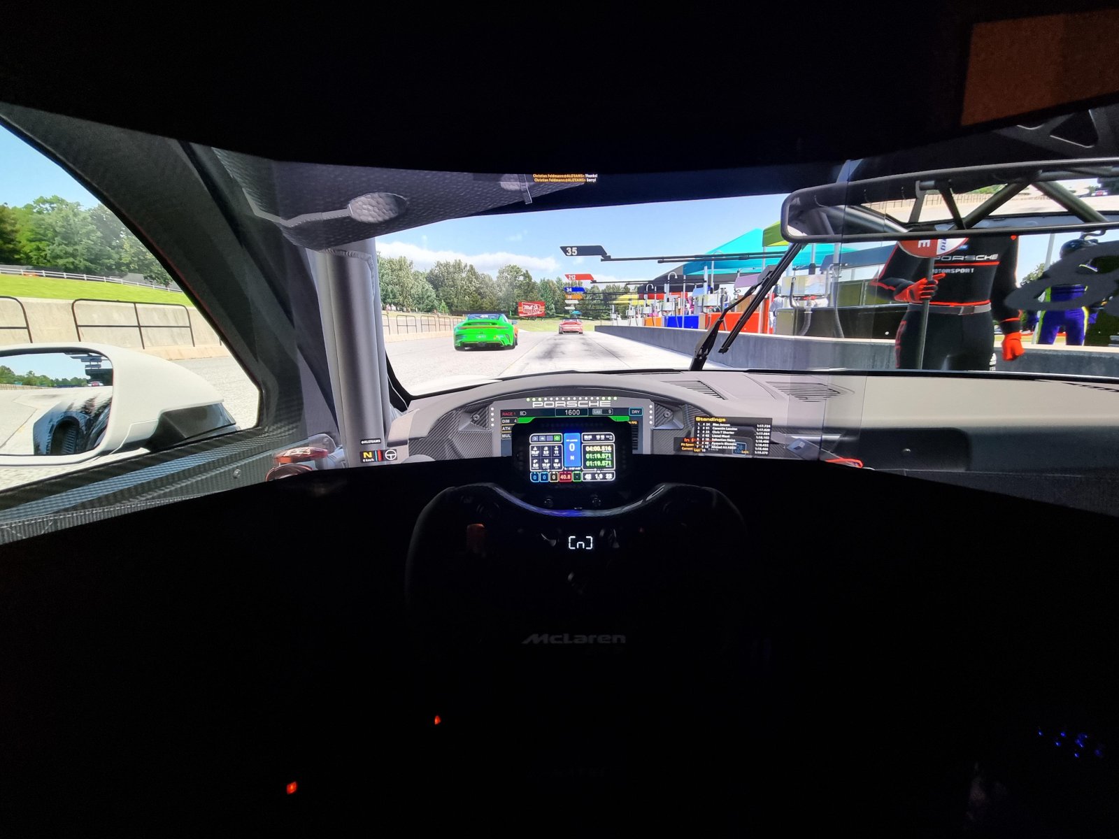

Regarding display height, most people running triple screen will only be seeing through a narrow part, with the rest showing virtual dash and sun blocking sticker on the windshield. So with a real dash in front of you, the narrow vertical view will feel realistic. Eg:
One thing I've learnt about screens. Bigger is always better. However, in this particular case, there might be a reason to use a smaller screen.
Bigger screens exaggerate motion to the point it can be disorienting as a larger part of your view is changing. This may or may not apply to some people. Especially if things are moving fast and continuing to do so as would happen with a race. A smaller screen would reduce that effect.
He should post a photo with the screens on with the same point of view as above
That's precisely what I've been wondering looking at all the high end sim gear: why can't they just use solid IRL car parts and save money. I'm sure real hydraulic brake systems are cheaper here than the sim ones. And almost all throttle pedals are drive-by-wire and a fraction of the price!
You in Bangalore by any chance? :D
