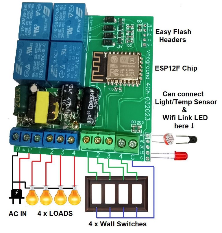

If you are looking for traditional switch, A youtuber built his own Tasmota based 4ch switch board project which he sells for 850rs,
4 Channel Wifi Smart Switch Module
- Tasmota pre-flashed
- Works directly on AC mains
- Supports Manual Wall Switches
- Easy Light or Temperature Sensor Connectivity.
- Easy Wifi Status LED Connectivity
- Onboard ESP12F Module
- Re-flashable using onboard Flash Headers
- Works with Home Assistant / Standalone
- Can handle upto 10A load per Channel

I have bought 2CH model from him, it is now transit. BTW the prices have changed, 2CH costed me around 920 including shipping cost.
It will come as bare module, no covers included.
let us know how it goes, you can add Bell Switches and enable push option is tasmota console (set Swtichmode to 3,) which will enable Bell Switch option
The device was shipped via Indian post which took some time for delivery and got it two days back. it was wrapped in soft thermocol material, packaging was good. The box came with instructions mentioned on single page along with one jumper wire to active WiFi.
I didn't want to take any chance so spoke with Harvinder (Seller) and he was kind to answer all my queries. I had connected device to power supply & It took 2 mins to connect with Tasmota Dashboard and then added to HA via MQTT. Now waiting for an electrician to fit it into wall switch. I will update the status once it is placed inside wall switch.
Installed board inside wall switch two days back and it is working fine. We faced some challenges during installation but harvinder was very helpful and have guided us during troubleshooting.
I would never trust that device, nor would I install a 10A relay without a casing inside the electrical box, the chances of the solder at the back piercing through the coating of the other electrical wires is too high and when that happens it's going to blow things inside your house.
As everything IOT races to the bottom, that looks like a steep price considering the components.
A 2 channel module from Tinxy is 850 on Amazon: https://www.amazon.in/Tinxy-Smart-Switch-Compatible-Google/dp/B08QF5WVN2/
And there's information on how to flash Tasmota/ESPHome on their forums: https://forum.tinxy.in/t/flashing-c...sphome-and-then-restoring-back-to-original/32
But for this kind of implementation, I'd just go with a 200ml food container (Rs 50), a Node MCU (Rs 200), a two channel relay module (Rs 75) and a USB charger (free or Rs 150). You could just use heatshrink tubing on the exposed circuit boards and skip the food container.
