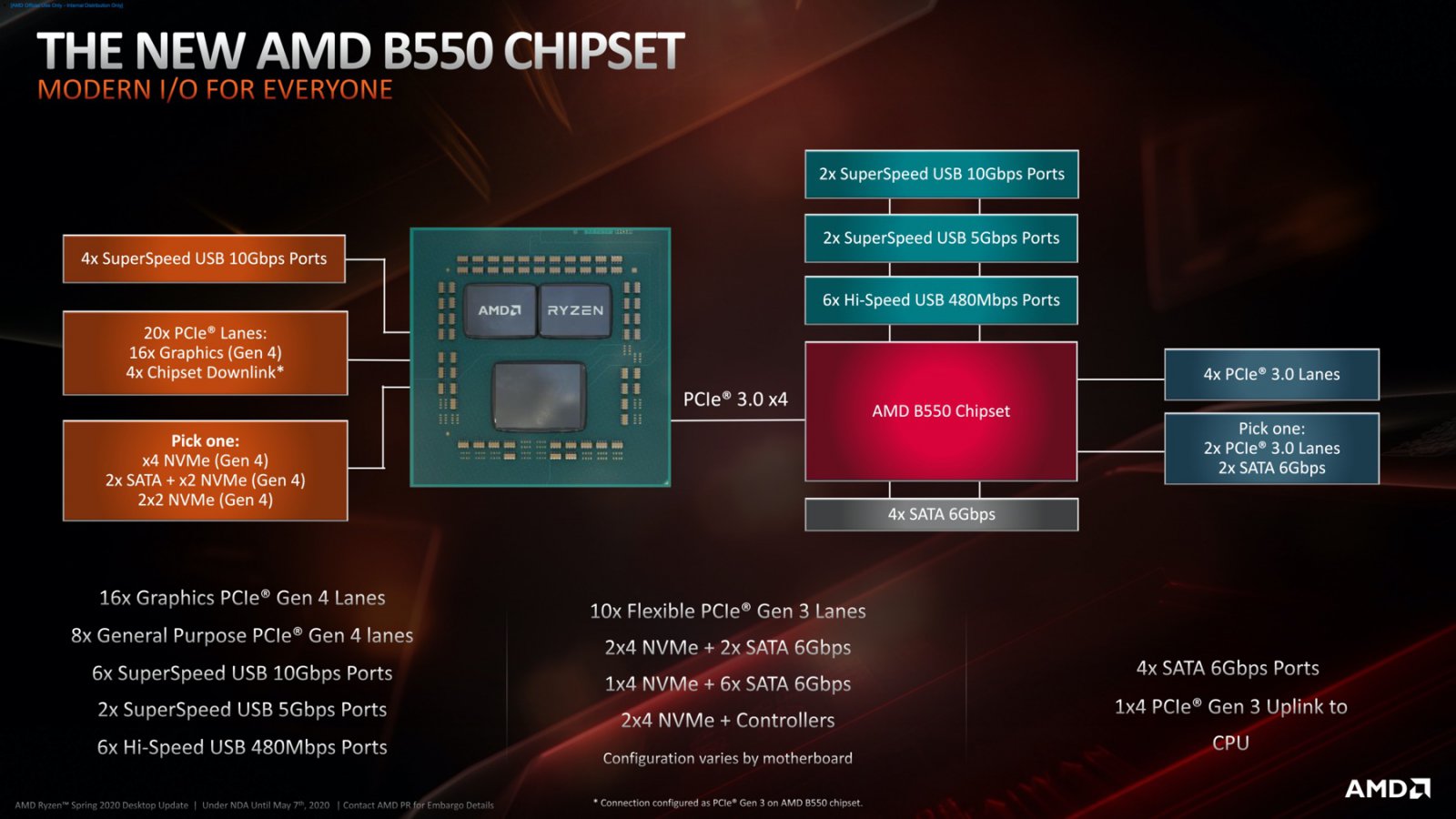

i have one doubt, that is there are 3 flavours of MOBO in Ryzen 3 that is 520, 550 and 570, it is understandable that x570 is the advanced of the lot and it is perfectly PURE GEN 4 between CPU and CHIPSET and other connections within the board, 520 is purely GEN3, SOO, when u come to 550 it is a combo of gen 4 and GEN 3, the communication between CPU -> NVMe is gen 4 and CPU->PCIe 1st slot is GEN 4, is it true??? but the connection between CPU-> and other chipset features are Gen 3, I am unable to fathom how come the CPU will communicate in both GEN 4 and GEN 3, OR Is it a marketing hype ??? or will u suggest people to go for still B550 boards ???
amd page says b550 has 20x pcie gen 4 and 10x gen 3 lanes. this means a motherboard can implement pcie16x for graphics card and 4x for nvme in pcie gen4. you have check that with exact motherboard model.
tks for your input! My question is even 550 offers primary gpu port and a nvme for pcie 4, if the cpu operates in gen 3 with other parts, is that still any good, it has a bottleneck in connecting to other peripherals. right!!!
To make it clear, is it possible if i use gen 4 compliant GPU and a NVME in the primary slots will a B550 imitate x570 when i dont have any other peripherals..
It's designed that way. PCIe is designed to be backwards compatible/switchable. You could even have your gen4 slots operate at gen1 speeds if you have older hardware, this is selectable in the bios.
The B550 chipset doesn't offer any gen4 lanes to any of the devices connected to it so there's no need for a gen4 downlink (unlike X570), so it's a gen3 link instead. The processor itself has a gen4 link meant for the chipset, and it is used as a gen4 link in X570, but for B550 that link is configured as a gen3 link:
Also as a point of interest, the Aorus B550 Master is the only AM4 motherboard that has three m.2 slots (4x gen4 each) connected to the processor, and in this mode the 1st pcie slot operates at 8x gen4. It's perfect for high speed storage oriented builds.
ok my point is if all the communication should either be in Gen 3 or GEN 4, even though the CPU has the design , i find that regardless of having 1 pcie GPU and 1 Nvme operating in GEN 4 will not perform the expected GEN 4 speed as the CPU bottlenecks with GEN 3 with other board components, it is still GEN 3 only!!! what gain will u have only part of the board performing in GEN 4 speed when the CPU is connected with GEN 3 SPEED with everyother component on board.
correct me if i am wrong!!
So it appears that your understanding of interconnects is incomplete. Mine isn't so great either but I'll try to explain.
Think of a processor as a headmaster of a school, and the various links to it as meetings he or she has scheduled for the day. The most important meeting would be with the board of education, and then maybe some faculty members, then perhaps some custodial staff and at the very bottom of importance is you, being suspended because you didn't tuck in your shirt. The headmaster is able to meet with all of these different people, and give each person the importance that is needed. With important matters like with the board of education, the meeting is serious and prolonged. With delinquent students, it's a few seconds of yelling and then sending them home with a reprimanding letter.
So the interconnects with the processor operate in an asynchronous manner. The processor's operating speed doesn't slow down to communicate with a gen3 device, it continues to operate at it's full speed while the gen3 devices send their data, and then works with that data after it has been transferred in full. This handling of different data speeds, from the high internal frequency of the processor to the lower frequency of the interconnect, is by a part of the processor called a buffer.
In computers particularly, the analogy for 'bottleneck' is incorrectly applied to a lot of things. For a bottleneck to occur, there needs to be a constriction of flow, between two unconstricted points. There's nothing faster than gen3 at the other end of the chipset, there's just sata ports and usb. If you had a GPU attached to pcie lanes coming from the chipset, then maybe you could say the gen3 link is bottlenecking the performance of the gpu. Or in some cases, an nvme ssd that is attached to the chipset.
And that flow, must be critical to a particular operation for a bottleneck to occur. So there's no bottleneck because there's nothing that's connected to the chipset that's important enough to slow down the processor or keep it waiting.
What other components are there? If you have storage and graphics connected directly to the processor with a gen4 link, that's everything you need to have a fast and responsive system that benefits from the gen4 upgrade. You wouldn't even need the chipset if you have your peripherals attached directly to the CPU's usb ports.
And as I mentioned above, there's nothing important that is connected through the chipset that it would suffer from being a gen3 link. The gen3 link to the chipset is 32GT/s which can be translated to 32Gbps for the purposes of this explanation. What device can we have on the chipset that operates at that speed? USB gen3 2x2 tops out at 20Gbp/s. How likely is it that you'll have two of those usb controllers, operating simultaneously, at full speed?
Actual real-world performance gains is a completely different topic. It's generally accepted that there isn't much use case for gen4 today for the average user. This has been true for the early days of every generation of PCIe, except maybe gen1. But introducing gen4 to the mainstream market now gives the technology and time to mature until it actually is needed. For power users though, it's really easy to saturate a 16x gen4 link with a few ssds installed in a pcie adapter card.
