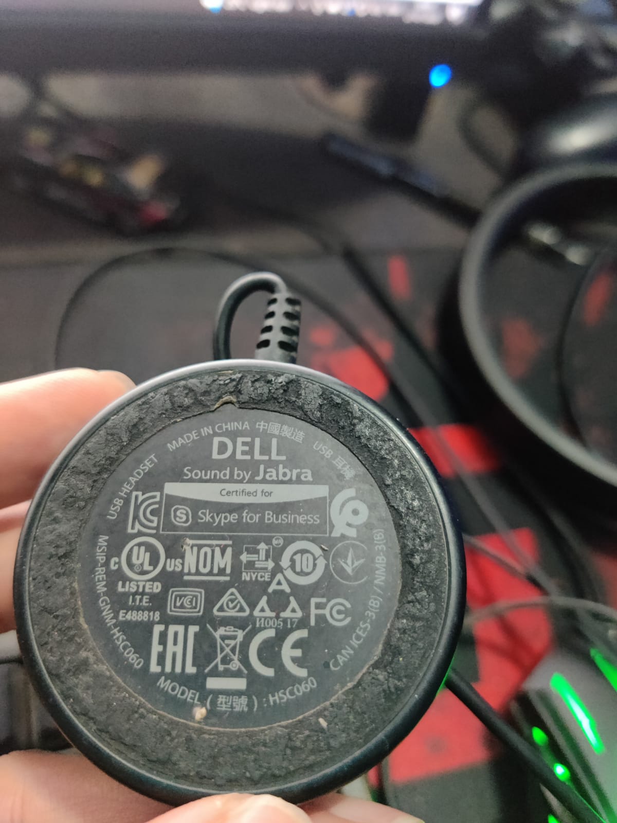

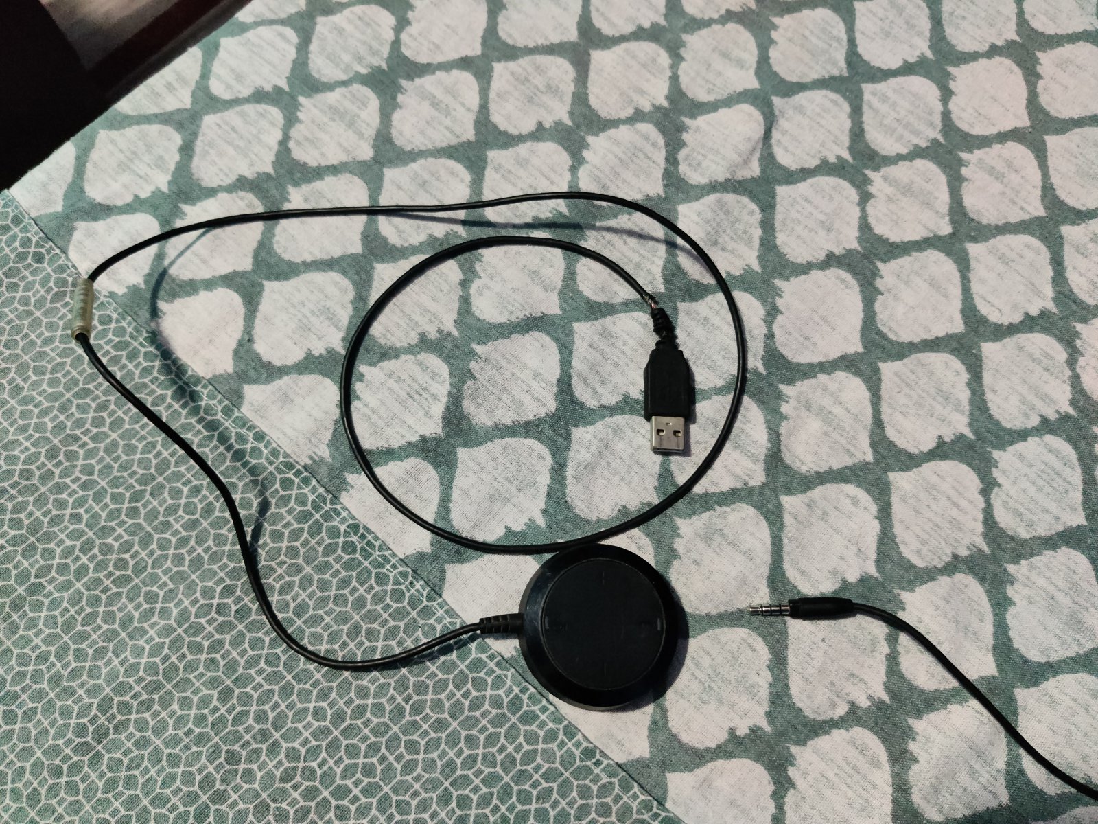

It's by Dell only. It says "sound by Jabra"

The model of connector is HSC060. The model of headphones it came bundled with is UC350 https://www.amazon.in/Dell-Pro-Ster...ro+stereo+headset+uc350&qid=1658860696&sr=8-3
Do you see the code HSC060?
It's a Dell rebrand of the Jabra Evolve 30

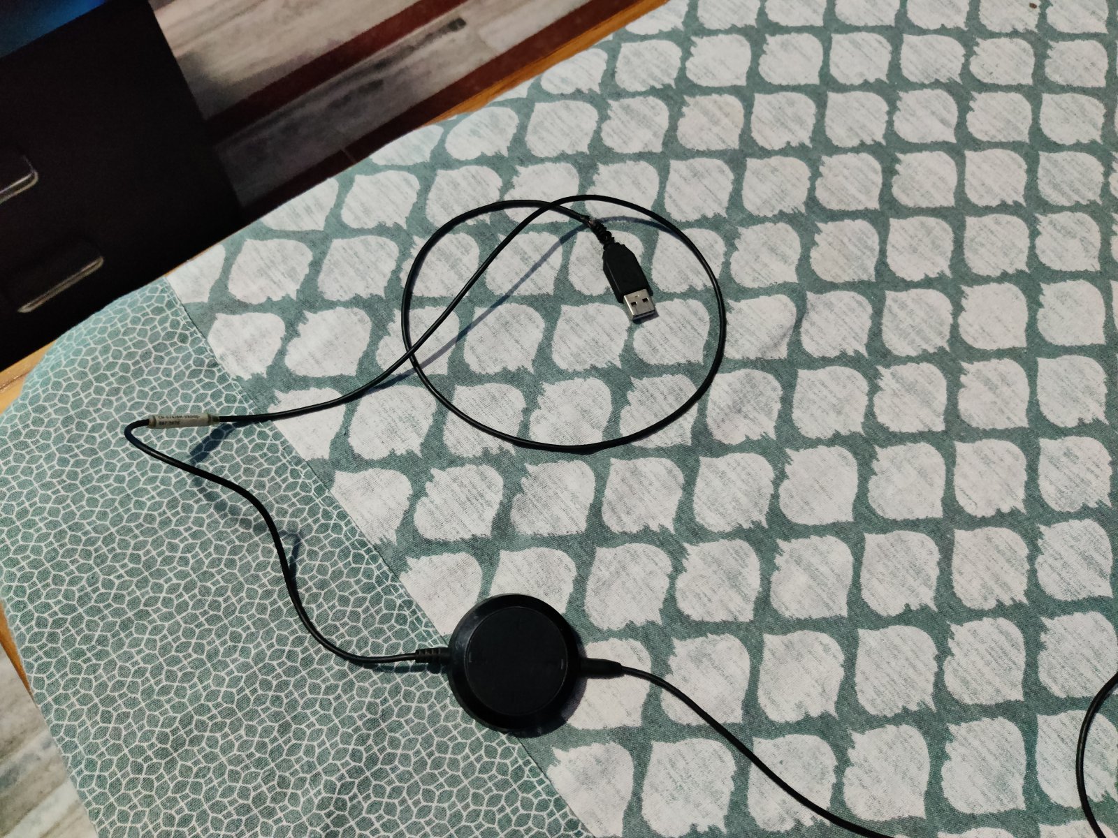

I have already mentioned with pics 3 those headphones (they are TRSS) and the cable puns recommended.
If any 2 of those work will do as in if boat one is omtp I'm least bothered I wont use it.
