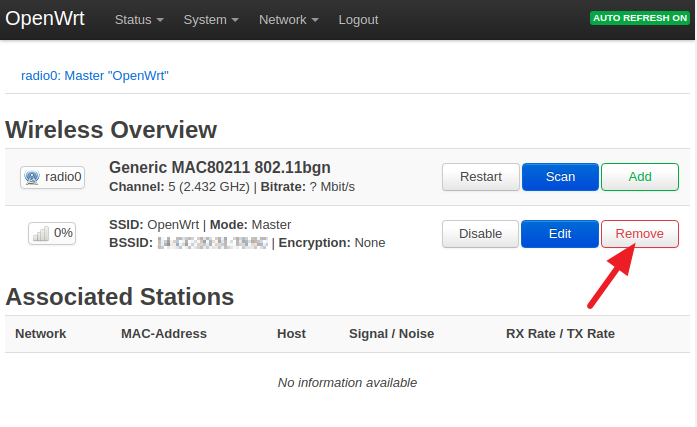

Flash your tp-link router with Open-wrt.
Then follow this guide:
After this you'll be able to connect your pc via Lan cable to your router.
Your tp-link router will be connected to jio router wirelessly for internet.
