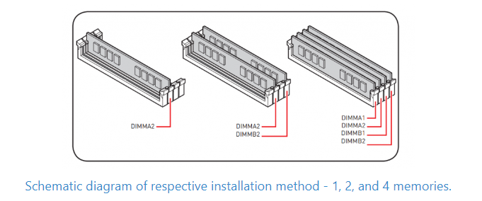

Just for confirming this base is covered - you were installing the 2 sticks in the recommended slot order right?
Yes, the 2nd and forth moving from CPU to the periphery of the board, as MSI suggests always. DIMMA2 + DIMMB2
