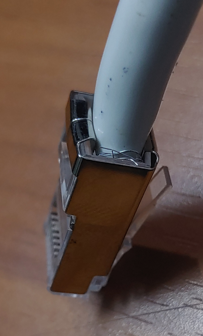

Fedus themselves sell shielded connectors. As a matter of fact, I use their shielded pass-through connectors.
These however do not come with a ground prong/tail, but it should still be possible to ground the shielding by wrapping around the outer cable shielding such that it comes in contact with the metal part of the connector (as I have tried to show below). This took a bit of effort and I would have preferred the prong - but just cannot seem to find pass-through connectors with the ground prong/tail anywhere.

Okay, thanks. I will try to crimp 1-2 without the passthrough connectors and see how it goes, otherwise will order these.

Hope you have better luck that I did. Found it frustrating without the pass-through connectors and gave up, and had them replaced with the pass-through connectors which I had originally ordered (but without the ground tail/prong).
