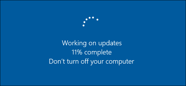

5. Here's the thing that update was downloaded like in first week of July. It always used to show me a notification to install it. But I kept on ignoring it and put the laptop in sleep mode. Now after the system froze and I restarted it, that update was gone. It didn't install as there was no sign of the installation windows. Now the update history shows me the last update which was installed in June. I cannot revert it back because it has been more than 10 days. The update page shows me a new update but I cannot download and install it as I cannot connect to the internet. Where are the downloaded update files stored? Can I install the last update which was downloaded and I delayed it, manually?
Reinstalling the Windows will be a mess as it is a work laptop. Please check this post https://techenclave.com/threads/wi-fi-doesnt-have-a-valid-ip-configuration-error.199647/post-2288535
I can understand the trouble in reinstalling windows on a work laptop.
Don't anticipate anything from past experience, there's no harm in trying auto created restore point after taking essential backup but consider it as last option.
This youtube video provided in the above link isn't' loading, but I can see winsock reset failed as mentioned in 2nd last line. access denied. you've run ip reset command as administrator ?
