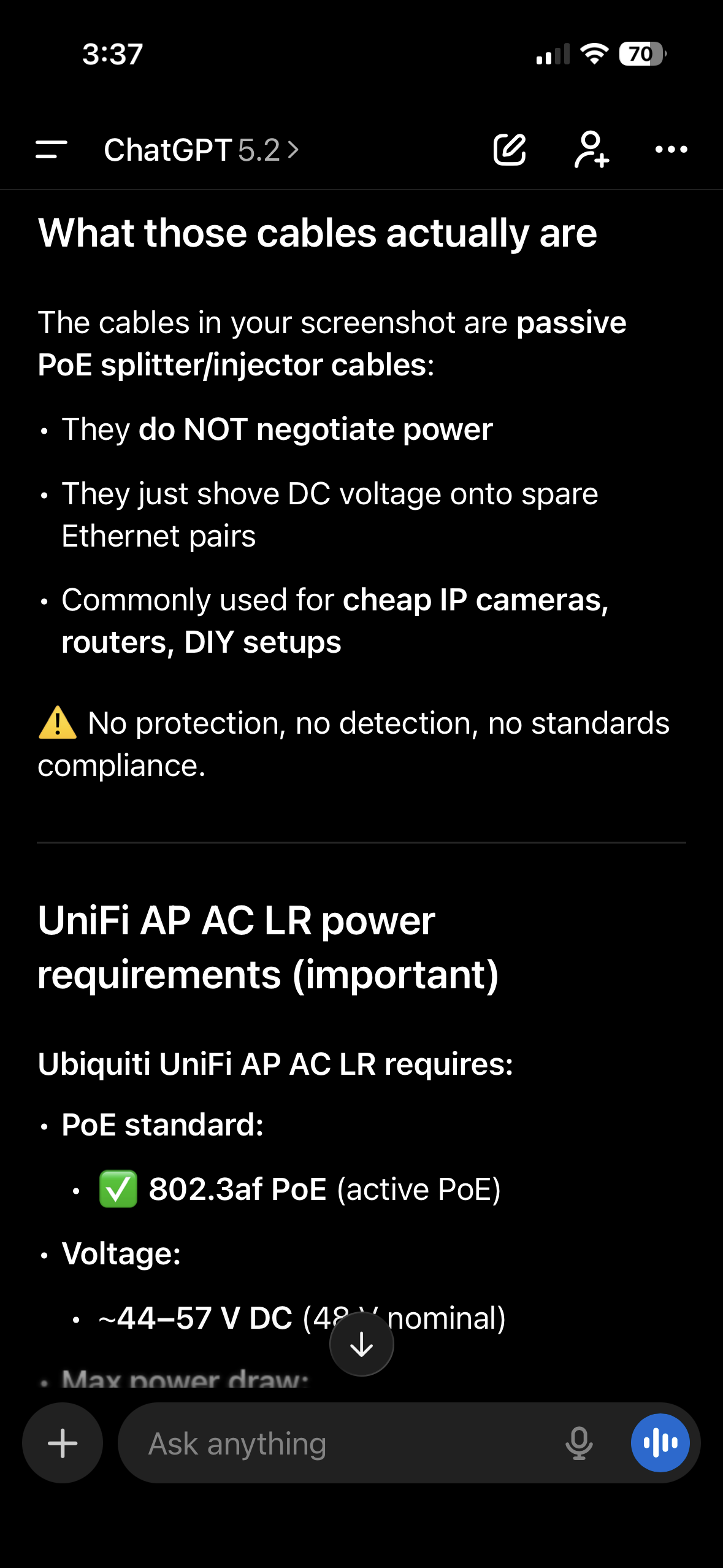

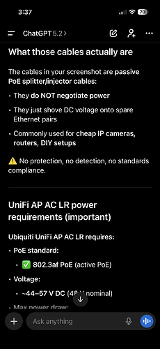

since i only need to power this one AP, can i not provide 12v supply from this one cable and use the other end of ethernet directly to the AP.
am asking this because buying a whole PoE switch for this one device would be too much, neither do i require one, and buying adapters for them which costs 1k+ is stupid imo.

This looks like the cheapest way to power one device:
You can take it apart, solder two wires, and power it with 5V but it’s kind of tricky. There are repair videos on YouTube that show you where to make the connections.

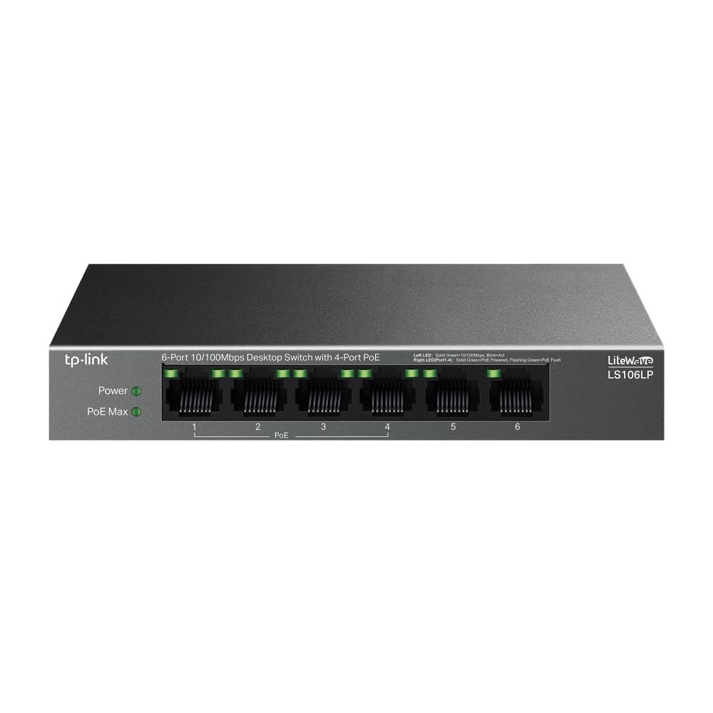

nvm brother, i think ill go with a switch, i found one cheap make in india one on amazon, has very good reviews, here
That’s a 100mbit switch with gigabit uplink. If you’re fine with that there’s cheaper TP-Link models as well.
But the signs are the pretty clear. The universe is calling upon you to set up a homelab. You’re destined for great things, and a gigabit poe switch will take you there.
My 2 cents , buy decent and good quality equipment as your device will run 24x7 on it. Don’t skimp on it. Also it’s a one time cost. I would not put my money on these kinds of switches . Buy from a reputable brand . The AC LR has specific power requirements, the cost at which these are being sold, not sure whats the quality of components used. Also as @rsaeon said at least have a gigabit POE switch. The device has been tested and shared by many can easily handle upto 300 Mbps + speeds. So by going for 100Mbps local switch you are already limiting your bandwidth.
Because the equipment you bought is at a cheaper rate , provide it quality power. At least buy a decent POE switch that is within your budget . Rest i leave upto you. In the longer run using non standard and low quality equipment leads to challenges and may affect the life span of the AP. So take a call keeping all those things in mind .

and i think you guys are right, better equipment would be nice, but my budget may not allow that. i opted for 100M because without me, a 100mbps connection is plenty for here, and thought would do just fine. but yeah maybe ill invest in tplink much rather.

This is probably the lowest you can go with at 2.2k for a decent quality 100mbit poe switch:
You can save 250 with this newer model, it has a lower total power budget which shouldn’t matter for a single AP:

for my home here, i think this basic 100M switch would do for now, ill upgrade down the line if its required.
