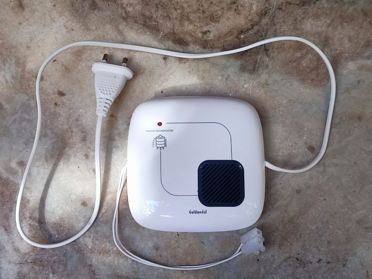

Serendipitously, I bought this a few days earlier just because it was a good price:
It’s a simple unit:

This one is a little smarter, it has a voice announcement as if you’re in a railway station and it announces just once, in Hindi and English and I assume it waits for the next overflow event before announcing again.
For both of these, you’ll need a length of wire to the overhead tank. Copper or tinned copper is unnecessary for this, aluminum service wire works just fine. I used 2.5mm sq because I couldn’t find anything thinner.
