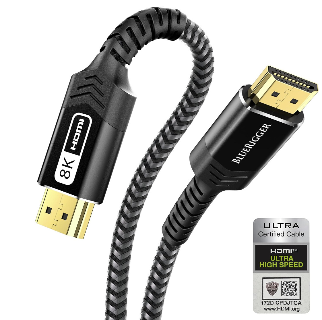

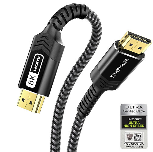

I got this - “BlueRigger Ultra Series 8K HDMI to HDMI” - few years back, decent quality, works well with 4k @ 120hz with 4:4:4 -
https://www.amazon.in/dp/B08GLW3NND?th=1
