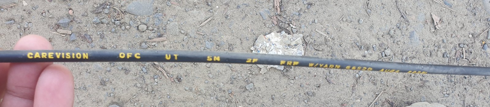

I went to talk to a local ISP. This is the cable being provided.
I’m not an expert but it’s different from the flat telephone-like one provided by Jio Fiber. This one is round.
I might need 950-1000m of it.
