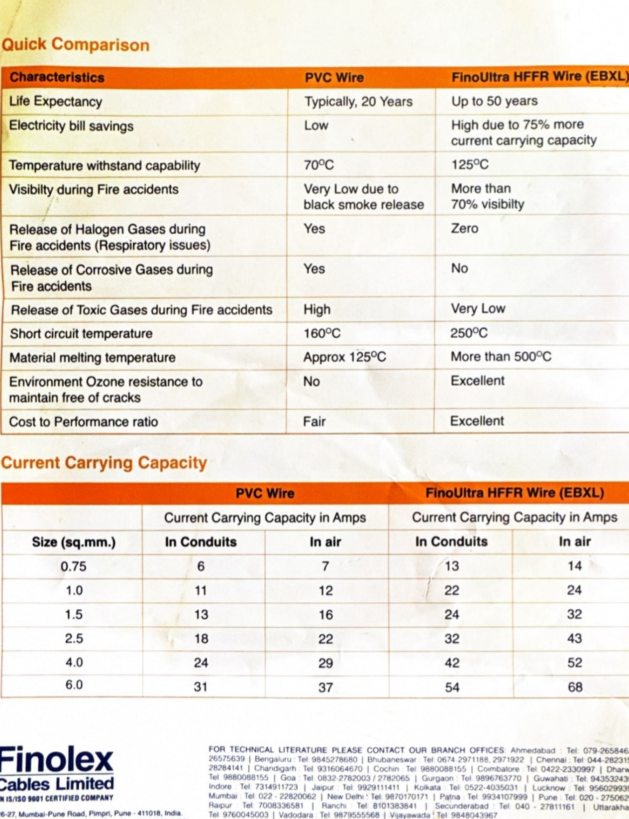

Hey, I’m looking at 4 qty AO smith 25L water heaters. Can a 3kw water heater run on 2.5mm thick wire? Or will it need 4mm wire?
Technically 3.5kw (assuming starting load to be higher than rated load), is 15.9A.
So it shud run. But unaware of wiring at your place il recommend to stick to a good 2kw geyser like Ao smith full abs square body geyser
@sato1986 Thanks for the reply. I’ve 2kw 15l racold geyser and am not satisfied with the shower experience (hot water runs out before the last part of shower).
I’ve used Polycab and Finolex PVC FR grade (nor FRLSH) for wiring. The wire run is 25 meters and has a dedicated MCB.
I think a 25l geyser can fix the shower experience and 3kw will reduce the waiting time for water to heat up. My electrician says that 3kw geyser should work fine with the current wiring, but I’m trying to get a second opinion.
I’m looking at this particular model. Amazon.in
3000w/250v = 12A + adding 25% buffer = 15A. My wires are in conduit, not sure how much to factor for efficiency loss for 25m conduit wire run.
