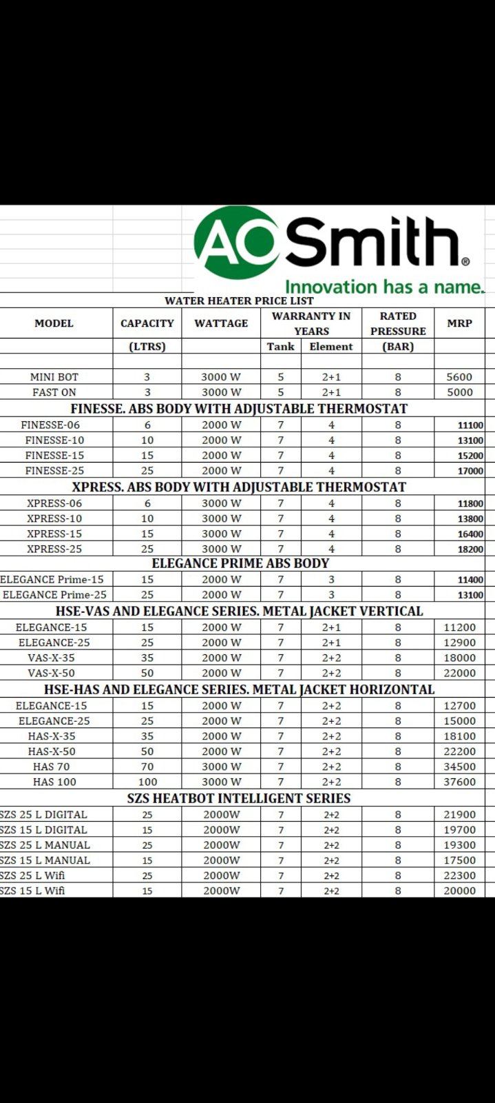

Overall having experience of alot of customer feedback in 20+yrs, i shall strongly recommend AO Smith Xpress 25litre with 3kw heating element. It heats fast and water stays warm.
This is recommended upto a shower head of 4 inches.
Incase you plan to use 6inch or more shower head then go for 35litre geysers from AO Smith.
Their PUF insulation and blue diamond glass lining across all models (6L-100L) is much superior than racold or havells.
And i can guide you on right pricing in your area as well.
Ps: Buying offline is better if you get an authorised dealer and good deal.

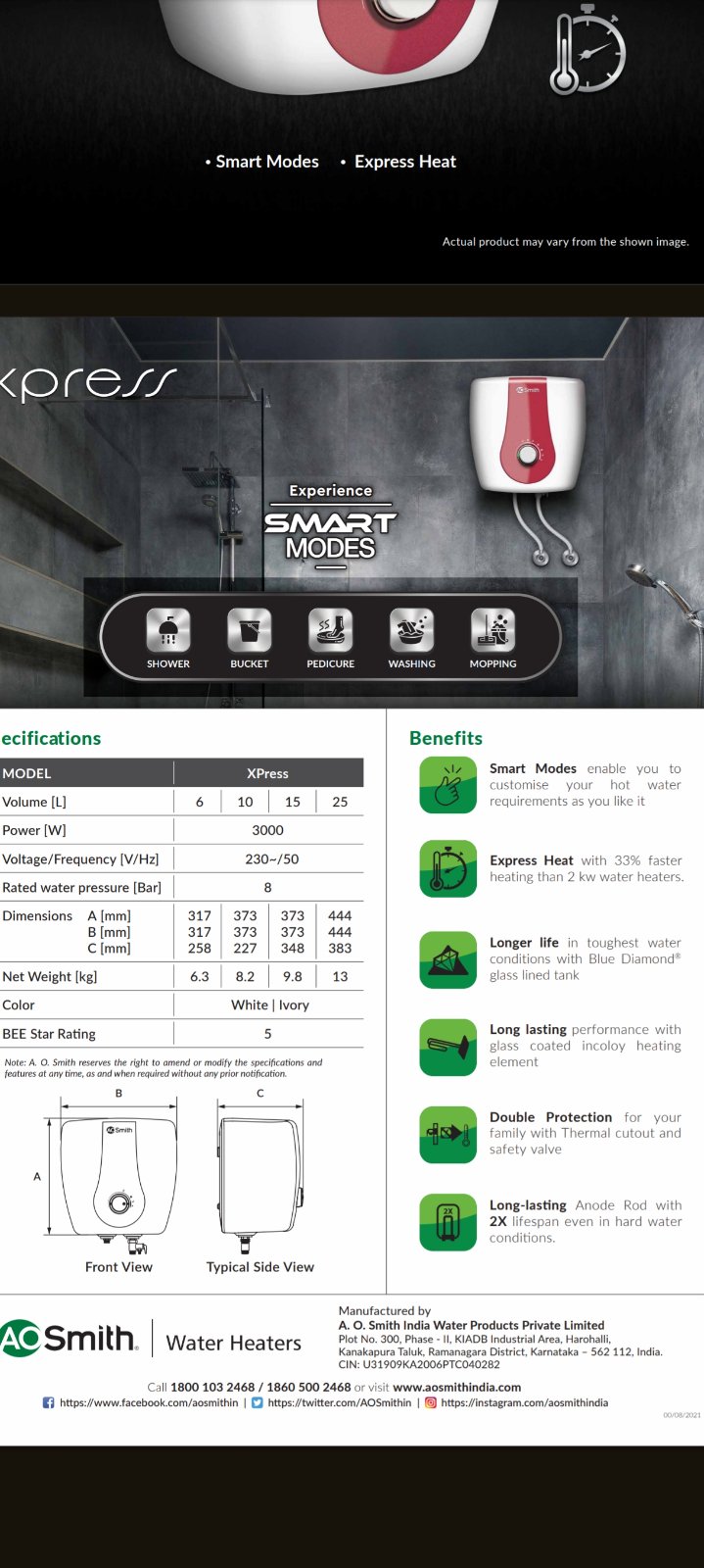

I can’t share our dealer pricing here openly, but attaching an important spec sheet for you to understand.
Note the 3000w are fast heating. And priced lower than 2000w wifi models. Even warranties are stronger on Xpress models.
Recommended:
Premium model: Ao smith xpress 25L 3kw
Basic model: Ao smith Elegance prime 25L 2kw

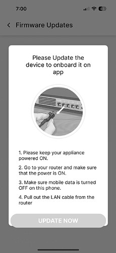

Update (in short): Stay away from Havells as a brand all together. This will be the last thing from this brand in my house.
So I went and bought Havells Adonia I back in December and have used it now for more than 3 months. Sharing some usage experience here.

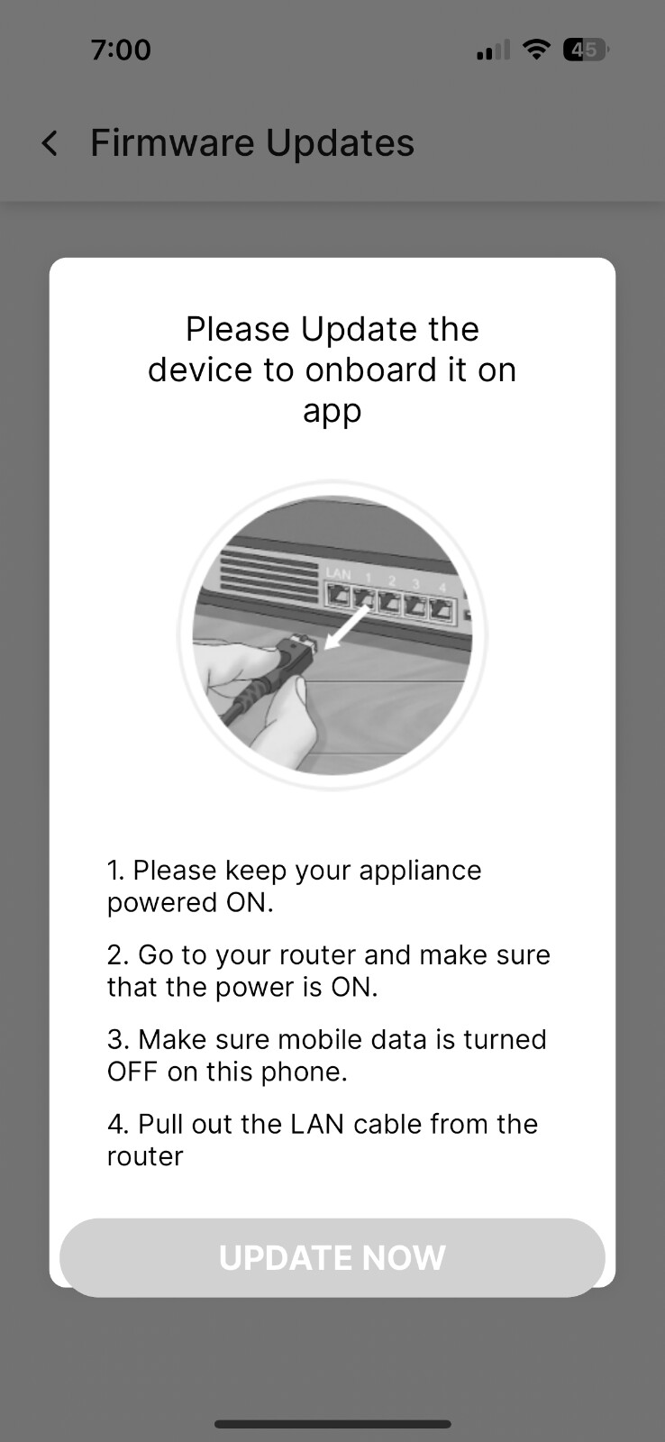

**App Integration (WiiFi Network) - 1.5 out of 5 **
I used Havells One app for this and to my surprise I couldn’t onboard the geyser through it for at least a month. This is a common problem that was shared by other users on Amazon as well. The device required a firmware upgrade at its level which showed an error which blocking the onboarding process. This was resolved by 1 fine day out of a sheer luck.
**Appliance Usage - 2.5 out of 5 **
Once it was onboarded I was able to set weekly and daily schedules and they worked flawlessly with the app only till the day it worked fine. It developed an issue where its internal MCB tripped and it’s been like this for last 15 days.

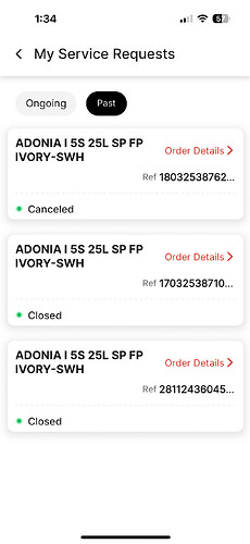

**Service - 1 out of 5 **
Staring from the installation experience it’s well below average to say the least. After raising the request the service guys cancel them on their will. This came as a surprise to me, sharing some screenshots.

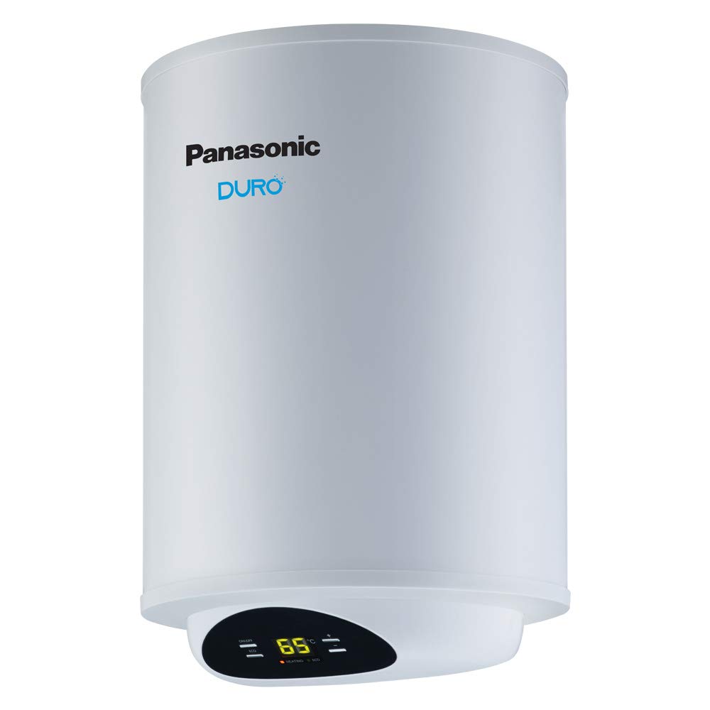

I’ve been using a Panasonic Duro 20L since 2020 and it has been running reliably untouched since then. We have very poor water quality in my city. The water quality is hard with high TDS and some salt/calcium contaminants. Still ZERO maintenance. This unit also has the glass coating mentioned above. I chose Panasonic because I’ve had nothing but positive experiences with the brand. Every Panasonic item in our home has been running reliably for several years without any service intervention.
This unit doesn’t have the IOT features requested, but the digital temperature console remembers the last used setting and has an ā€˜Eco’ mode that caps the temperature at 55°c. The maximum temperature possible on this unit is 65°c. I would say 45°c is the most comfortable temperature, with 55° for those who prefer very hot water and 65° for scalding hot.
