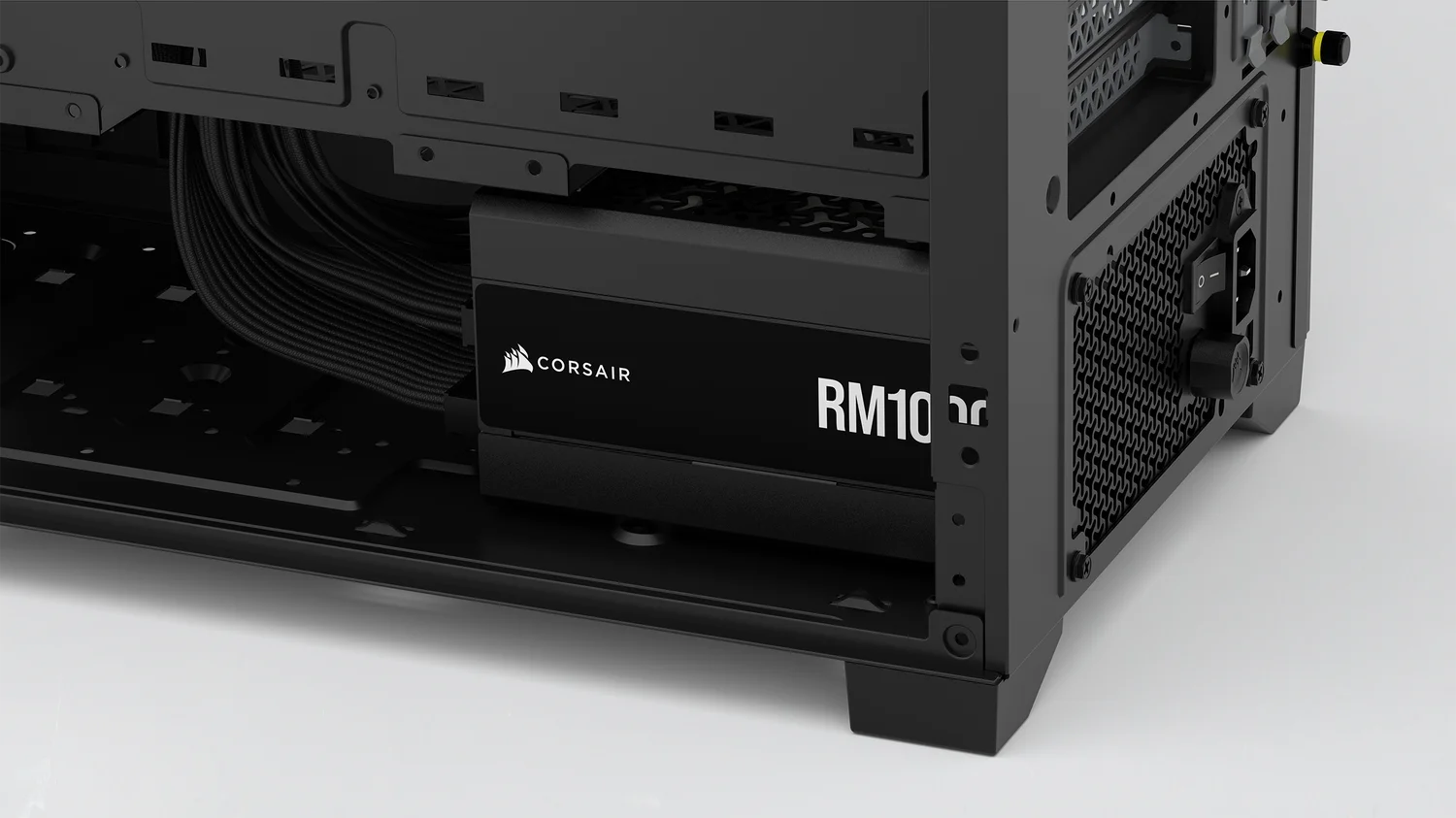

Bro then 450 is not enough, because at 100% load, a psu is only 80-90% efficient, most likely u have a bronze rated psu,which is closer to 80% in efficiency.. Even the highest end psu cannot output 100% of its rated power. u need 550 atleast or 650 to be on the safer side, because other components also draw power, your cpu will consume about 60-70w, plus other components also draw some power.. Even if I go according to these values, you need a minimum of 550w psu, which I would not recommend at all, 550 would be like borderline meeting your power requirements, go for atleast 650 to be on the safer side or more if u plan to upgrade in the future.
It’s not
Have a look here
Corsair themselves recommend going atleast 550 for both 3060 and 4060.
You have to look at real-world scenarios, and not always a chart on a manufacturer’s website when it comes to PSUs.
Manufacturers will always inflate power requirements more than what’s actually needed for two reasons:
  1. For redundancy and a buffer
  2. To push sales for more expensive units
There are exceptions to this, but those are fewer in between
A good 450 will work, and this is only taking budget into key, for the best value right now.
Having a 600-700W unit down the line is something I recommend, as well. But the OP can do that down the road.
Also, I speak from experience.
I have run an i7 2700K + R9 290X on a 450W unit for years. Not that I recommend a setup like that, but it’s relative to how, at least for now, the OP’s 450 will suffice.
Again, it also depends on which 450 he has. If it’s something like Zebronics - nah, change immediately.
If he were buying new from scratch, I would recommend just getting a 550-650W unit, straight up. Why change if ain’t broke, for a setup like this?
