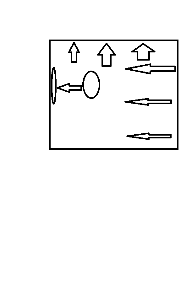

this is the basic diagram hot air has one rear exit and one top. the other 2 top fans will suck out the air that comes in from front fans.

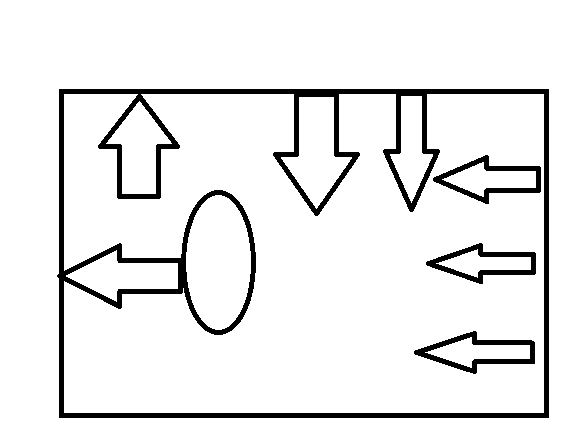

What i am thinking is top two in front as intake and last one as out.
The fans next to eachother (in and ex) might just end up recirculating / recycling most of the same air.

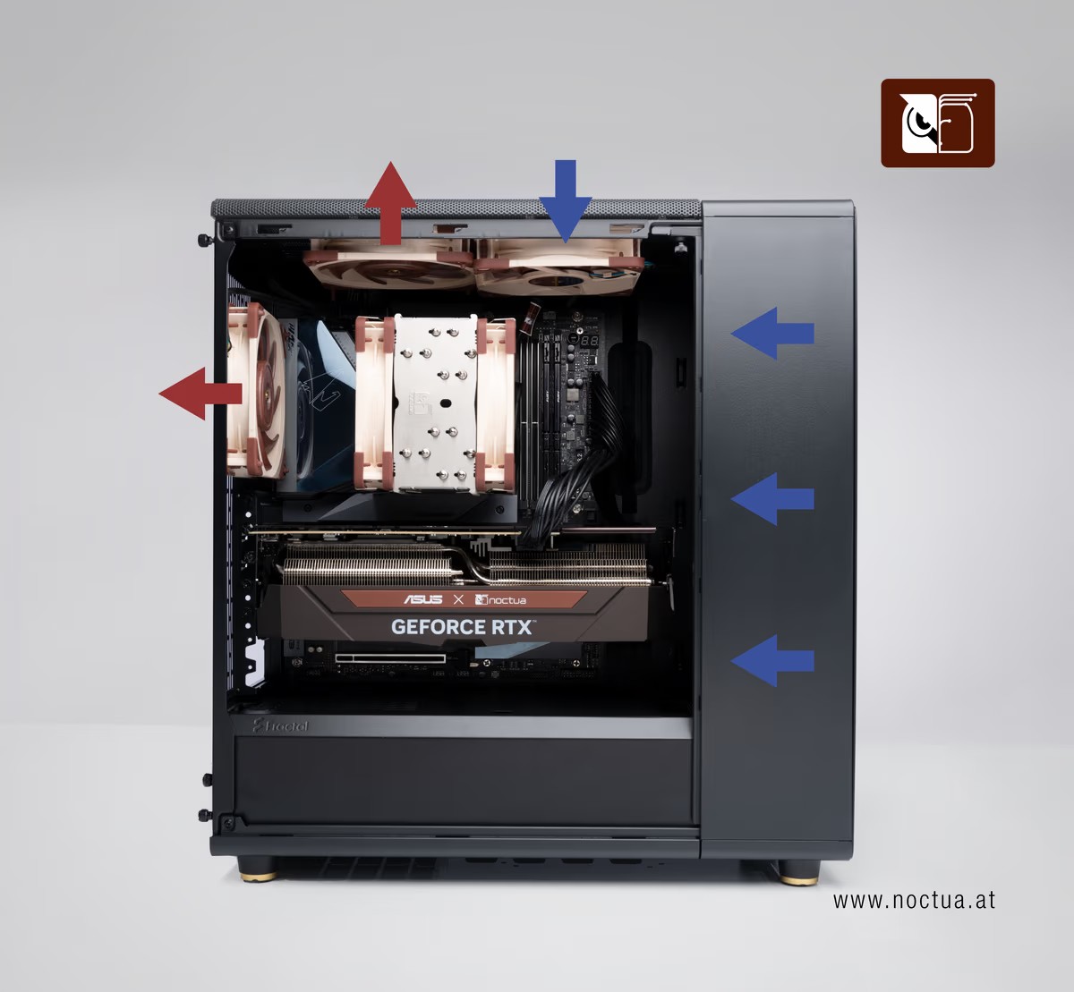

Suggestions by noctua:
https://www.noctua.at/en/support/faqs/airflow-guide-next-steps
You have a classic front to back air flow with say the tower cooler say at 75÷ rear.
Let’s call your fans 1,2,3 looking from front to back
My honest suggestion:
You do not 3 exhausts . Keep the rear most - fan3 - as exhaust. The 2x fans before - 1&2 as exhaust are merely messing up the flow . The intake from front fans never have a chance to move through majority of your case before being expelled by fan3 . In fact fans 1,2 are merely exhausting coldish air and may starve tower cooler.

I know noctua suggest an exhaust and intake side by side but I feel a loop of hot air . So if we omit fan 2 , you can still have fan 1 as intake and fan3 as exhaust .
Now this would change if you have a predominant bottom to top exhaust where want all 3 on top as exhaust , if you had a strong bottom or lower side intake
In case of no bottom intake and 3 top fan spots, I’d leave the top middle unoccupied, top front as intake and top back as exhaust with 3 or 2 front intakes and one rear exhaust.
