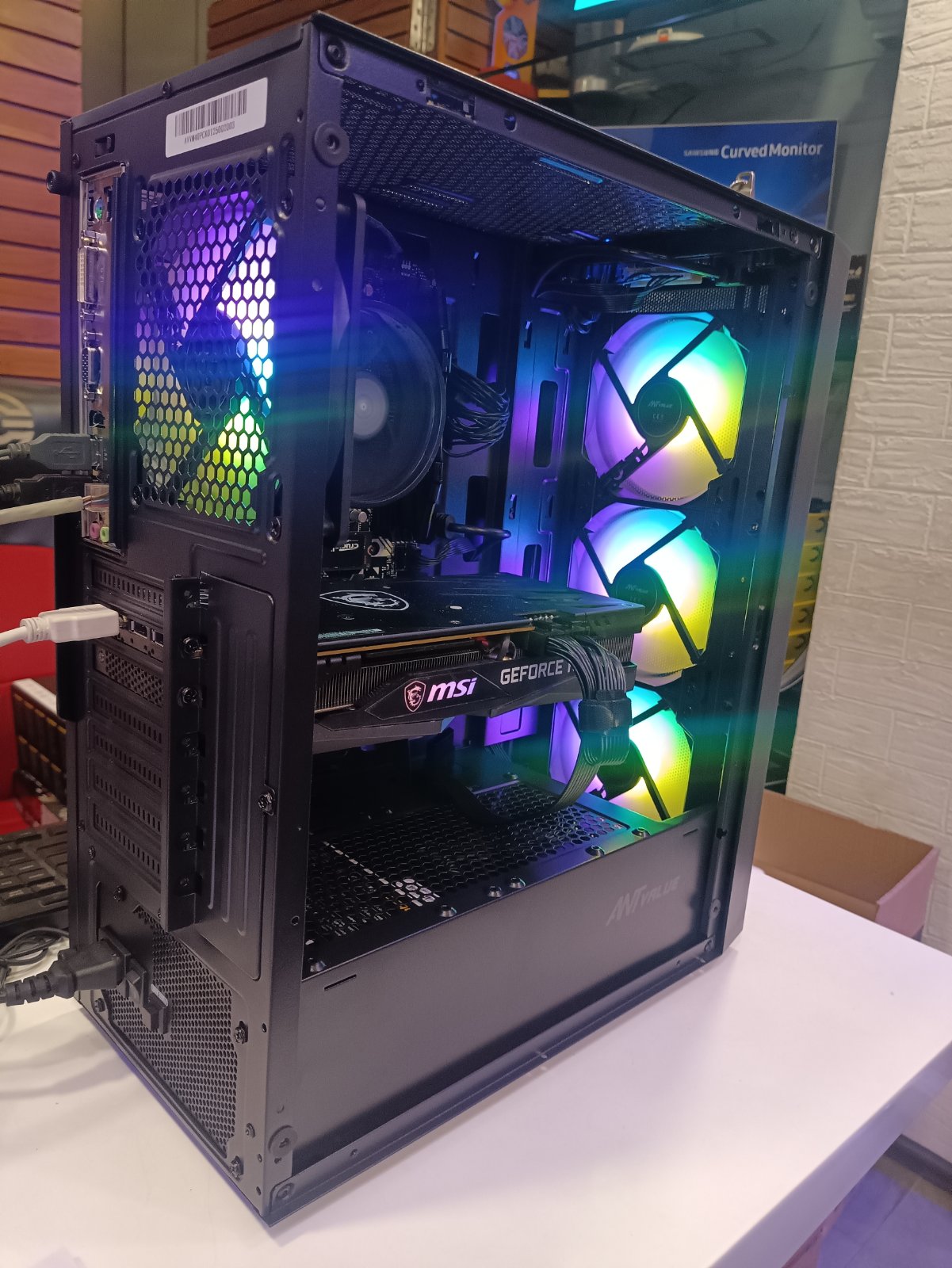

R5 3600 running at 60° idle and keep shutting down.
Approach Shop. Usually they would help if they have assembled it.

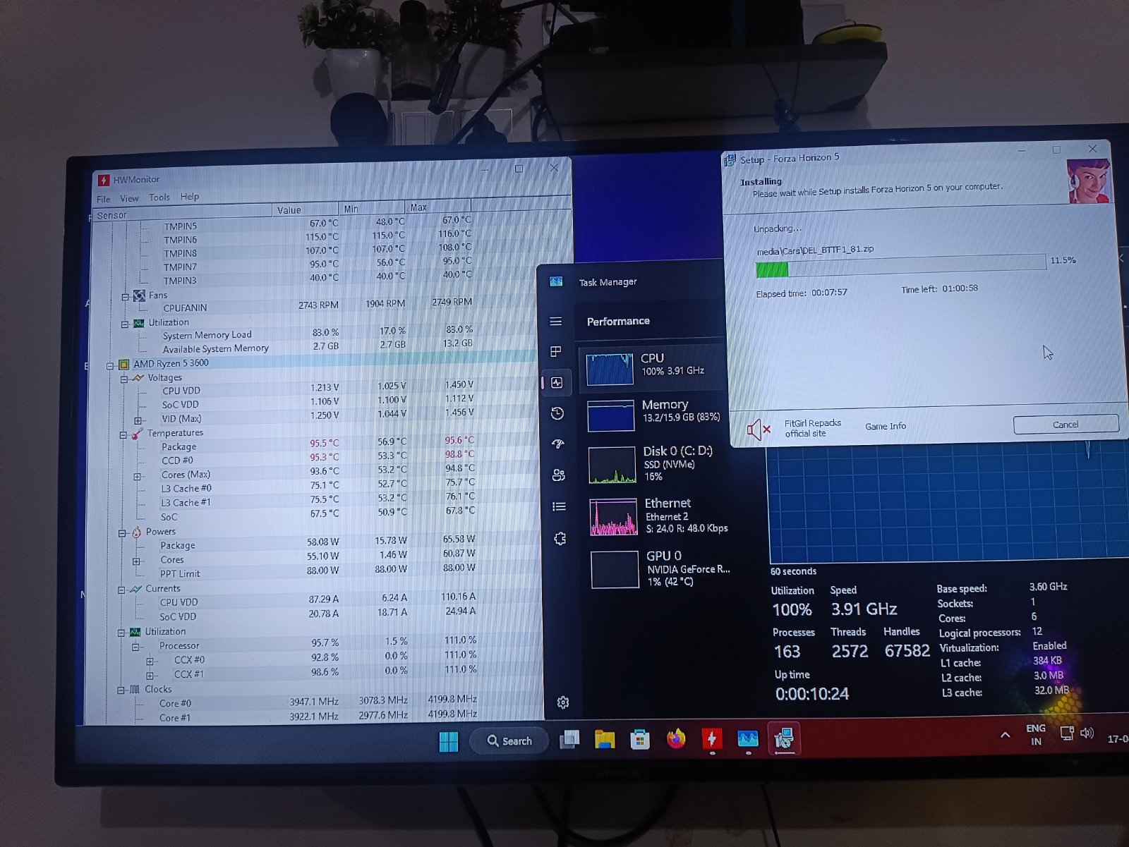

rn it’s been a hour with 100% load, not once it got shut down but temp are 90-95. I’ll see how it goes
Does seem to be working better now as I can see it’s boosting even at 95c (so it’s thermal throttling but not by much). You can further lower the max temp by going to bios and setting a max limit for PPT, perhaps 70W will be fine. This might affect performance but your PC will not thermal throttle as much. This is until you can get a better thermal paste and aftermarket cooler.
I have used really cheap white thermal grease for ages my idle temperature without ac is around 45-50.
Go to Power saving → processor, limit processor max to 80% for the duration of current firgirl task as per your screenshot, you are on the edge of thermal shutdown. After the task you set processor state to default. For longer term: get any cooler with two heatpipes and noctua h1 or similar.

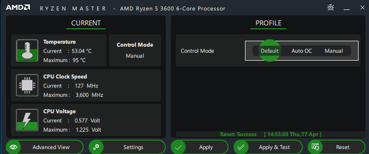

Here’s what i’ve done if anyone in future stumble upon this , Firstly cleaned and repasted the cpu so any mounting issue get fixed , then lowered the max cpu voltage from 1.35 to 1.25.
After these the cpu is idling at 53-55 , outside temp is 42C rn so ig its ok.
Let me know if i should still take it to shop (i dont prefer it).
There’s also some discrepancy between ryzen master temp and hwmonitor temp of around 4-5C. after some googling, it seems like ryzen master is more accurate.

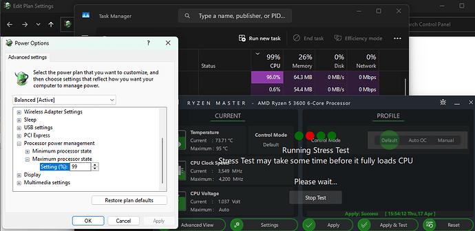

And can someone enlighten me why if i cap cpu power state to 99% then max temp go like 75C while with 100% cpu cap it goes 90C.
My guess is that it might be going beyond 1.3v and boosting
Edit* and bad thermal paste.
