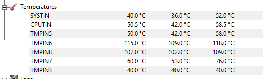

These are the mobo temps - Value/Min/Max respectively

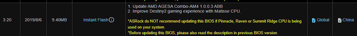

Are you running the latest BIOS? are you proficient in identifying the board revision number and flashing a latest copy from a USB drive? If your motherboard is [this ](’
ASRock > B450M-HDV R4.0
)one I can see that it had some compatibility issue with your specific CPU and a specific game(Destiny2) the information is pretty thin on this to apply in your case completely. But its worth a shot if you are able to flash a latest BIOS after confirming the board revision from bottom left and your specific bios.
