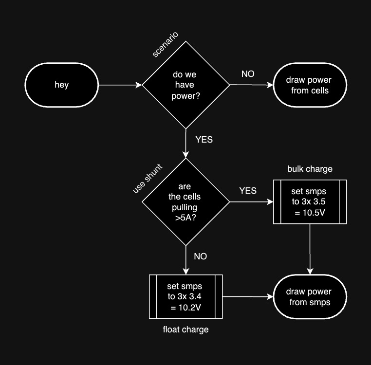

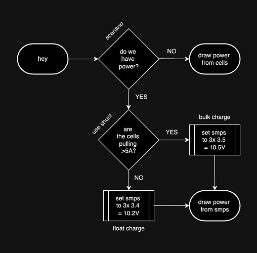

My first flow chart in over three decades:

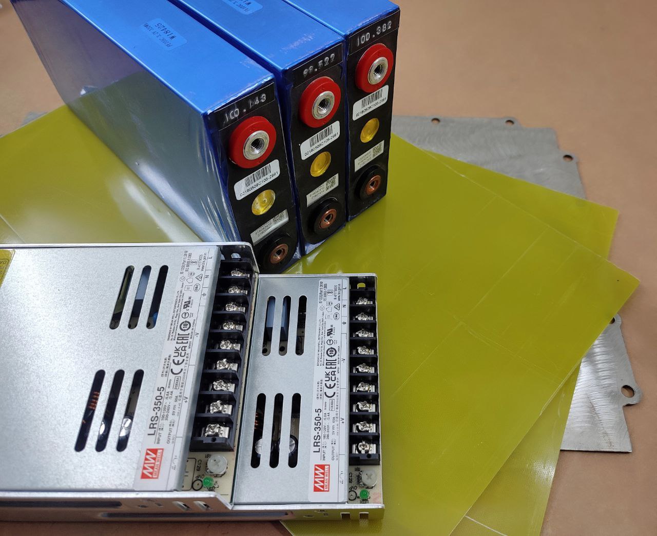

The cells will be encapsulated in 2mm G10 FR4 resin fiberglass sheets and 2mm stainless steel.
With a cell height of 36mm plus 2mm on each side for the fiberglass plus another 2mm for the stainless steel on both sides, the total height comes up to 44mm which is just shy of the 45-something-mm height of 1U.
The two SMPS will be connected in series, they’re 5V 60A each — so that’s going to limit maximum power draw by itself to 600W. I wouldn’t be loading more than 500W on this anyway so that leaves 100W left over for charging the cells after a power outage. Realistically, I don’t expect to have anything over 200W connected to this.

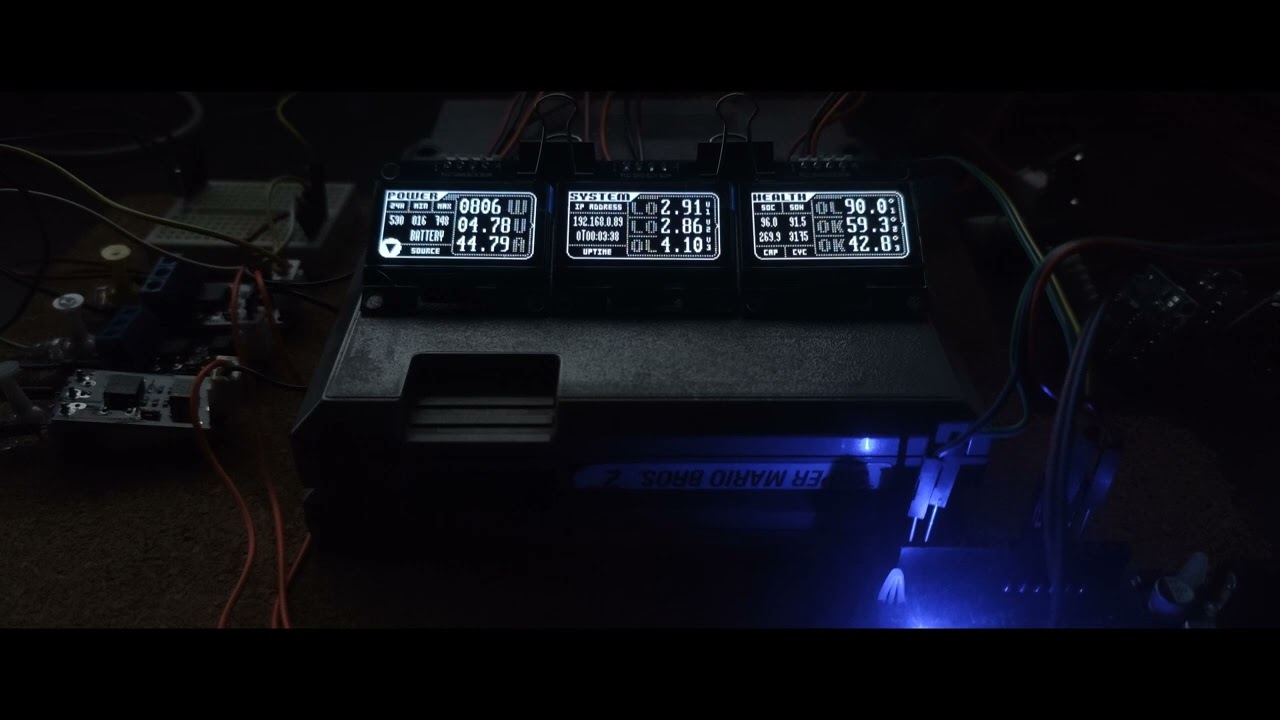

But coding doesn’t need any money! Inspired by UPIR and Volos Projects on youtube, I got my first OLED module and spent a day or three making a super cool futuristic UI for this rack mount battery!
SO. MUCH. AWESOME:

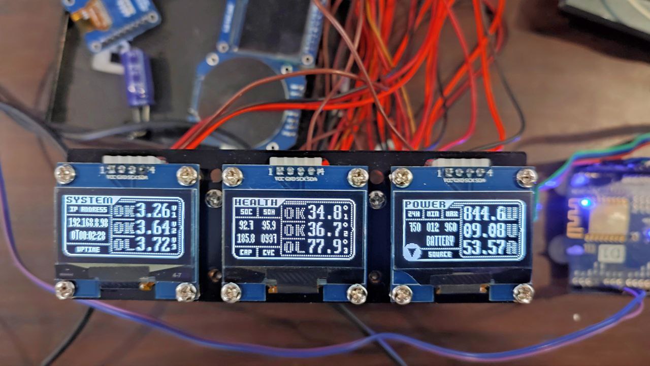

Update time! I got three screens working!
So far I’ve got seven I2C devices connected to a single ESP8266, apart from the screen (three temperature sensors, four voltage sensors). From the video description:

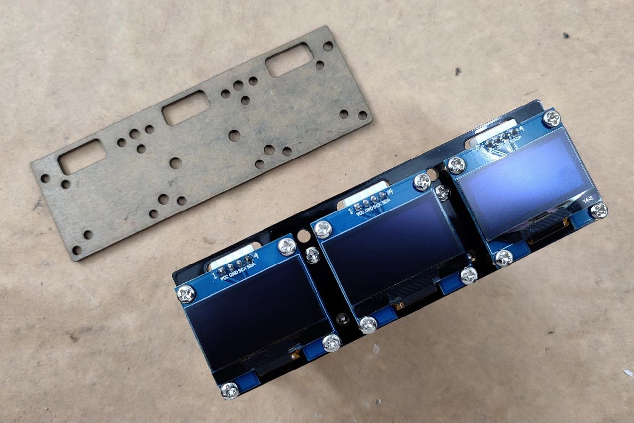

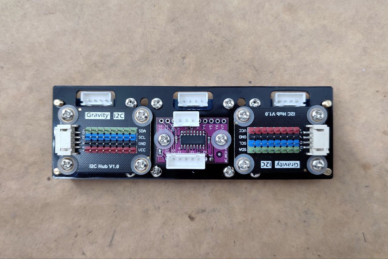

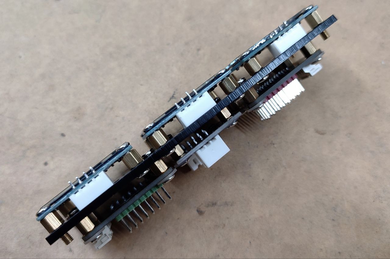

I designed a couple of panels and and got them laser cut in 3mm black acrylic to mount the various modules:
I used 5mm brass spacers here with M3 x 5mm screws, 6mm spacers would’ve been better because I wouldn’t have needed the nylon washers that you see:
These DFRobot I2C hubs help keeps wiring tidy and allows for a point to point connection with every pin on all of the modules I’m using without having to solder wires and/or splices.
All put together, It feels satisfyingly dense and expensive. Probably because of the brass.

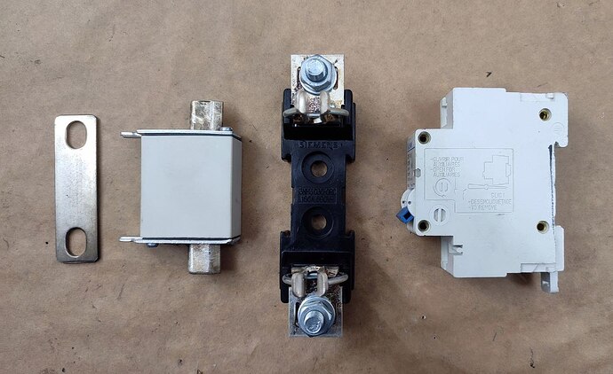

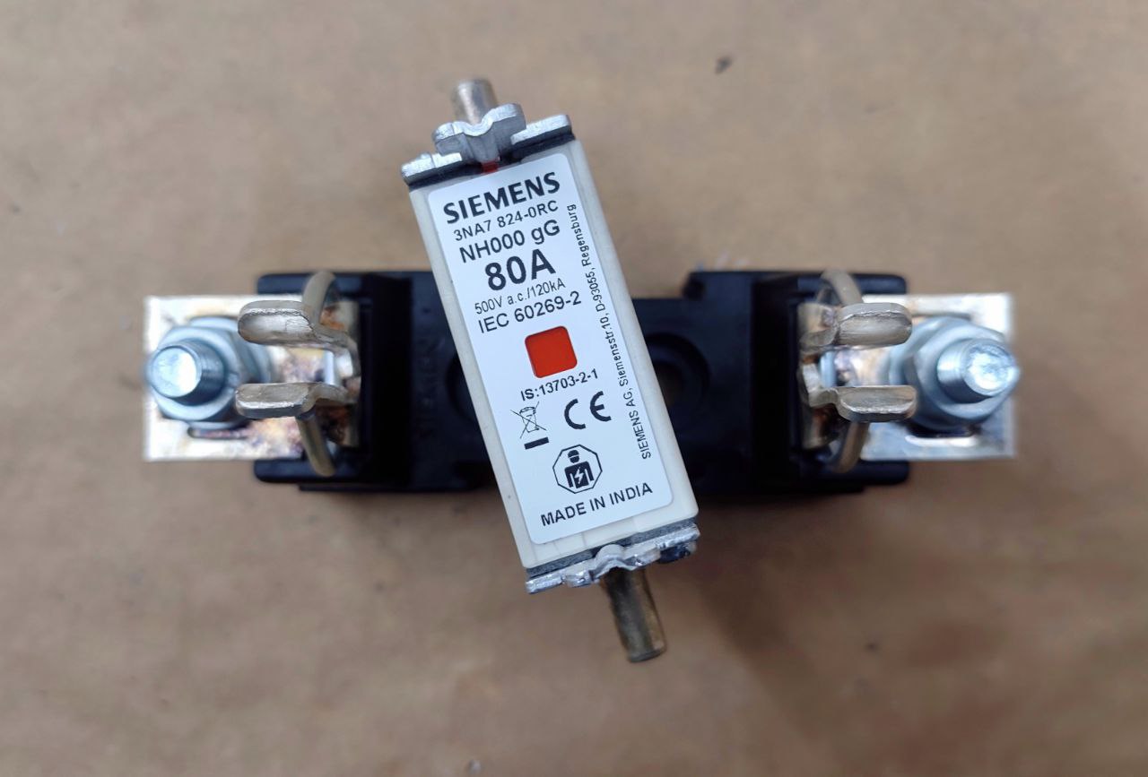

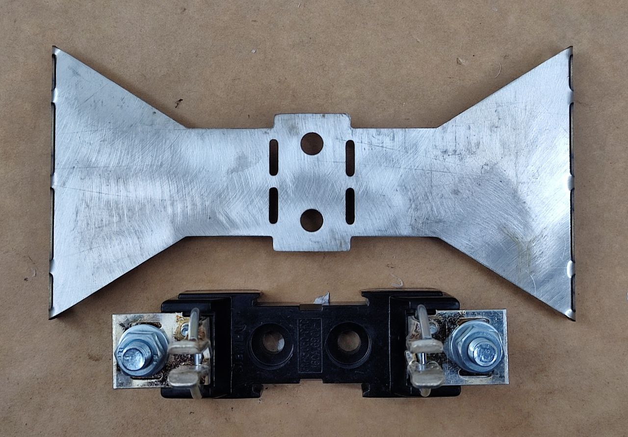

This NH 00/000 fuse holder is intimidating, but necessary (70mm bus bar for scale):
I’ll be using this 80A fuse (it’s rated for 250V DC):
I don’t plan on having loads more than 50A and the charger is rated for 60A so 80A sounds like it makes sense in case there’s a short/fault somewhere.

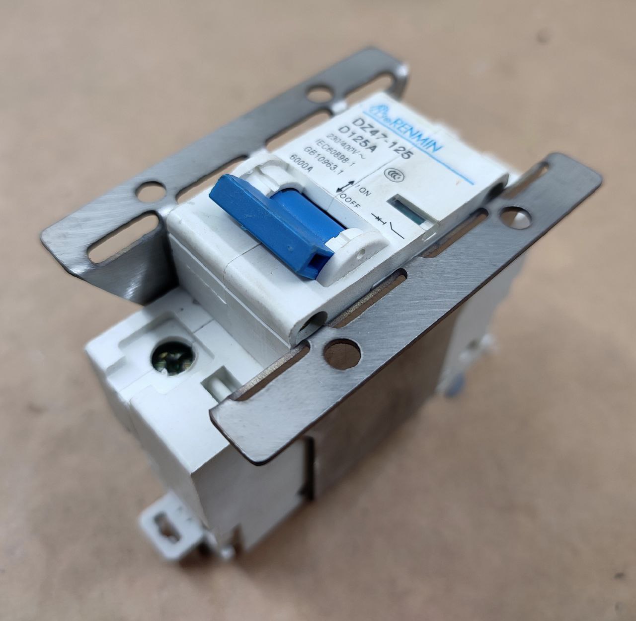

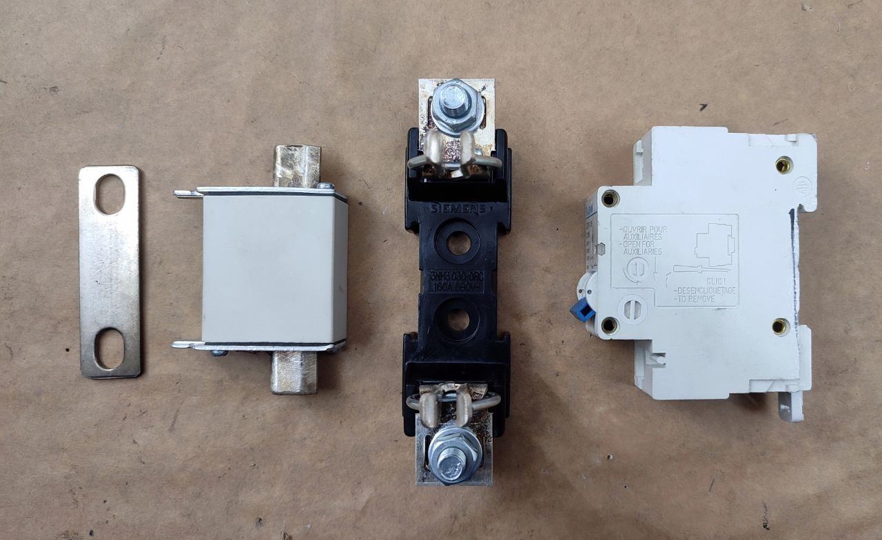

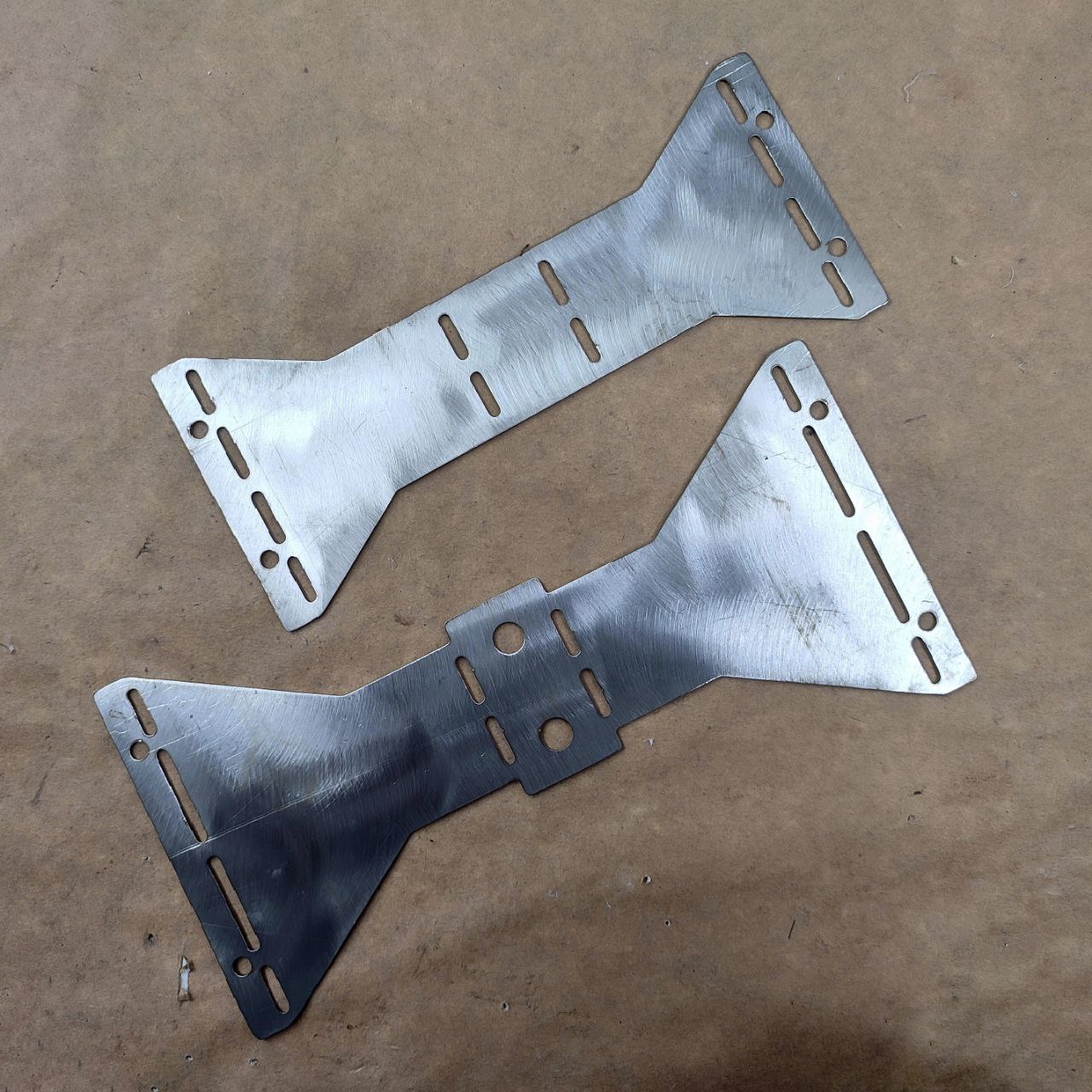

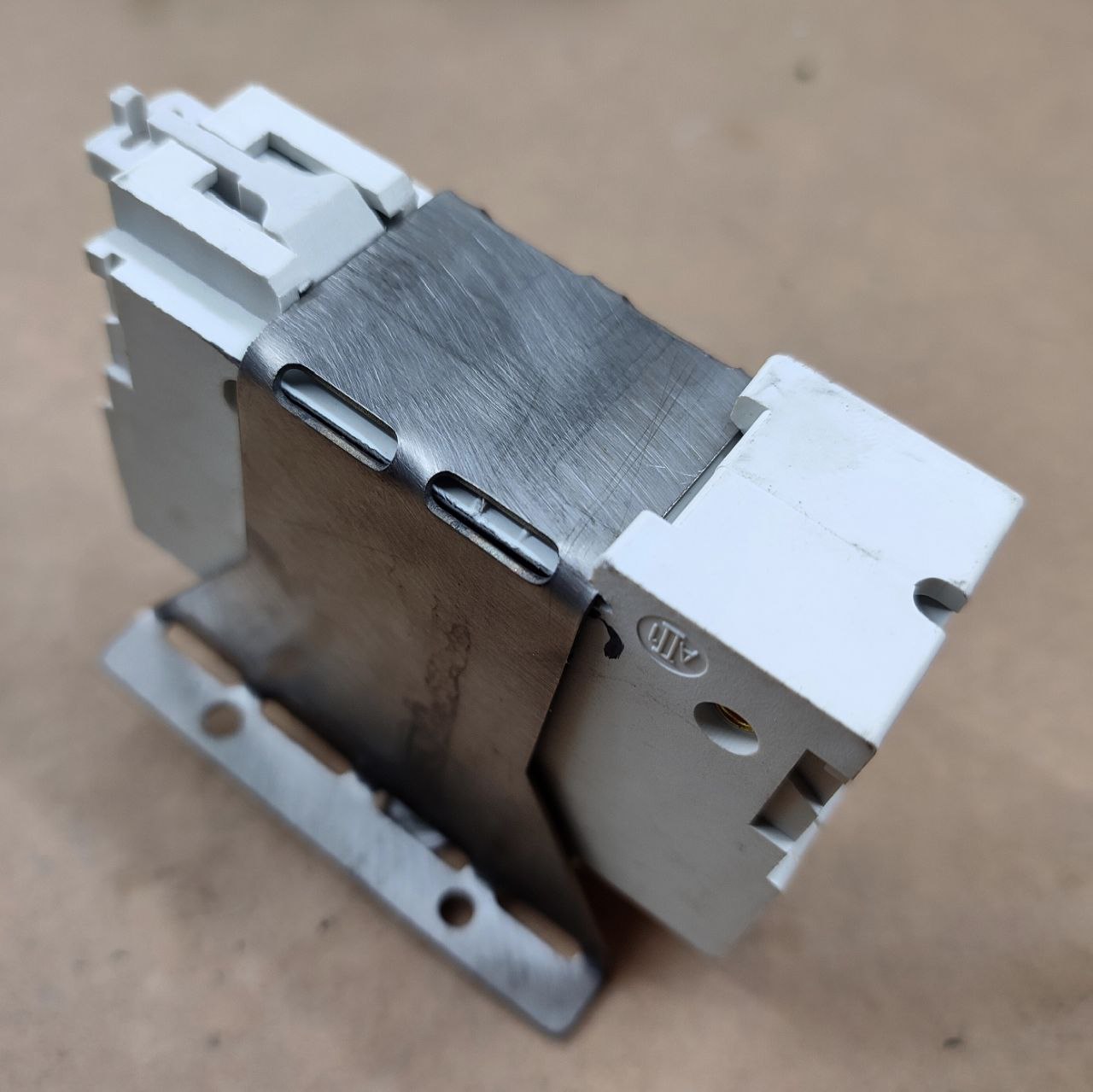

I needed to figure out a way to flush-mount this fuse holder and the 125A 22mm MCB to the 45mm 1U front panel. This looks like a good idea:
So I designed a couple of panels to be laser cut from 1mm stainless steel:
The cuts along the bend lines are to make bending easy, they’re 3mm wide.
A vise made bending the flanges easier:
This one is ready to be flush mounted:
This breaker can’t do any breaking, it’s just an isolator. So I’ll be using it as a power switch to disconnect the cells if and when the fuse needs replacing, hopefully it won’t ever.
This safety stuff is expensive, the fuse and holder were around 1k and these laser cut panels were about 600 together.
I’m re-using the isolator from the MuscleGrid battery, but they run for around Rs 700 each.
But I’m expecting a 10 year life out of this so it’s probably worth it.

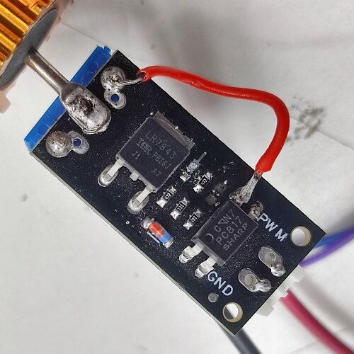

I found that one of the commonly available mosfet modules, the LR7843, is sometimes referred to as a ‘logic-level’ mosfet so it’ll run fine switching loads of around 3.3V and it has a low resistance so it wouldn’t heat up as much.
Except it comes with an opto-isolator on board, which has a voltage divider with a pair of resistors on the switching side, which prevents it from working as a 3.3V logic-level mosfet (but not at 5V).
A bodge/short is necessary, bypassing the top half of the resistor divider:
Since I didn’t know much about mosfets, the clearances between the three pins concerned me. They’re not spaced very far apart and these cells are capable of 525A discharge.
But when I started to think about it, if there’s a short between the middle pin and the ground pin, then that just forces current through the resistor. The worst that would happen is the resistor would heat up, and there’ll be a temperature sensor attached to it, so any short that would result in a thermal irregularity will sound an alarm/notification.
If the short is between the middle pin and positive, then that only bypasses the resistor so no harm is done there.
What would be dangerous is if all three pins would be shorted together, but at that point, the wires would overheat and melt way before any fire starts. Hopefully.
Anyway, these pins must be covered in some kind of insulation, maybe conformal coating. Later.

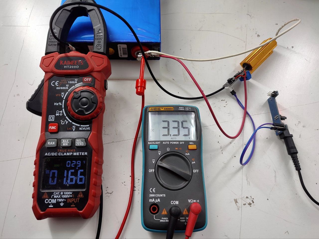

For now, here’s a proof-of-concept of the balancing in action:
1.66A running through the resistor when the cell is at 3.35V sounds about right for a 2-ohm resistor.
Afaik, logic-level refers to the gate voltage of the mosfet aka V_GS aka the middle pin being compatible with the 3.3/5V provided by an MCU’s output. That is, a logic-level mosfet can be driven directly by an MCU without having to use a mosfet driver. You might find that non-logic level mosfets still have a V_GS(threshold) value around 5V in the datasheet but the crucial difference is that they will only open partially at that voltage, which means their R_DS(On) will be too high, and therefore you’ll have higher losses. That’s why you need to look at the R_DS(On) for a specific V_GS voltage. In the case of the LR7843, the R_DS(On) is specified as 3.2 milliohms for 4.5 V_GS, which is good.
It doesn’t have anything to do with the loads connected through drain and source. That’s given by the V_DS rating, the drain to source voltage.
Thanks, it took many, many attempts trying to figure things out.
The first confusion is why the ground connection is called source and the positive connection is called drain? Seemed opposite of the way things were and tripped me up constantly when I tried to read the datasheet. Like a Vgs of 2.5V meant that the gate had to be 2.5V lower than the supply voltage? No, it has to be 2.5V higher than ground. It finally clicked when I thought of electron flow, which is from negative to positive, so from source to drain. Then things started making sense. I’m hoping I won’t forget this, ha.
The other confusion was that the mosfet in this module did not switch on when connected across the battery terminals, I thought that maybe 3.3V was not high enough. Then I thought it was the LED indicator, so I knocked that off. Then I noticed the resistor divider in the schematic which was essentially dropping the Vgs from 3.3V to half that, which barely allows the mosfet to “open up”. This also explained why it worked with a 5V supply but not at 3.3V in my early testing.
Once I bypassed that top resistor, Vgs became the cell voltage (through the transistor in the optocoupler), which ended up working fine as seen above. Hopefully there’s no longterm issues with Vgs being equal to Vds.
Overall, mosfets are still a little bit mysterious and strange but I’m really happy that balancing is work as it should. In a way, knowing that mosfet-controlled balancing was used by every other BMS gave me the reassurance that it’ll work in the end and I just needed to figure out how.

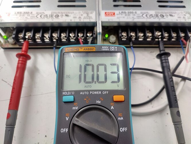

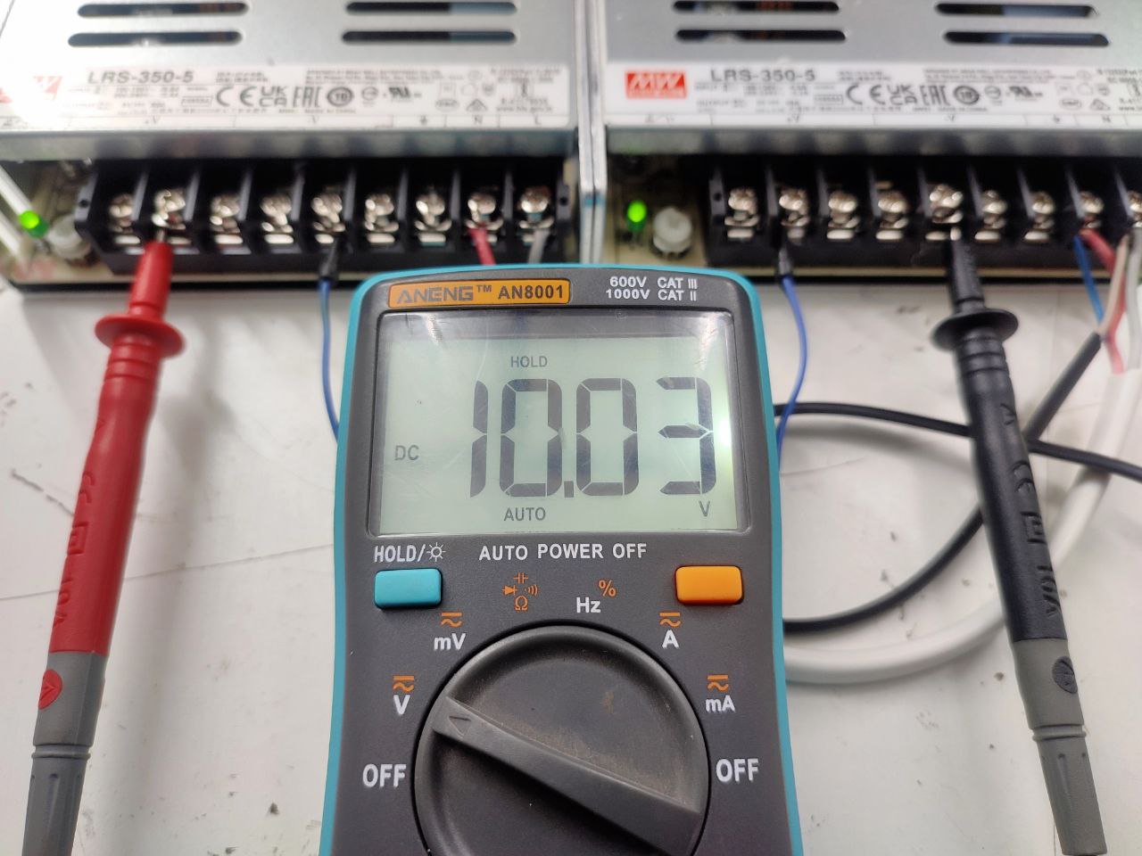

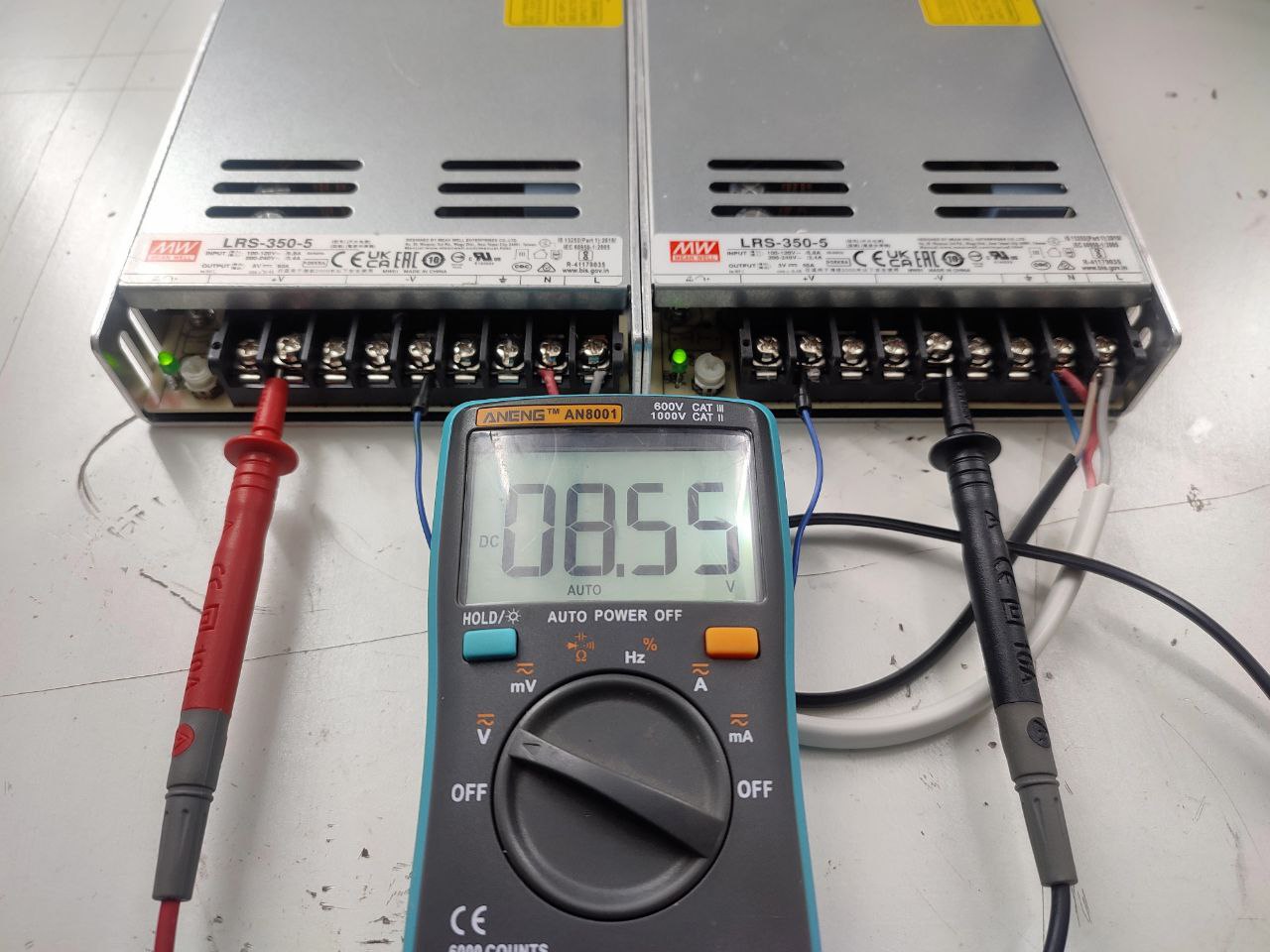

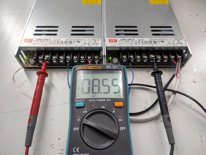

Did a quick test of another part of this project, the 60A/600W charger.
It’s comprised of two Meanwell LRS 5V 350W units connected in series. These LRS models have an adjustable trimpot to change the voltage slightly.
With both trimpots at one end, both power supplies output a combined 8.5V:
With one of the trimpots turned all the other way, the combined output is 10V:

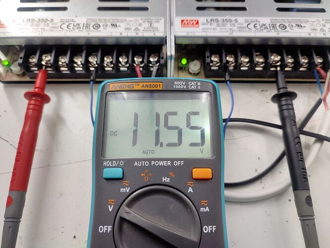

Then with both trimpots turned so that both power supplies output the maximum voltage possible, it’s 11.5V:
The datasheet indicated an adjustable range of 1V per unit, but we’re seeing 1.5V here, which is good.
