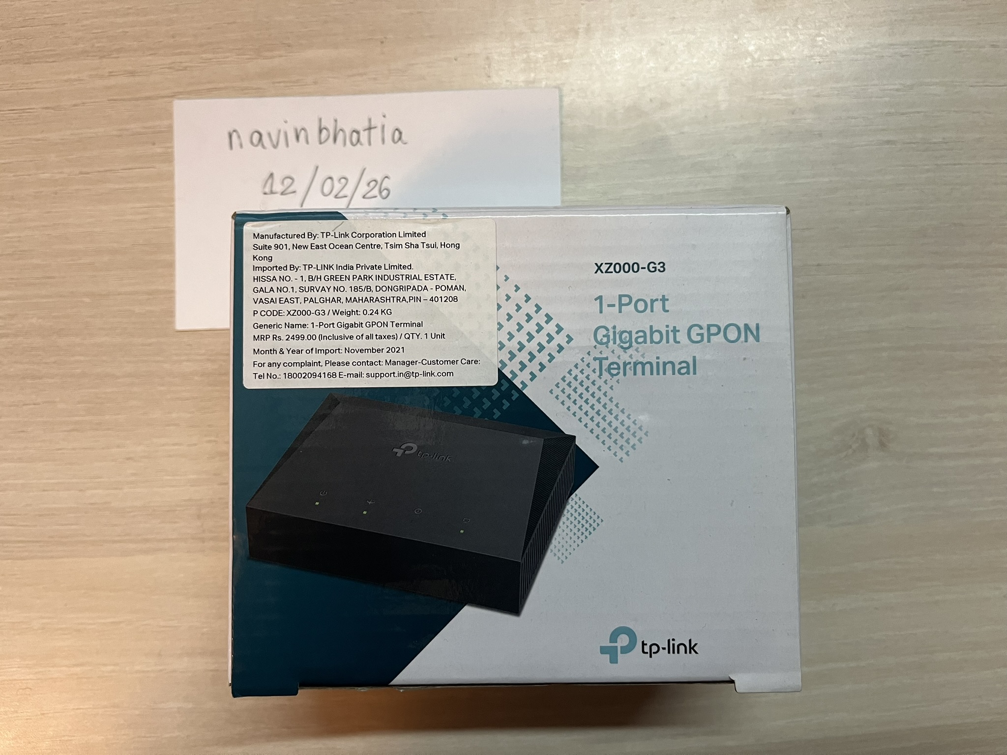

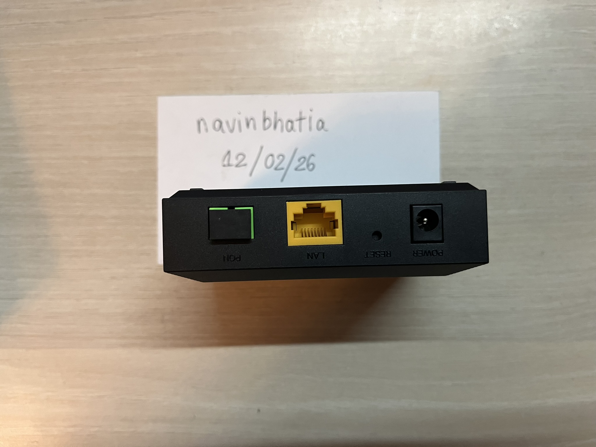

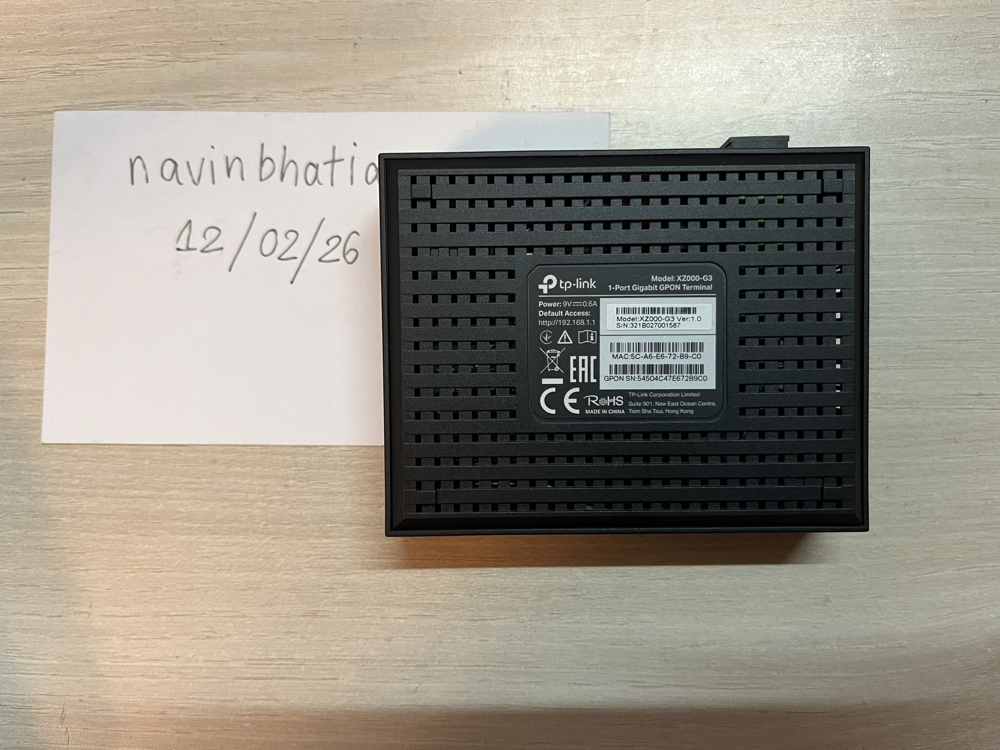

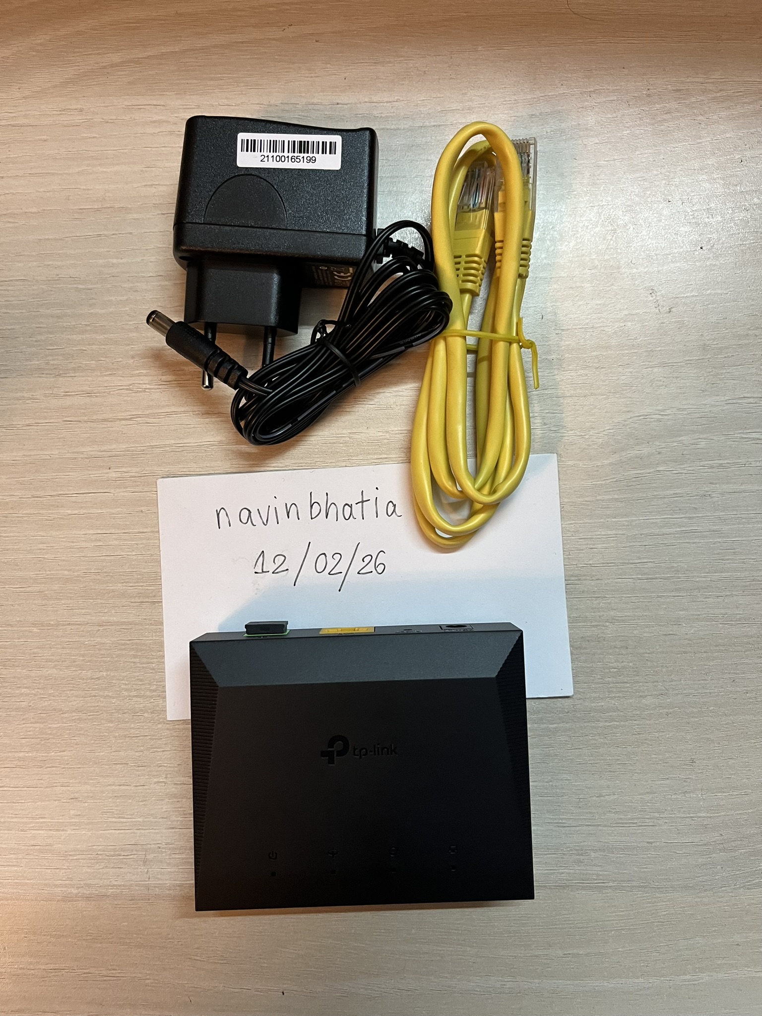

TP-Link XZ000-G3 — 1-Port Gigabit GPON ONT
GPON-only ONT with 1× GbE port and SC/APC fiber connector.
