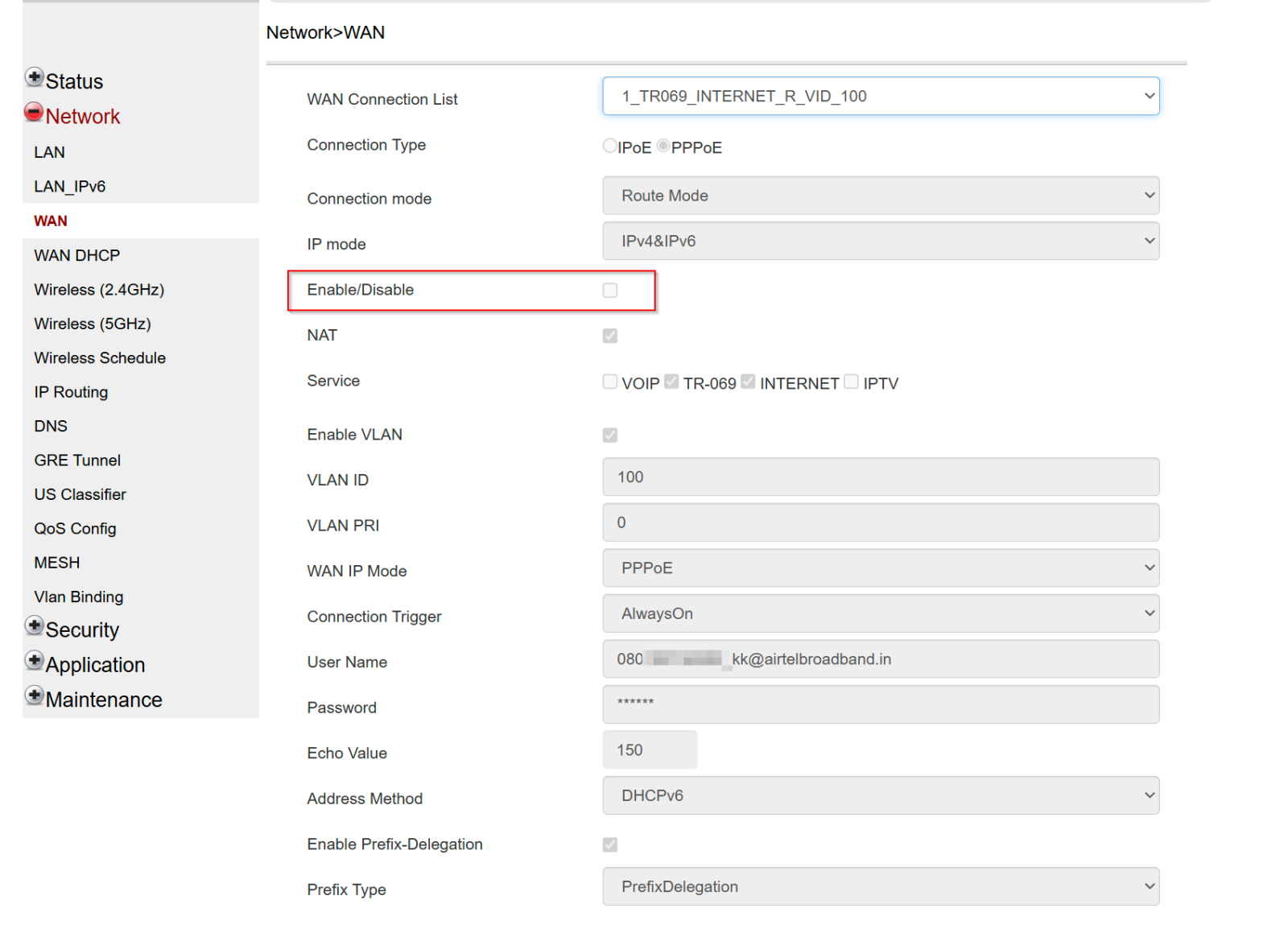

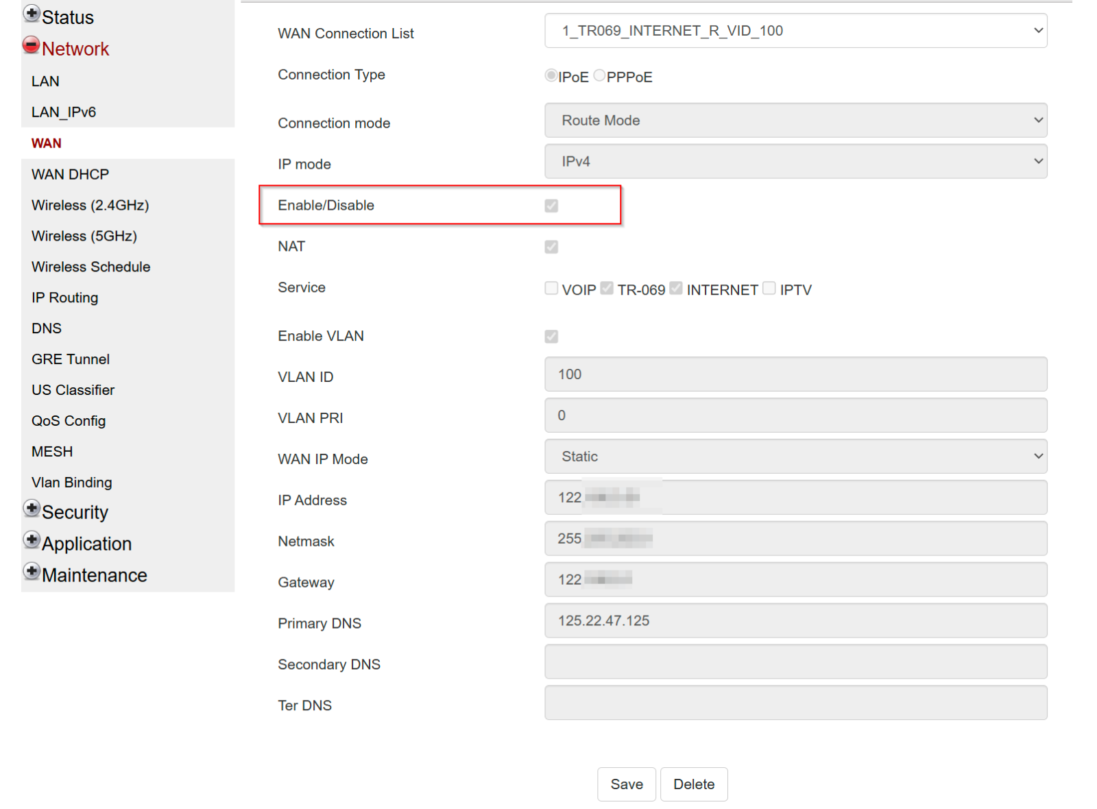

My static ip is already activated, i now have 2 profiles in the Airtel ONT, one for PPPOE and other for Static IP. the PPPOE one is not enabled, so by default my static ip is indeed working and i have verified it. I'm living in Sarjapur main road. My vlan scanner in the Tplink ONU is saying 980, i will still test with 1503.
Below are the snaps from Airtel ONT- both my profiles
Can you check what other options you have under the "connection mode" dropdown. If you can not edit this page, create a new connection, and try setting mode to bridge, and use vlan id 100.

It is activated. The engineer who came to configure it wrote all the details in a piece of paper and it also matched the new internet profile which they created for me in the Airtel ONT. Snapshot is here. Of course I checked my static ip in whatsmyipadress as well
