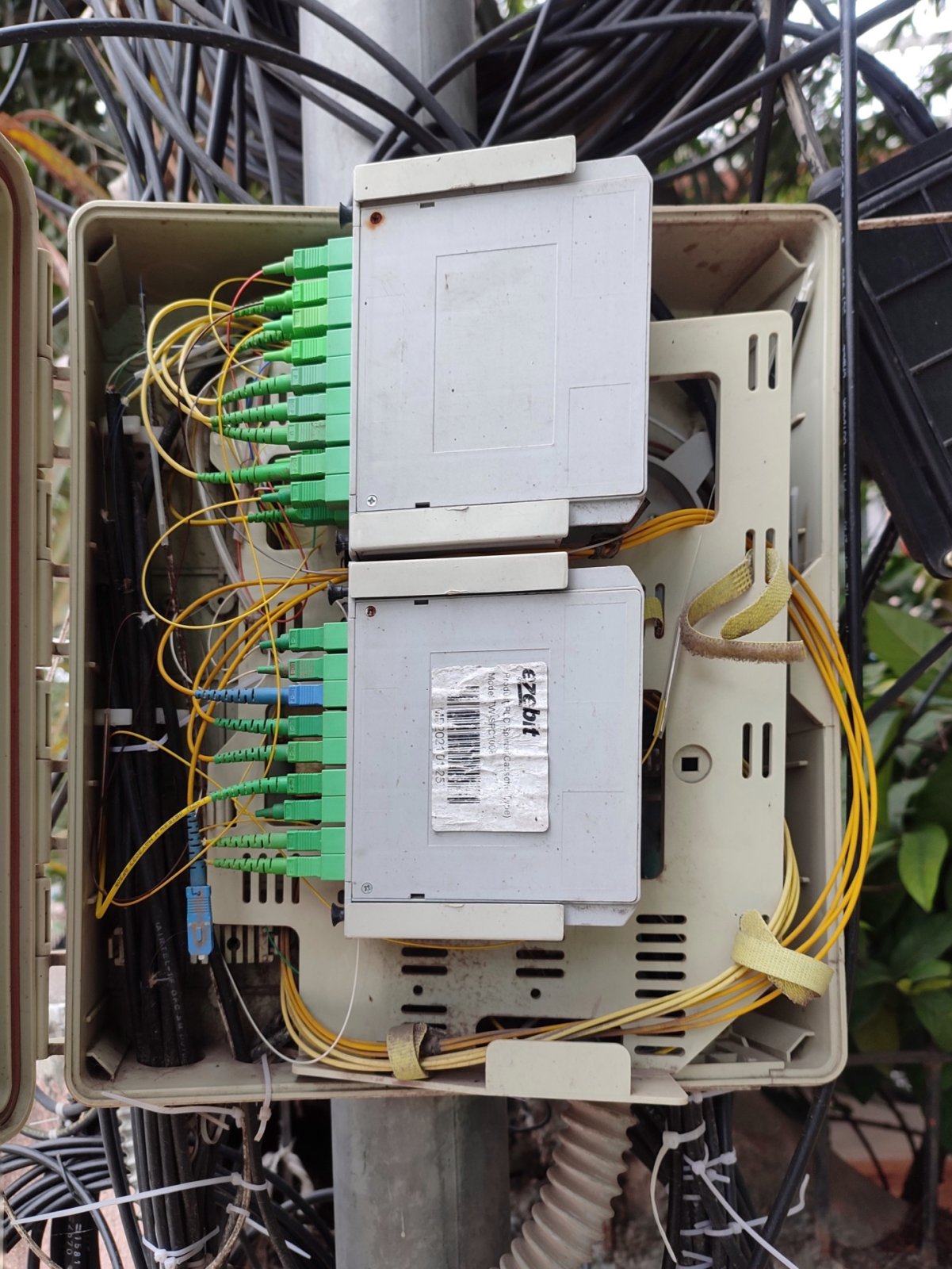

For me the black optic cable comes till home and then split/spliced to that yellow cable. Whatever outside that is fixed to the tree is just a black thin box.
The same thing is done at the other end dude... See all those green ends? Each is an individual's connection.
This is what I was talking about. If this box is at capacity they just disconnect someone's cable and connect the new customer's cable.
Complain, fix, complain, fix and the cycle keeps repeating until they get the capacity extended or install a new box nearby.

Wait, so the thick black fiber cable is not individually run to houses?
They are, that's the armored/reinforced/outdoor-rated black cables coming in on the left and then spliced with the yellow cables that are plugged into the splitter. It's set up like this:
This box represents the middle two parts of that chain.
Okay, so am I understanding this correctly now? -
only the yellow patch cord is run into houses from there?
But must be using only the more rugged black cable.
and I'm assuming they're doing as in the image (only) for apartments
these assumptions were wrong. For some odd reason, I assumed the left part of the image is the input side; It's the output side!
Still, is it okay to have such exposed wiring as in the image? In my end the spliced and exposed parts sit in this
box. So, is it just avoid me being dumb with it?
It's a fiber cable. Very delicate and can be broken very easily so any joints in-between either at your home or outside are out inside such covers securely to protect them.
I understand that, what I'm asking is - is it all-okay as long as it's in a box? For instance look at the top right of the image; looks like the fiber cable is bent over 145 degrees and is hanging on itself!
