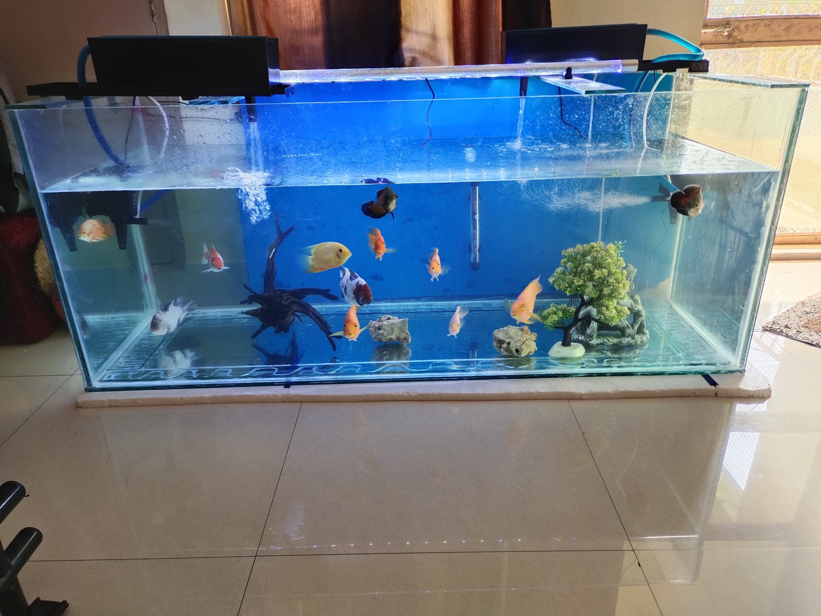

@terminater Did you use masking tape on the corners? You need bigger filters man. Nice curious looking fish. I hope you cycled the tank :)
I guess you are making/buying a stand for it now and this is a temp set up. If possible fill it up or else you may have some hard to remove white lines on this water level.

Masking tape ..did not use ....my bad....
Fishes: Oscar(albino/tiger)+ Severum +red parrot + King Kong Parrot+koi+ Marvel vieja..
Cycling was done.for short time..microlife S2 was used..
Temp setup...
Ok..will fill upto high level .
