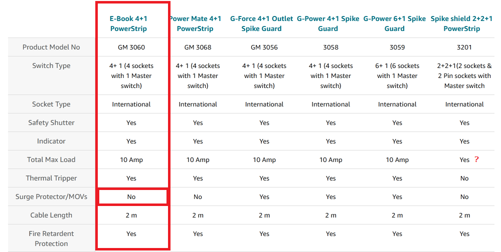

Yes, that depends on the quality of protection you're going for. A standard Surge protector does work by diverting the extra electricity into the outlet's grounding wire. Most commonly an MOV is used to divert that extra voltage. This gm 3060 model does have that in addition to the fuse protection that already mentioned.
Yes and that fuse is inside that Surge Protector. These kind of surge protectors have this fuse inside them which can be easily replaced.
Fuses are also commonly used to protect from overcurrent/overpower, they don't do anything at all when it comes to voltage. Their main function is to melt and break the connection before anything else burns up and catches on fire. If you look into the product description of the link you sent, it clearly states it that it does not have any surge protection.
Oh, damn. I am really sorry for the mistake on my part. I guess I have been duped by the store owner into thinking it has one. I should have done the due diligence before buying it and also recommending it.
I think 'thermal tripper' is them referring to the fuse.
This Honeywell product is an actual surge protector. Rest of them use fuses or resetting overload switch and one mov connected from live to ground for the least amount of protection.
Honeywell Surge Protector, 4 Universal Sockets, 2 Meter Cord, 15000Amp, Device Secure Warranty, Automatic Overload Protection, Spike Guard/Extension Board, Master Switch, 3Year Manufacturer Warranty https://amzn.eu/d/8EZapgl
Plus there's device protection warranty upto 25k in the Honeywell which they haven't advertised.
