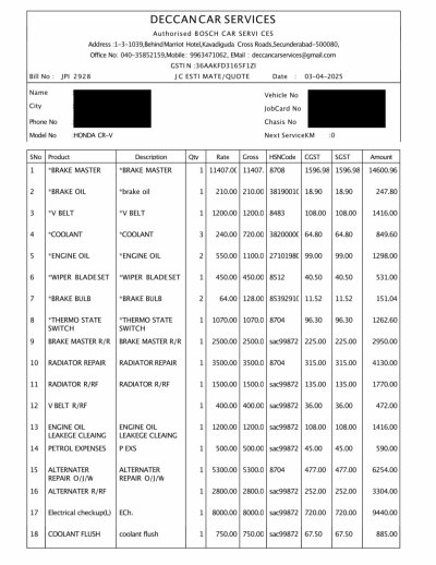

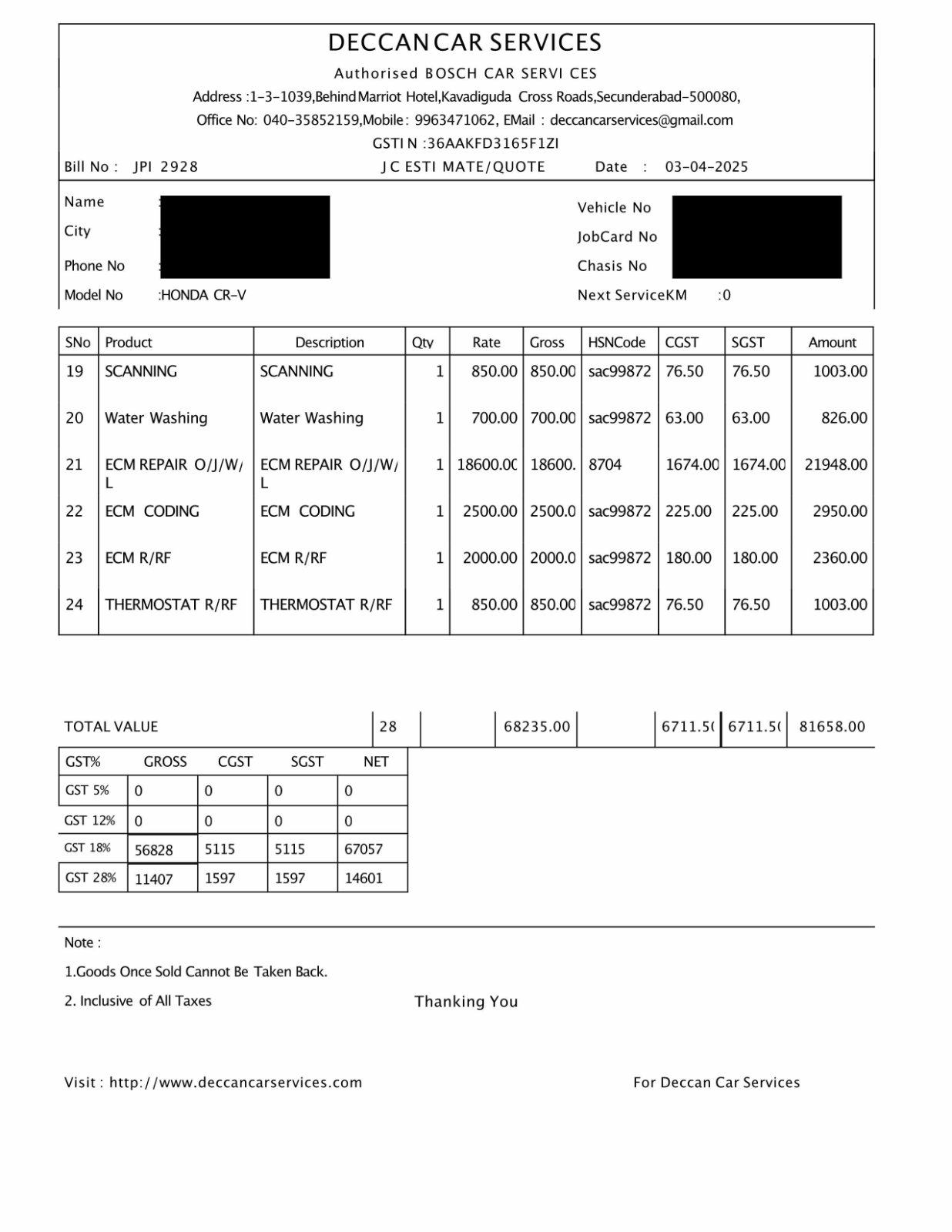

But that didn't fix it, so I looked up online and found that there are Bosch branded service workshops that do a decent job and took it to the nearest one to me. Work was slow because a lot of things happened when car overheated — the radiator burst, ac lines became loose, brake master was damaged, wires melted, causing a short in the ecu, etc, etc. They had it for almost two months, but fixed everything as best as I could have hoped. They were extremely professional and apologetic about the slow progress. Turns out they needed to trace out the wiring harness to repair it, procure another ecu, send it to Mumbai for reprogramming and then send it a second time because it was not done correctly, etc, etc. The costs were very reasonable, I attached the bill (R/R is remove & replace — the cost of labour). A lot of work needed to be done since it's so old. But it is a nice car to drive, even if it's just 4kmpl (2.4L japan import with oversized tires).
There is always a sign in the dashboard when car is getting overheated, could be due to any reason, coolent leak, faulty water pump, faulty thermostat, clogged radiator, faulty radiator fan etc.
But people don't stop their car, they keep on driving until it completely breaks causing all kinds of massive failures, if they just stop, the repair cost is very very low.
Yep, this is how I learned that the expensive way. In my defense, the CRV is only the second car I've ever driven, the first being the Zen. I taught myself how to drive it in 2004 by reading forum posts and watching movies (yes, really) — about three years after I got my license. The Zen didn't need to be looked after, it is pretty robust. Just fill petrol and go. This CRV has a bunch of lights and gauges that I ignored, which led to the radiator bursting and all the other problems. Now I make sure to look at everything whenever I'm stopped at a signal.
