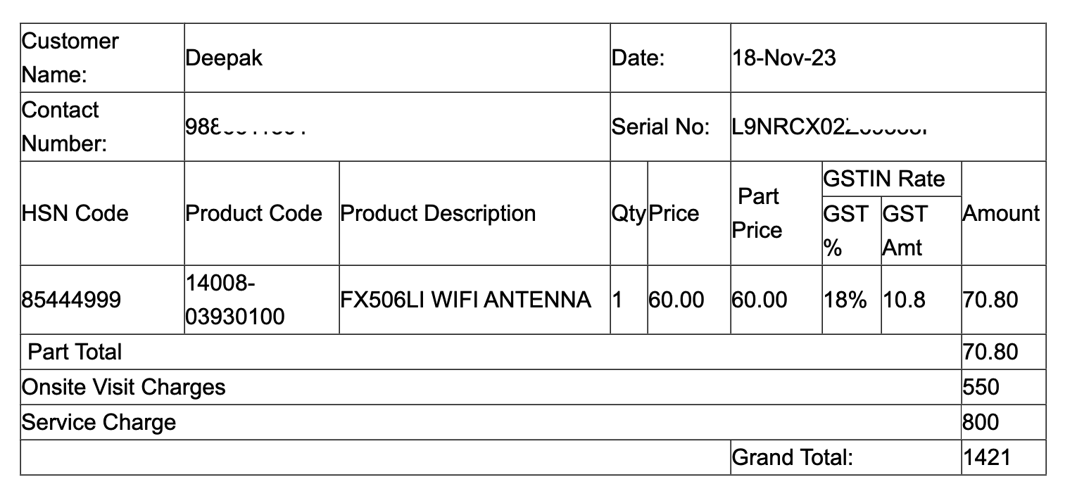

ok quick update - I had raised an out of warranty service request with Asus and one of their onsite engineer visited my house and confirmed antenna module needs to be replaced.
Within an hour I received the below Quotation from Asus vendor asking me to approve the part replacement including service charges.
The antenna costs just 70 bucks and service charge is whopping 1.3k :eek:
I had no choice but to approve the replacement and service charges, will confirm how this goes once the part replacement is done.
It seems like a fair quote considering its onsite.
1350 for an onsite and intricate/involved repair is not bad at all
