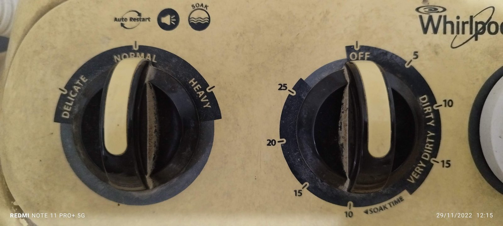

I don't know what you mean by wash cycle but PFA pic.
Time duration of the wash cycle I meant. Seems like it is 25 minutes plus soaking time. So if soaking time is I dunno, maybe 15 minutes then it will be 25 +15 = 40 minutes
Or does 25 minutes include soaking time?
No clue, I just use it as per my whim.
No clue, I just use it as per my whim.to
Looks like a 25 minute cycle. There are two options
if you turn it clockwise to 25. you get a continuous 25 minute wash cycle
If you turn it halfway to where it says soak, it soaks for ten minutes and then does a 15 minute wash cycle.
I don't know why they show 10 minutes as dirty and 15 as very dirty.
I never went by that. I go by my whim.
Well there is a correlation
Warmer water will clean faster than colder water
If you are using tap temperature water you need a longer wash to clean than if you used warmer water
In short with a top loader, the longest wash duration will give you the best wash quality. For normal soil
For heavily soiled you need to add a soak cycle
