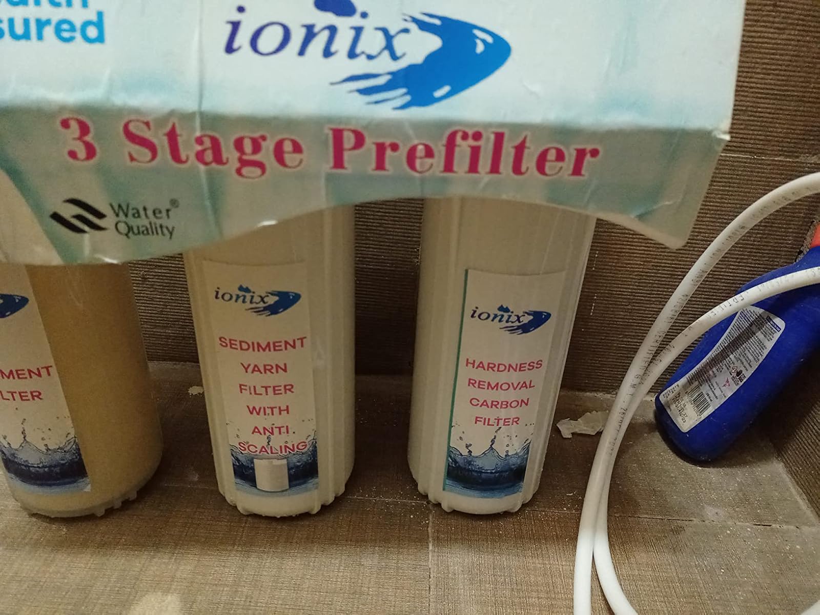

Insists on a 'filter' which is this one. Always refuse anything that is magnetic and claims to do water conditioning. It does not work and will do nothing.
See the red bolded text? read the linked bit

Given the high ppm of even your corporation water, any RO system filter membrane is going to get scaled and require replacement in half the time.
Typically what is done is you feed the water from the softener to the RO to prolong its filter life.
I was wondering whether an RO system alone could also handle laundry but it wastes a crazy amount of water. 10-50% more for every litre. Nor could it handle the flow rate required. In comparison, a water softener wastes just 2-4% more. And yeah the hard water will kill your RO filter faster since now you will be using MORE high ppm water.
