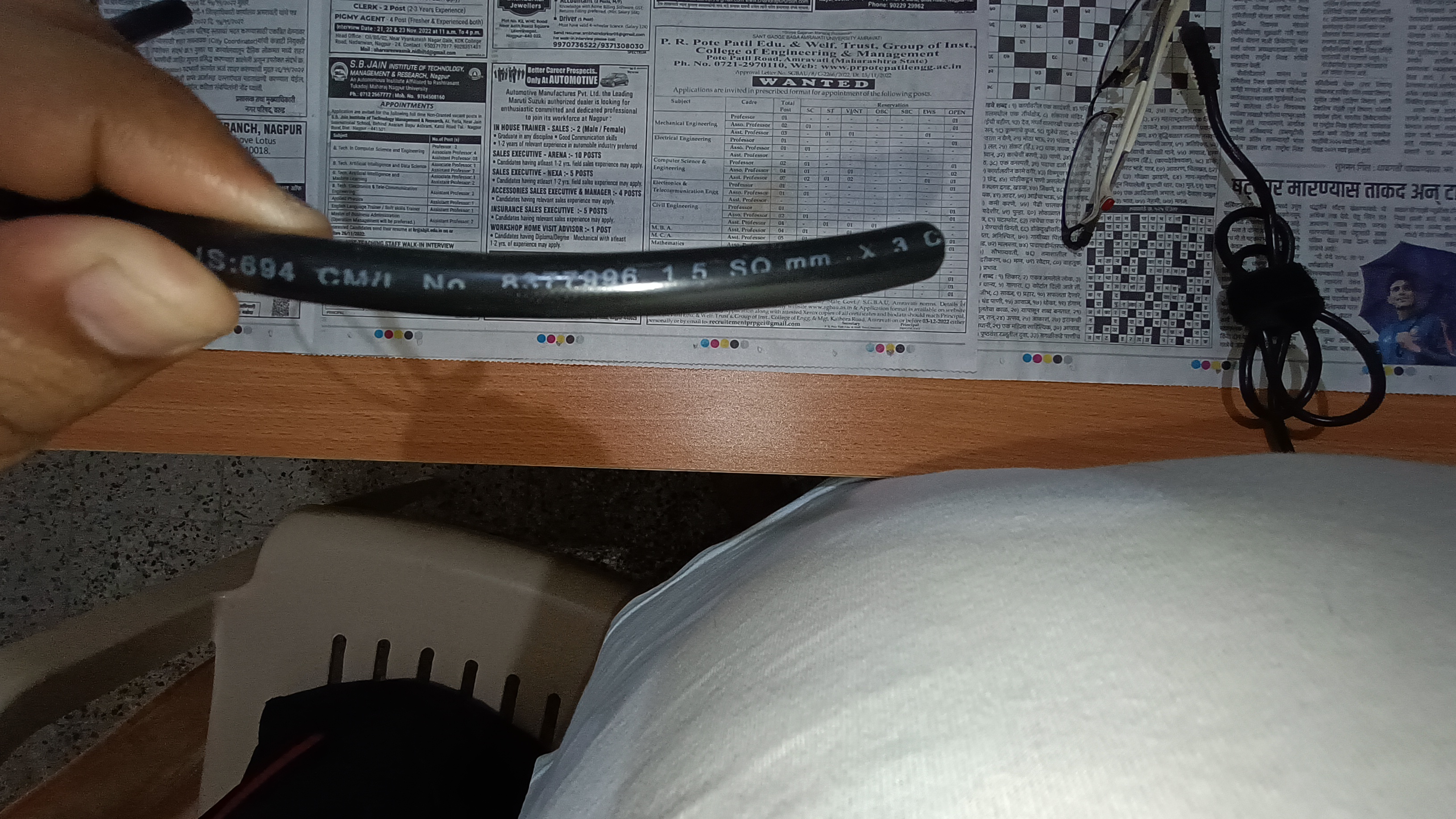

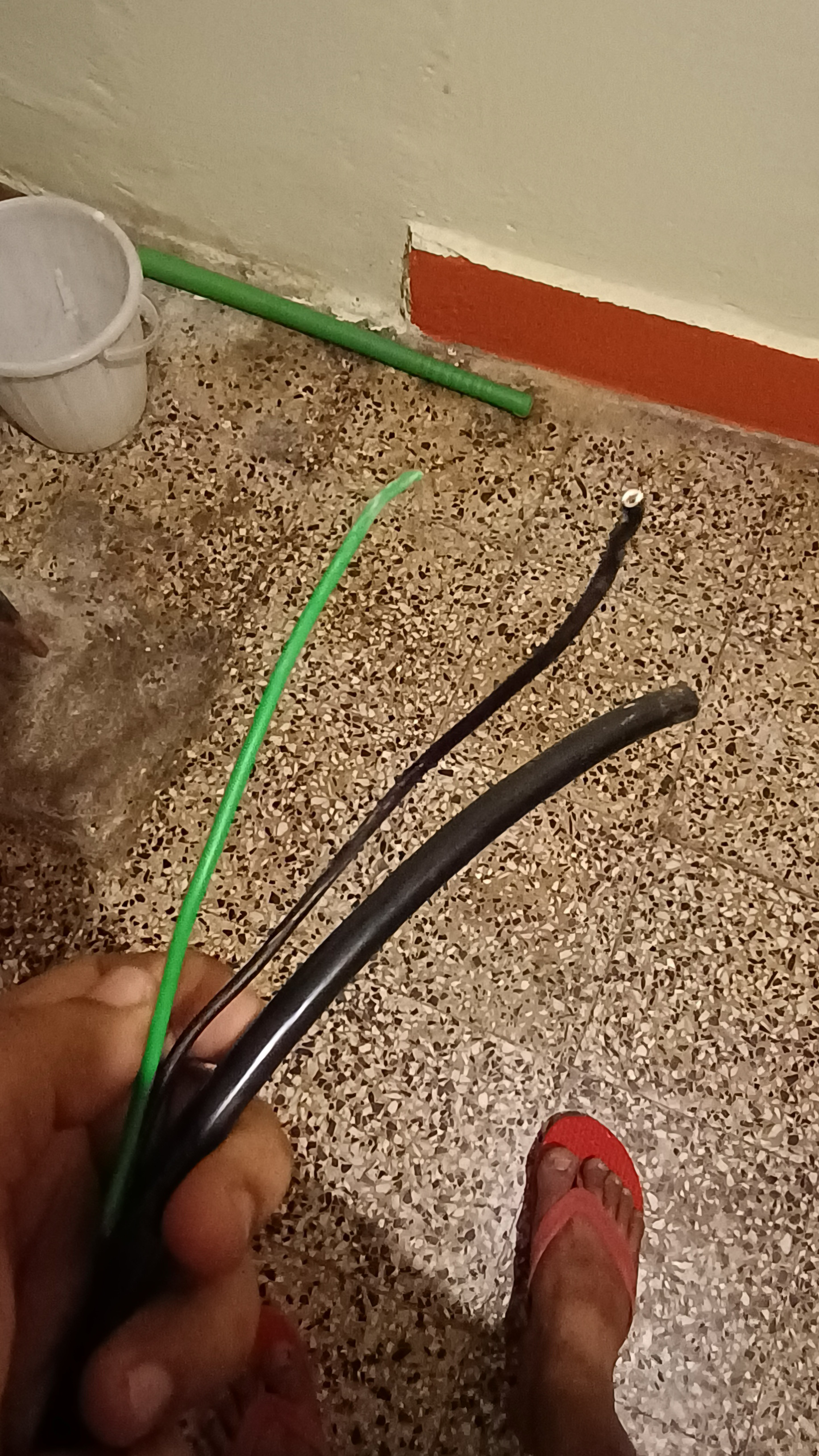

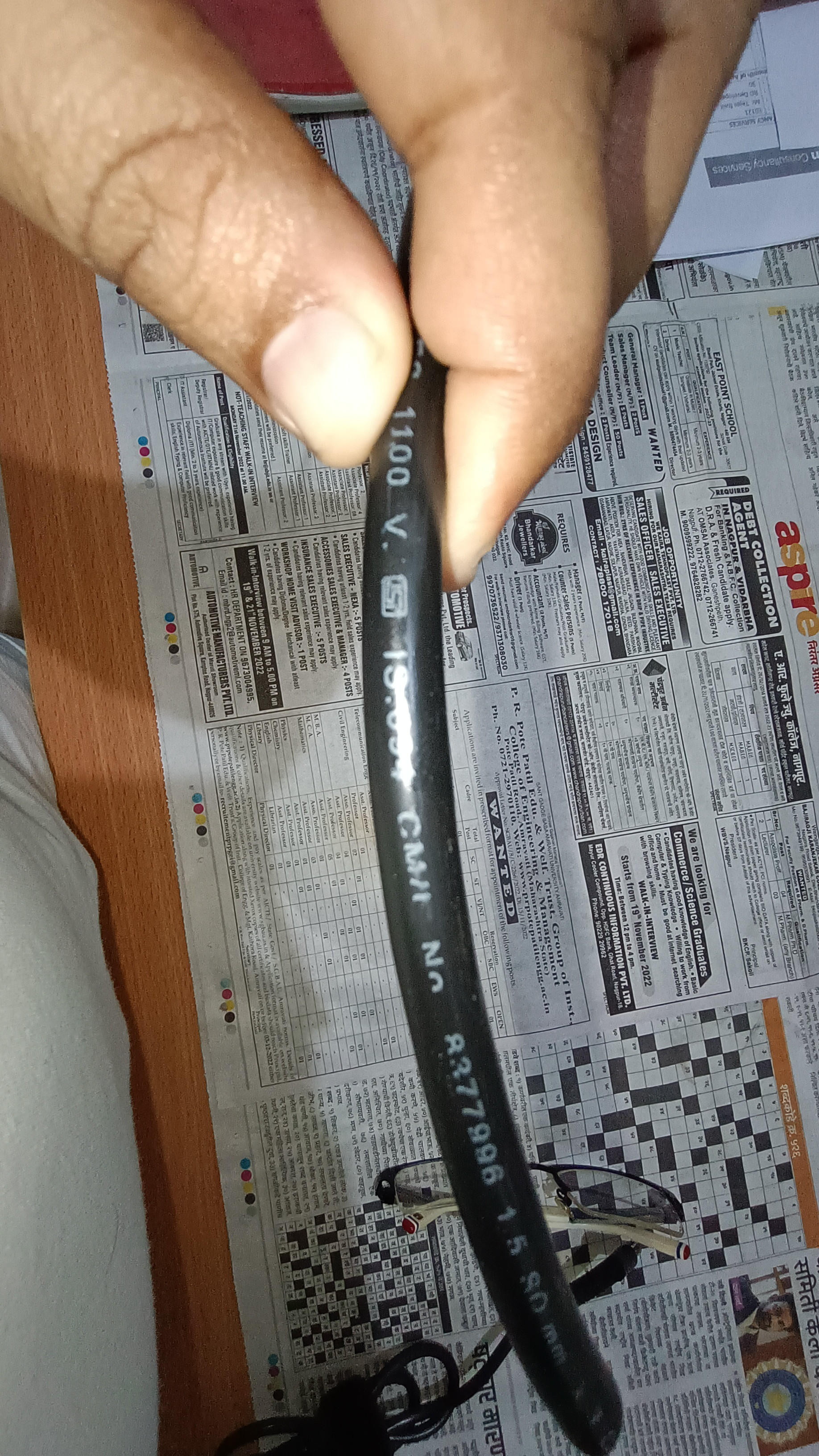

This 'small in thickness' bit is the concerning part. Can those wires handle 16A or not? You cannot add a 16A outlet to a wire designed for 6A !!!
Pull out a 6A outlet and check the thickness of its wires. Are they the same thickness as the ones you connected to your 16A?
He told me that if your rod is working fine then so should your machine. Just don't run both the machine and the rod together as both are getting the connection from the kitchen board.
I can't check now since calling the electrician will mean more visiting charges. As far as I know, the yellow coloured wires were for kitchen socket. The socket was small so it was for 6A. He told me to ensure load is upto 1500W, not above.
I will try to check since I still have some 16A wire left behind from yesterday's work. I do intend to ask the retailer for the max wattage of the machine I choose.
That means it's a 6A socket. You can't run a washing machine with a heater on it.

If your 6A circuit is done with 1.5 mm sq copper cable, which is a general standard, it can handle 2.1k watt load. Would I suggest it? No, because this is public forum. Would I do it myself, if there was no other way? yes, with my eyes closed. I would change the 6A socket to 16A though.

What I think he has done is extended wire from a 6A socket and put a 16A outlet on it. Sounds so dodgy.
From the discussion I had with my electrician, he said that we will need to put a new wire of 2mm from the DP. From what I am assuming, he might have put a 1.5mm black cable(containing red, black and some other colour cable) from a 6A switchboard to a 16A switch. But I am a total noob when it comes to electronics so I don't know what would be thickness of my existing copper wire.
If you aren't buying LG because of its longer wash cycle then you may want to consider Samsung.
I honestly don't know how is the service for Samsung here in Nagpur. Unfortunately none in my immediate family has any Samsung machine, FL. My aunt has a TL but that motor feels so helpless that it cannot agitate the water to move the clothes. But that's different technology. All machines wash clothes, it's the service that matters to me.
Seems like it.
Honestly, both seems same to me. The image below is the leftover of the wire used to connect the 16A plug.
I might be stressing the wires and I don't know how old this building or its wires are. Builder was a big time kanjoos
Gauge of the wire is written on the wire itself. Usually, 1.5 mmsq gauge wire is laid for upto 10A circuitry. Next is 2.5 mmsq. And it's used for 16A circuitry. After that, 4 mmsq is used for geysers and 2 ton + ACs. Most of the electricians are uneducated folks. So everything in electricals is build with an overkill mindset. Most of the appliances that come with 16A plug can run fine on 1.5 mmsq. too. Having said that, if your building is old then I don't think it will have 1.5 mmsq wire for 6A circuit. I don't think you have concealed electricals considering the age of building. If that's the case then why don't you lay pair of 2.5 mmsq wires from the DP to the washing machine? It's totally doable and it's easy job for an electrician. It might destroy some wall paint around the pattis though.
If he's taking 16A switchboard extension from behind the 6A switchboard, meaning direct wire patching then it's workable solution (considering wires can handle it). But if he's making a plain 16A extension board which you then plug into 6A socket using 6A plug then it's a no-no from me. 6A sockets are bad at handling load. 3 decade old socket will be much worse. Just make sure you aren't directly involving 6A socket.
You just uploaded these photos. This is what I was saying, as taking wires from behind the 6A switch board. This will work for the time being. I think that thick black cable is 3 core 2.5 mmsq. Gauge should be written on it. Just don't run multiple heavy things at the same time. There's a way to identify if you are running thinner gauge cables for the loads. If the tube lights in your house dim slightly when you run the water heater rod then yeah the wires are thin. Usually, that's the worst that can happen. Houses don't burn down.
From what I could capture of the leftovers, it said 1.5x3 something.
Right. That's 3 core cable containing 3x 1.5 mmsq wires. It'll work for now.
