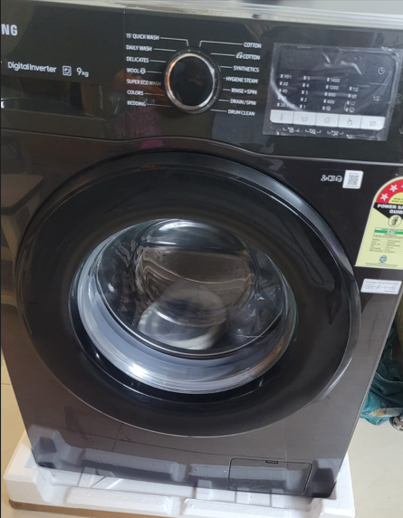

Picked up this Samsung 9KG Front Load for 32k from the Samsung Showroom, was expensive by 8k in other stores as well as FK/Amazon.
Just remember drum clean with sammy means no adding anything as it drains everything out within 5 minutes.
To do any maintenance cycles you will need to use cottons on either 60 or 95

It's this one - https://www.flipkart.com/samsung-9-...STWMNGSZBQYMXB5CD3YF89BE&marketplace=FLIPKART
Just remember don't buy anything with touch controls, knobs and buttons all the way.
Can't go wrong with either LG or Samsung tbh, I went with Samsung because I've had a generally favorable experience with their other appliances at home.
Check offers in brand exclusive showrooms, they offer better deals than the online ones.
Sure your model has buttons and not touch controls for settings?
Looks like a touch panel because i don't see anything getting pressed. But made to look as if as if its buttons. I've noticed similar with IFB models as well. You tap but don't press :bored:
Only power and start are buttons. The other controls are touch
Ideally buttons is what you want but nobody is offering a model with it these days unless you go for older models. Like from five years back.
Another thing that video confirms is Sammy does not have weight detect on its cotton program or any of its programs because the time is shown immediately as you cycle through the programs.
A cottons wash is 1h27m no matter the load?
With LG you get a spinning wheel on the display where depending on the load the time can vary from 1h10m all the way to almost three hours. For the cottons program and a few others.
