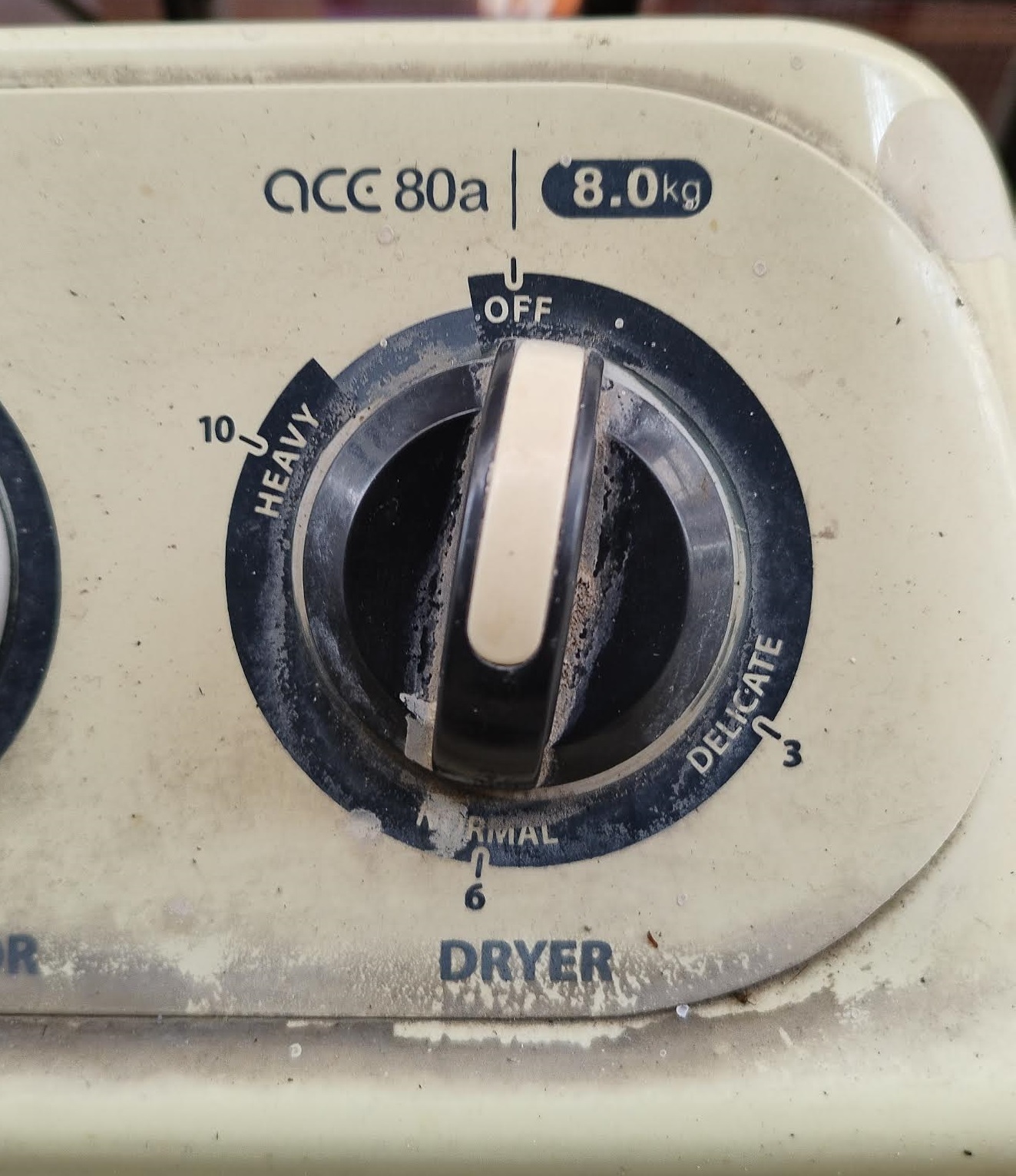

What is the usable volume in litres of your 8.5kg semi?
My bad it is 8 kgs. No clue about usable water volume. It is this one.
@blr_p I have 8KG Semi right now will an 8kg Auto be able to wash same quantity of clothes in one cycle?
Yes
