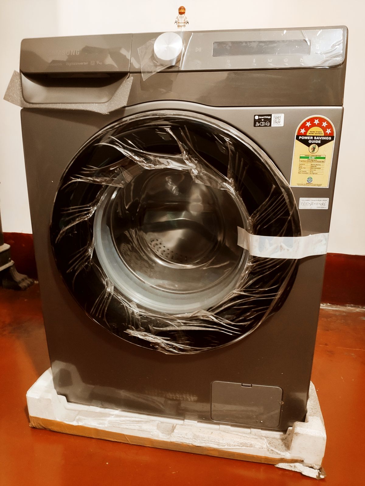

I ended up buying 2 machines...
Samsung WW90T4040CB1TL (9kg) - For Mom
Samsung WW90T504DAN1TL (9kg, Eco Bubble, AI, Wi-Fi) - For Me & my SO (Different house).
Ordered them both from Amazon (Seller was Dawntech Electronics Pvt. Ltd.) on the 2nd of September and they got delivered in good condition yesterday. Amazon delivery team was very proficient and used platform trolleys to bring the heavy machines secure and safely inside the house. No damages, do dents.
Got Samsung installation & demo calls within 2 hours of delivery. Had one machine installed yesterday evening itself and the other one today at my Mom's house. In both cases Samsung's engineers were fantastic and installed, leveled and explained the functionalities of each machine patiently. The one with AI and Wi-Fi was linked up to my home network without hiccups thankfully. There is a video tutorial on Youtube for the same machine on how to setup Wi-Fi on it and that proved very useful because it made the process even easier.
If anyone wants to watch the video to know more about the Samsung Smart Things App and how it integrates with the Machine here it is:
I'm most excited about using the Wi-Fi enabled Samsung WW90T504DAN1TL at my apartment. Linked it up with my iPad and it's a breeze to control the machine through Samsung's Smart Things App. Right of the bat I noticed less vibrations during spin when compared to my last Bosch machine. Also, this one has a plethora of wash options (I know I won't be using most of them though, LoL!) and almost every wash can be customized as regards to water temperature, number of rinse cycles, spin cycle RPM. One can also customize an independent user wash program if needed. The App is pretty solid once you link it all up and isn't half baked and glitch-y. The touch panel is responsive as expected while manually operating the machine.
Here are a few photos of the Eco-Bubble machine itself and the app screenshots:

I still haven't tried the 100% Dry mode (since this is a Washer + Drier). If anyone has any questions regarding this machine please do ask.
The other machine... Samsung 9 kg (WW90T4040CB1TL) that I bought for Mom is a no nonsense, non-Wi-Fi, no App workhorse. You just put your clothes in, put your detergent of choice, turn the knob to choose your wash type, key in your wash options on the touch-screen (if you want or just use the preset options) and hit Start. Simple and straight forward.
I'm happy with both purchases and honestly I'm enjoying tinkering with the wash modes on the Wi-Fi machine.... honeymoon period with new electronic equipment :)

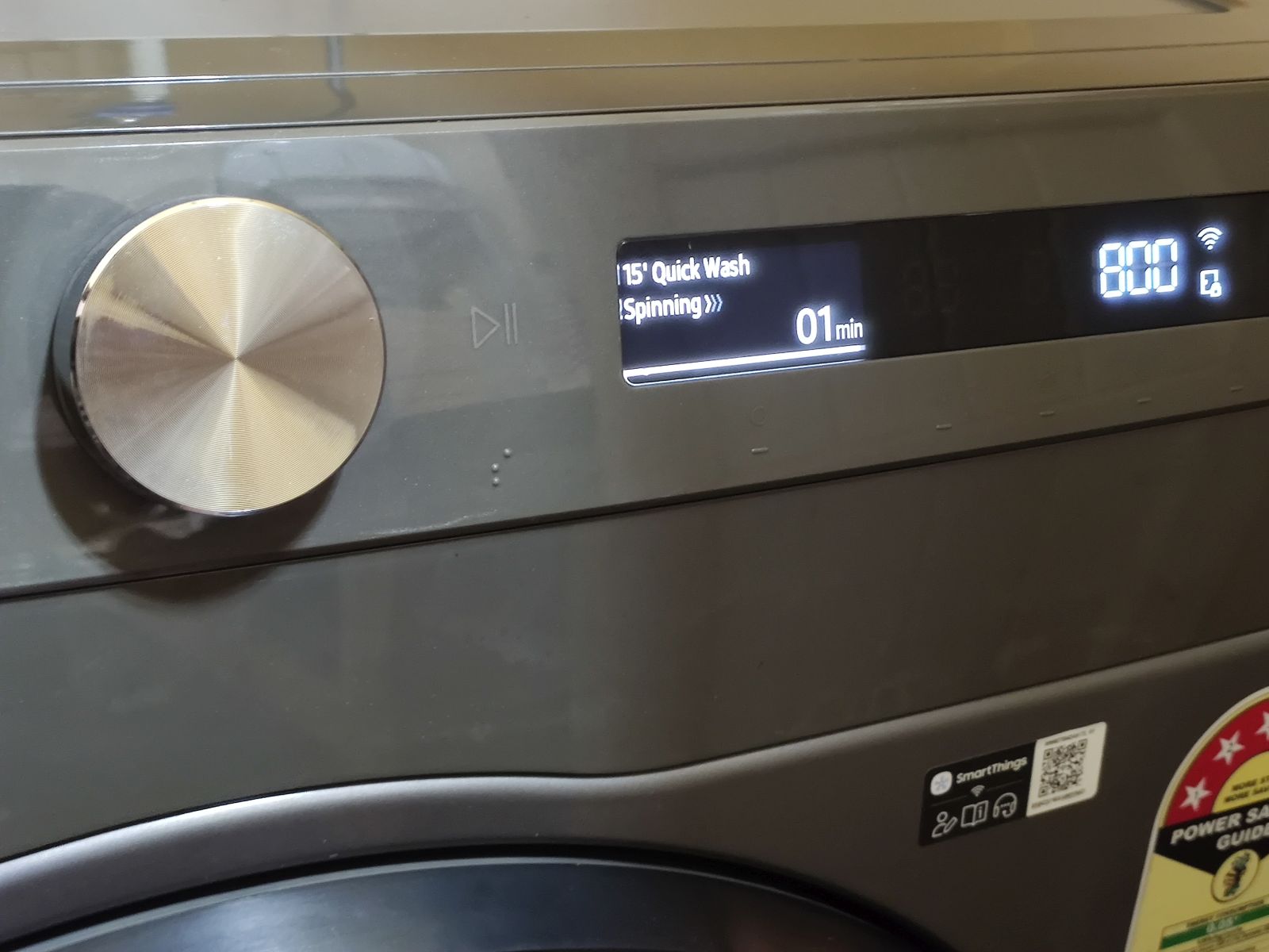

Clear window :happy:
People were complaining they couldn't find the start button because its so faint. I can see why but then Samsung has also provided braille on this machine as well.
Whether that's an inhouse joke or meant to be taken seriously is unclear.
Does this machine and your mothers have a load detect function with the Cottons cycle?
This means the duration of the program varies and is calculated automatically by the machine depending on the load.
