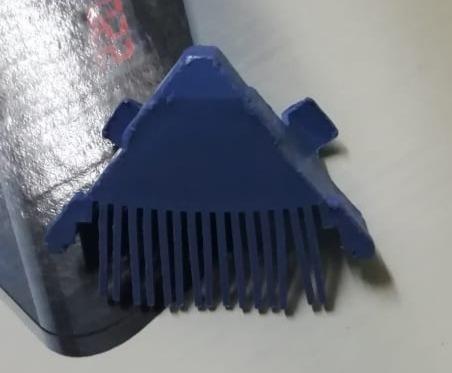

White magic classic 601sd
Your machine has a lint filter but it's under the impeller.
The design is so there is no need to clean a lint filter.
There aren't too many complaints about lint with this whitemagic series. I saw a couple
Less than 1% complaints about lint. So something is up with your machine.
This one was interesting
Could it be the lint filter has got dislodged somehow and does not function as intended ? a blockage somewhere
You might need to take a look inside.
