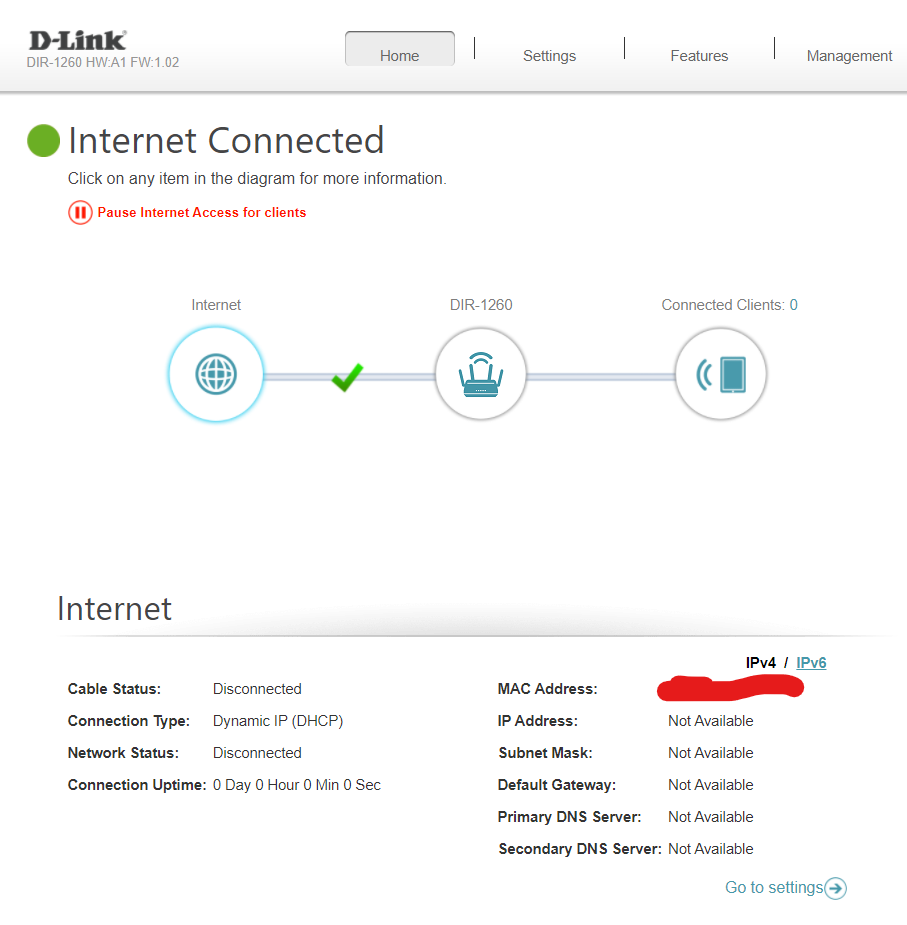

@superczar Problem solved. Thanks man! Resetting the router again with both systems powered on gave them the proper settings. Now the systems are getting IP address from the Jio Router. Wi-Fi is working properly as well. I am just worried there is no AP mode option in the router web panel. It asks me to configure internet every time I login as there is no cable in the wan port. I skip it by loading any other page in the router by URL.
I guess every thing is going through JioFiber Router now as I am not seeing any information in the admin panel regarding the connected clients. Even the wifi devices are getting IP assigned from JioFiber Router. Is this good enough or should I go for a router with AP mode option in their web panel?
If you can't find AP setting, just disable the DHCP server on the DIR 1260
and leave the WAN port unused completely.
Yeah. Did that and it's working fine now. Just missing the ability to use guest network (AP Isolation).
