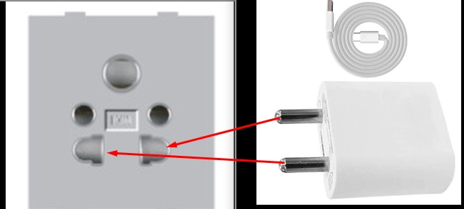

All mobiles released in a last few years have chargers like that. Check the charger from the photo itself. Check your own charger against any other 2 pin plug.
One may not realise it but chargers don't come with standard 2 pin plug layout. Chargers have bigger prongs like 3 pin plug and spacing between prongs is also like 3 pin plug.
Hence mobile charges require 3 pin socket but as they don't have earth prong to push away the safety shutter, they get cockblocked.
I understand now what you're saying. The mobile adapters are two-pin but the pins are spaced like a three-pin. In effect, they are two-pin type D whereas true two pin is Type C.
I never realised there was a difference with the pin spacing as my sockets don't have safety shutters. So these plugs work everywhere. The euro ones however need an adapter as the pins aren't as thick as the Indian standard.
I don't know what you will do if yours have safety shutters. Use a three-pin adapter you plug the mobile adapter into then I guess.
I understand now what you're saying. The mobile adapters are two-pin but are spaced like a three-pin. In effect, they are two pin type D whereas true two pin is Type C

Right. Most of the 2 pin plugs in the house are 2 pin Type D. I checked my new sockets, they work okay with 2 pin type D.
Type C 2 pin plug is a very tight fit though.
I find such sockets in Schneider and Legrand. These have oval shaped holes. I want to know we can plug in a 2 pin plug in them without any problem right?

There are some discrepancies with 3 pin socket. Unlike the above photo the newer models come with round holes. And we can plug in most 2 pin plugs without problem. Some smaller 2 pin plugs will pose some problem though.
