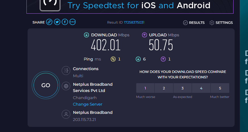

Help!! Upload Speed sucks on my PC.

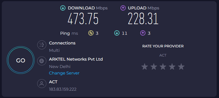

I am running the same motherboard (Asrock B650M Pro RS), getting full 1GbE on local connections (and upto ISP limits on speedtests).
I remember facing some Ethernet related issues on this build early on but now can't recall what it was and what fixed it. Most likely (1) might be it.

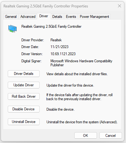

Here are the drivers I am running FYI

Just tried debian live, and as I expected the problem is with windows.

My motherboard is Asrock b650m pro rs, with 2.5Gbit ethernet. I'm using win 11 and I have been getting the best speed I could from my ISP plan.
It was fine a few days ago, I was getting almost 400 Mbps upload.
I have tried uninstalling drivers, changing ethernet cable, Changing ports on router, but now I can not get more than 50-60mbps upload.
I have tried everything from Microsoft posts to reddit but nothing works.
And yes I'm getting good upload on phone and laptop. Just having problem on this Pc.
