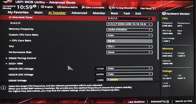

it is a power issue .
idk but when you login into bios verify the voltage (bottom right) in bios if the bios supports
check if the voltages are within the 5% .Generally in asus these readings are in realtime and if they are critically low the text is in red. Most probably connection might be loose or smps is genuinely bad.
Another observation would be supposedly your + 12 + 5 +3.3 remain below the actual value lets say may be 11.8 4.8 2.8 and remains constant for 10 - 5 minutes that to indicates your psu is bad . your system will boot but the voltages might drop causing your internal device to fail.
If all your voltages are as per spec there is a good chance that your CPU Power Cable (EPS12v) and GPU power cable are sharing the power rails and that rail might not be able to handle the combined load when your system is under load
Try to connect gpu cable to different port (different rail) and do the stability test. things would be good.

What do you mean by 5%?
I'll check bios if these are showing for me and update.
@burntwingzZz i booted in to bios and it's showing this, is this fine? 12v fluctuated once to 12.0xx v something then went back to same 11.980v
The difference (tolerance) for the expected vs actual voltage of the power supply. So 5% deviation on 12V would be 11.4V to 12.6V. Similarly you can calculate for 5V and 3.3V rails. Yours is well within range.
Thanks but i don't think that's what he meant by that. He mentioned about that 5% separately first and then said that if they're constantly below 12/5/3v by even a little bit then psu is bad which mine is hence I'm confused. I'll probably give my psu for RMA if it happens again, i don't have the tools nor the experience to figure this out myself.

mate silents interpretation is correct .and your voltages are in range . just make sure yoour cpu and GPu power cables are not on the same rails
kind of yes how the sockets are connected internally varries from different manufacturer + per model basis . smart way is just move the GPU connector from SMPS end
