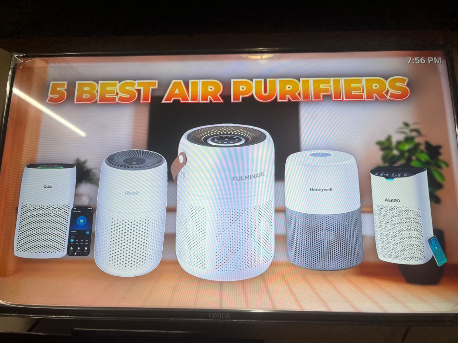

So since my last post, I am binge watching reviews etc on youtube. I realize a 5K range air purifier is what I want because I live in matchbox flat and bedroom is small)
Levoit seems actually very good and small and reviews (even from outside India) are good. But I could not find its replacement filter on amazon. What is the filter cost?
Also, did you happen to consider the Honeywell that seems almost similar in terms of eveything including price? Honeywell seems to have 2 year warranty and filter life seems to be approx 1 year as per amazon page which is more than levoit.
But for this too i could not find filter on Amazon.
Another consideration at ₹6000 is Agaro Royal which is also almost same but has app control and a visual element (red, yellow, green light) to indicate air quality.
Not sure of filter life but i read reviews on Amazon that say 3000 hours which seems less I guess?
Confused between all these models. What is the filter cost of levoit? In terms of looks and portability, it looks best but the agaro at 1k more is enticing for its smart connected features.
