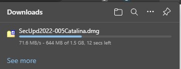

Myabe the 240 was a glitch (happens many times, i see 240 mbps speeds), as i am on 100mbps plan/ now speeds are back to normal . i checked with apple download , it shows 11/12 MB
