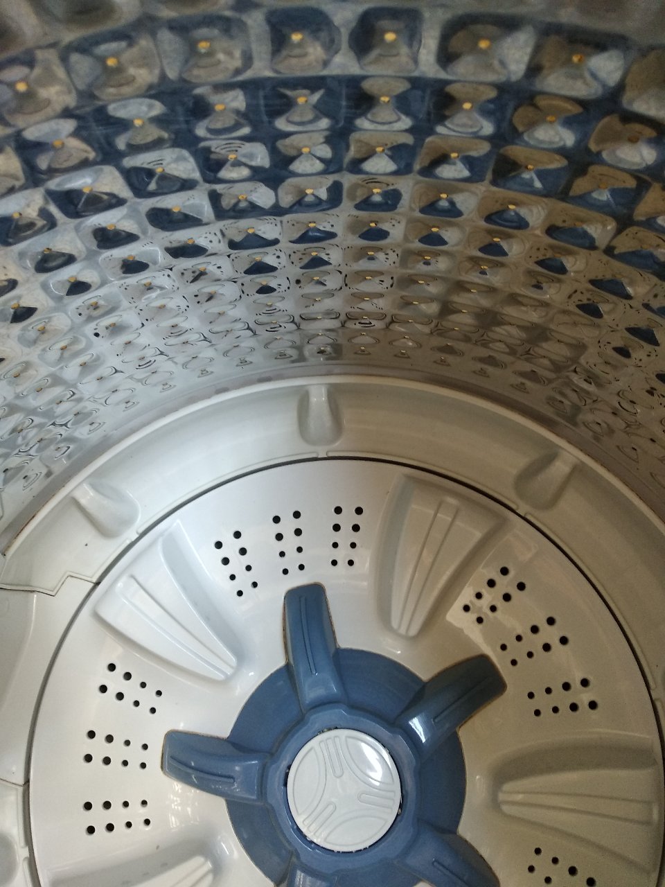

PFA photos sir :)

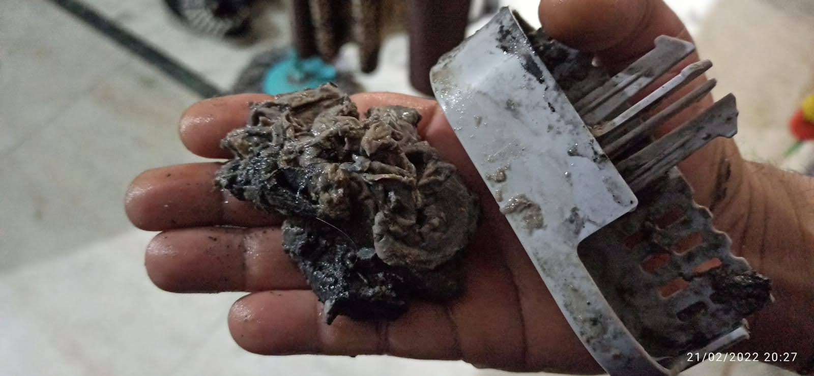

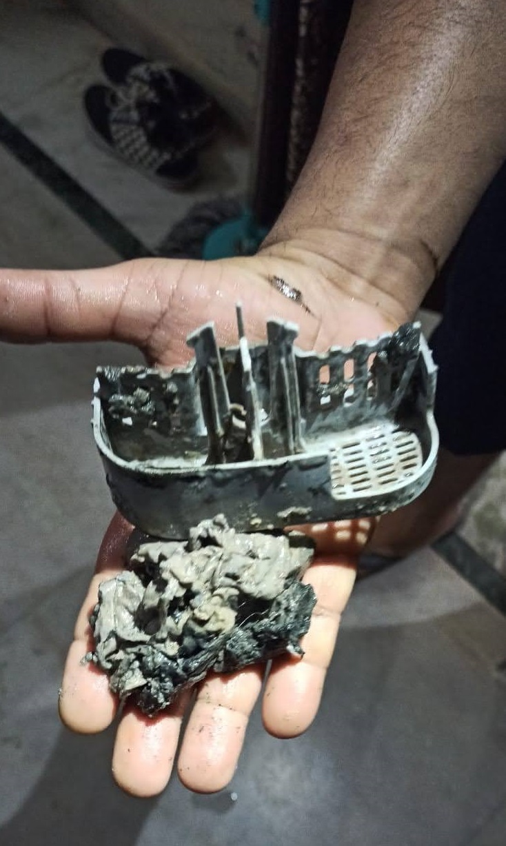

Good, this is exactly what people need to see. The tub is clean but its what's underneath that counts.
From Feb of this year. What did it smell like?
Good thing your machine is a semi-automatic so most of the gunk was near the impeller. Otherwise, that stuff would have coated the inner tub if it was a front or top loader.

This is what a record of cold washing will do. Has your machine ever seen a hot wash in its entire life? approaching 60 degrees

It smelt like gutter, horrible stench.

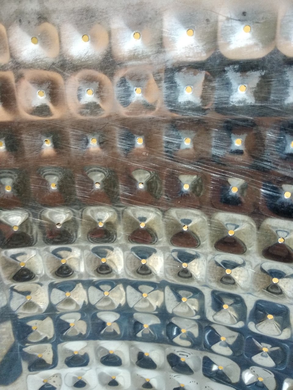

Today, I have noticed that Drum stainless steel shine has become dull
Is this normal?
Descaler won't give you any shine. That is what percarbonate will do.
Try with Vanish powder and follow the instructions on the first page.

I think it's just descaler chemicals leaving a coating on the steel drum. I saw this happen with some generic brand. Had to use a sponge and Colin spray to clean the entire drum and make it shine again. Then rinse again on high.

Take a photo of how it looks now
Then do a wash with your regular detergent and see if there is any difference.
to get the shine back, has to use percarbonate?
After the above, you can try Vanish. Remember to put half a kilo of clean fabric in the drum when using Vanish.
Take a photo after it finishes
Post both photos.

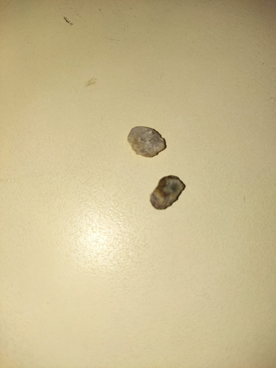

The drum has limescale on it. But not much on the heater element so your water hardness is borderline medium-hard. How often did you descale it?

Does your drum look like this?
or in the case of a top loader
This is a combination of detergent, scale and who knows what else is lurking inside.
If you check with a torch you can gauge how effective each product and its application is and get some idea of whether more attempts are required.
Using only a descaler won't remove everything. Only the scale. Likewise, Vanish can't remove scale only detergent and dirt.
So you have to alternate the treatments with Vanish and descaler and it will take several attempts.
A shiny drum means nothing, Just 10gm of Vanish powder in hot water is enough to give you that.
Do not conclude that just because the drum is shining the work is over. The stuff that you can't see on the inner tub and the drum is more sticky and clings harder.
You are only done when nothing floats or comes out. Then you have more confidence that the inner tub is cleaner. The plastic reservoir that holds the water which you cannot see.

after the machine completed the tub clean cycle I opened the lint trap located at the lower front of the washer to remove any debris and found small pellet like substance in semi grey colour. There was around 25gms to 30gms of this substance which I scooped it out. When I slightly pressed it with my fingers it became powder and also smelt like a detergent. Is this a calcium deposit?
No, it is the Ariel powder. What temperature do you wash your clothes at?
And if it is doing that to the filter then what is it doing to your spider? Coating it nicely where you won't be able to get at it. A few years of that and your spider gets oxidised and one fine day breaks. Sooner than it should have. This is why the max temps, 'Intensive' option enabled, boil wash must be done once a month. Every month.
The lesson here is if you notice such deposits then change the detergent. It will take several kilos of the detergent to know. The best thing to do when trying out a detergent is to stick with it for a few kilos or litres and then see what deposits you find on the filter. If it is clean you're good. If some detergent leaves more then avoid it and find another.

When I opened up the filter again couple of days back there were few more pellet like substance which I have attached as images. The first image is the pellet substance and the second image is the one that when it is crushed with the fingers. I still smell detergent when the pellets are crushed with the fingers.
No residue. Without borax there's some brown residue clinging to clothes.
Could just be buildup flaking off. Once the drum is clean whether you will still notice this brown residue without the borax is to be seen.

When I opened up the filter again couple of days back there were few more pellet like substance which I have attached as images. The first image is the pellet substance and the second image is the one that when it is crushed with the fingers. I still smell detergent when the pellets are crushed with the fingers. View attachment 152938View attachment 152939
I think this is residue coming off your drum that has accumulated over the past two years due to the recent percarbonate use.
I cannot explain why it's there to start with given you do mostly hot washes. But these are important clues that regular use of percarbonate is needed even if you do hot washes.
