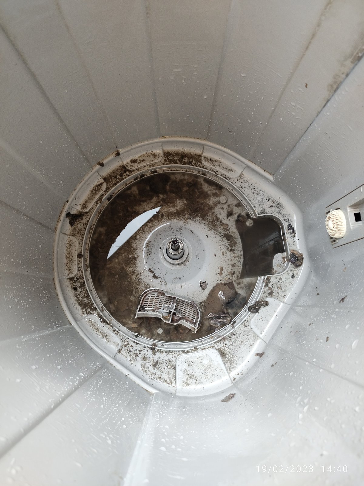

Testing SA8

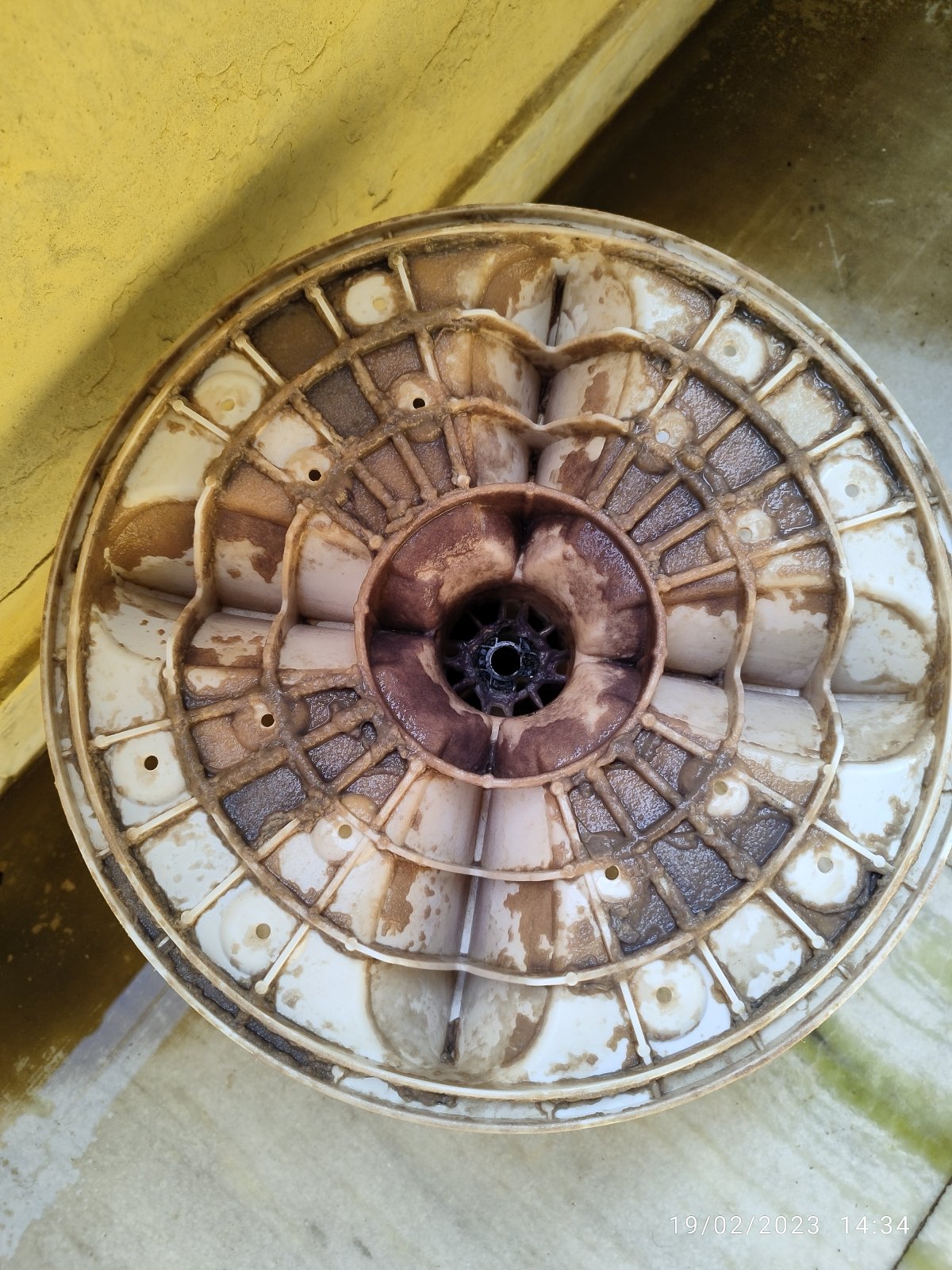

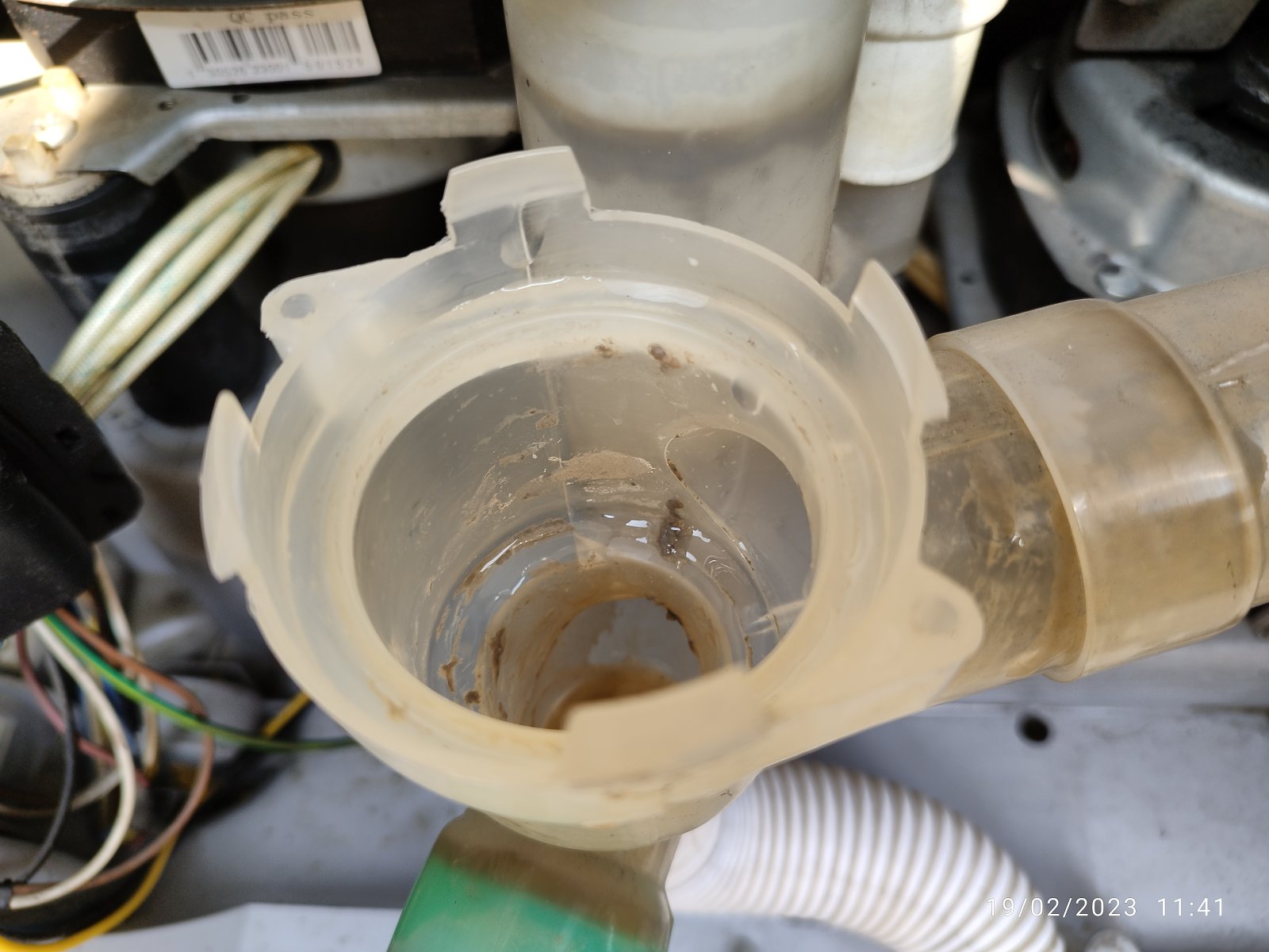

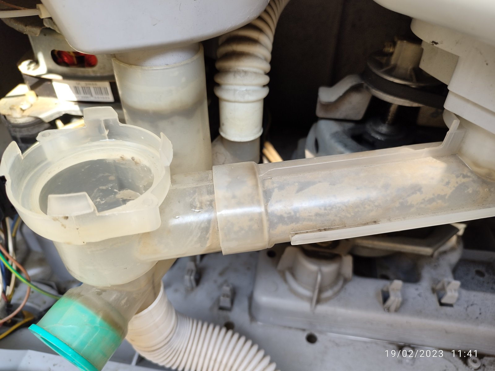

This is detergent buildup. That white stuff is the detergent used. Let's see what he said.
Wow. It's so white that JRR Tolkien would render it as an elf.
What kind of detergent would do this?
He says sometimes he used Tide. I mentioned why I don't like Tide here which is P&G recommend this particular detergent for both top and front load instead of offering specialised variants as they do with Ariel or H-Unilever with Surf.
On a side note, Tide does now have separate detergents for top loader and front loader. It's either newly introduced or nobody knows. It's probably online exclusive as I haven't seen it offline.
But yeah, it's most likely the powder meant to be used for manual cloth washing.
@frozenscotch: mate, the powder meant for manual hand washing is notoriously slow to get dissolved into water. If the water is cold then (in quick wash) even entire 15 minute cycle won't be enough to dissolve all the powder. That's why you have the whole drum coated with detergent. Next time do use detergent meant for front loaders only. They not only dissolve quickly but do so in less amount of water. Plus there's no lather as it's not ideal for FL.
Any that has not faced too many hot washes or regular maintenance washes with some product. The problem is you can't see how bad it gets. If there was some indication then you know what to do. In my case, the prompt was a smell. He had none.

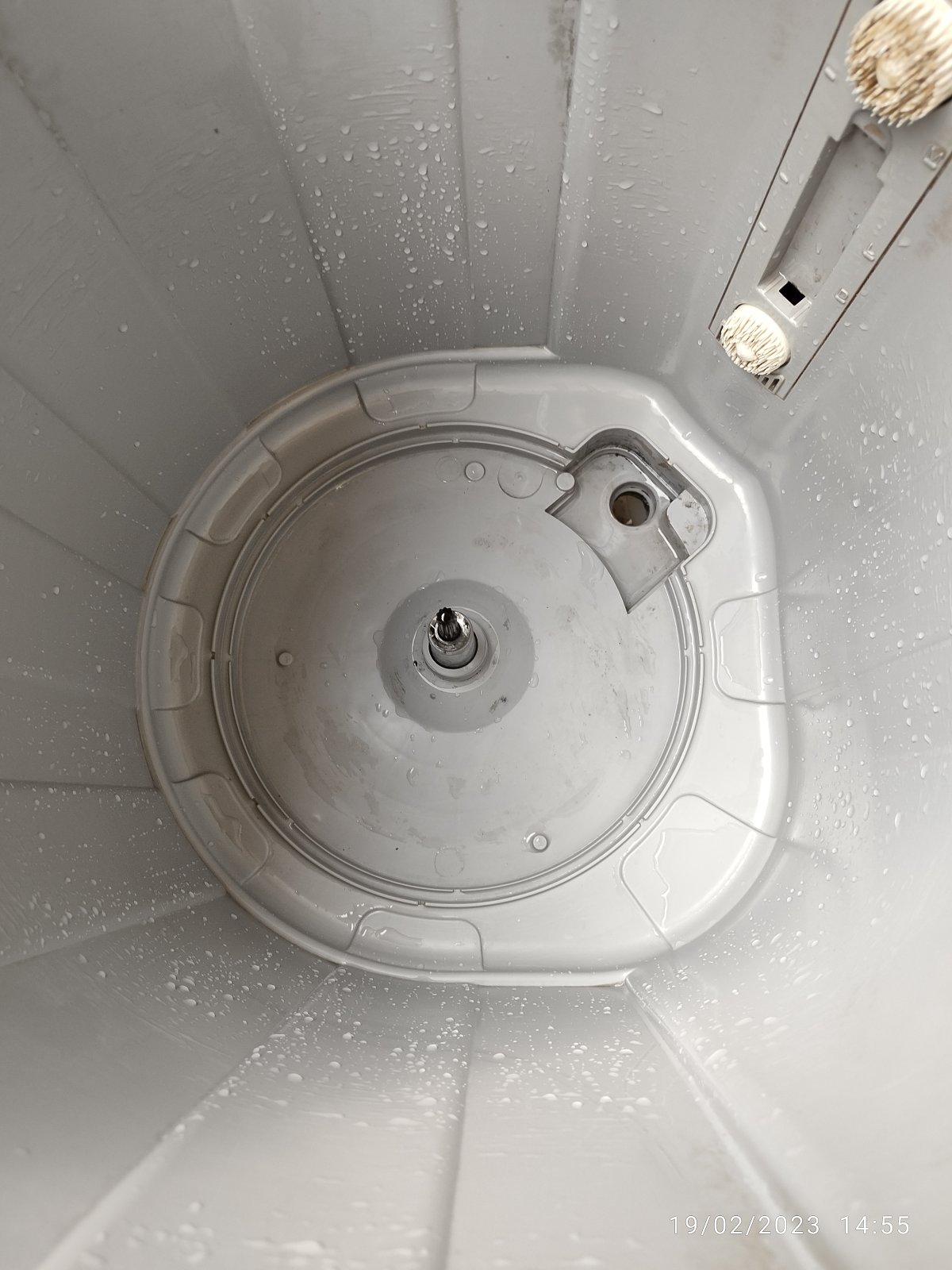

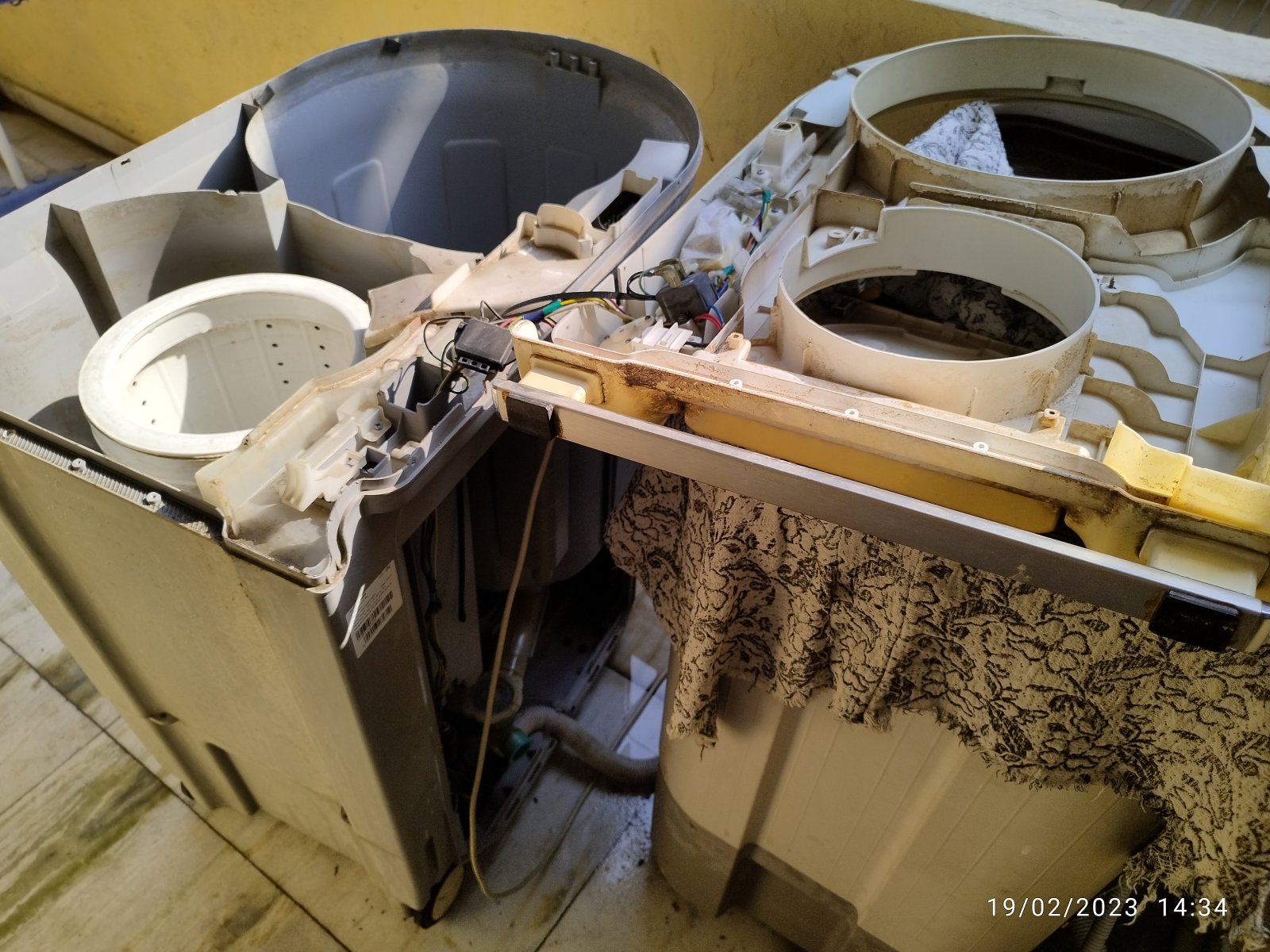

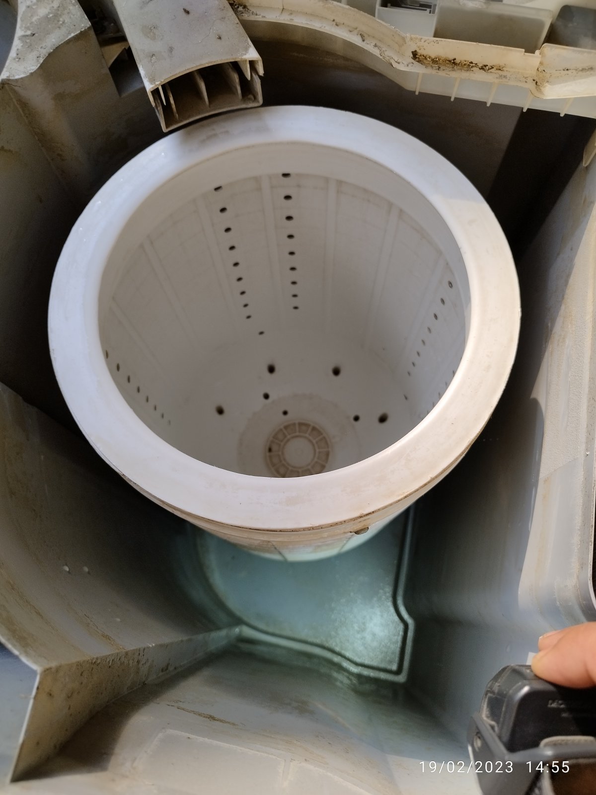

If you notice in the second photo you see there is dirt reaching to the top of the tub. Yeah, this happens even in a machine where the water level is so low :wideyed:
This is why the half-kilo fabric is to be used in the maintenance cycles as that's how the residue got sprayed up that high in the first place by washing dirty clothes.

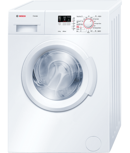

I have a Bosch Front Load Washing Machine (Model No: WAB16060IN) which I purchased in October' 2016... so it's been 6+ years now that it has been running. I have never had any major troubles with it (knock on wood!) barring one time when the front control circuit developed a problem and had to be changed. A mechanic from Bosch fixed it and the unit has been serving me well.
Since there is no 'Machine Tub Cleaning Wash' option in this system I usually run a 90 deg 'Cottons-Hygiene' wash with a couple of scoops of Baking Soda (in the soap tray). I usually do this twice a month at least with 4-5 clean mops in the tub. As daily detergents I use Ariel Front Load Liquid Detergent and yes, I do use Fabric Softeners (Comfort).
Now for the last 6 months I have been really busy (work, had to shift from one house to another one, traveling etc.) and the cleaning schedule which I regularly followed for this washing machine has not been adhered to. Having read this thread now in it's entirety the flame to once again get back to maintaining the cleaning schedule and keep the aging machine in the best condition possible has been rekindled!
From the very first post on this thread I gather that using Vanish and running a full 90C wash cycle for 4-5 times (depending on first wash cycle water-out quality) should be the ideal way to cleanse out the machine. Thing is... my washing machine is used daily for washing clothes ('Regular Wash' Mode at either 30C or 40C) in the afternoons. So, what I plan to do is run the 90C Vanish Cleaning Wash cycle in the morning from Monday to Friday (for 5 days) with some clean mops and towels. I hope this plan is a good one and works as it's intended to irrespective of the afternoon regular clothes washing that happens in the afternoon. What are your thoughts?
Also, I do happen to have one of these Bosch Washing Machine Cleaner with me (new & sealed):
Bosch Siemens Washing Machine Cleaner
It's 200gms and a single use container. Is this going to be better compared to the Vanish process? Real problem is Bosch recommends to use this cleaner every 2-3 months but the product is mostly out of stock on Amazon so getting one is difficult. Vanish OTOH is readily available and poses no availability challenges.
Also, I have never used any De-scaler in my machine, EVER. Should I use them at all now? I believe I should test out the Hardness of water at my new house first because this is a different area of the city. Maybe get this Aquasol Total Hardness Test Kit that you have suggested here on this thread and then go from there? Water does taste more salty in this place than my my previous area though.
Kindly guide me on this. Thanks!
Baking soda is useless. I recommend you switch to Vanish powder. 50gm with about 0.5-1kg of some clean light colour fabric. You need the fabric to control the foam. It will also spray the solution around the entire inner tub and clean it better. If you notice in an earlier post where the tub was opened and you can see the dirt has reached to the top of the tub. Always amazes me when I see that since so little water is used in the wash. Well, this is how you get it all out.
Run that on 90 once a month and you will be fine.
I recommend this monthly as your machine will always be clean that way considering your use of liquid detergent and fabric softener. It will also help the spider to get a near boiling wash like that regularly.
Surprising since it's quite a basic machine without even a digital display. In terms of simplicity and longevity, this is ideal.
Did you get a look at the circuit board when it was being replaced? Was it potted? Meaning covered with a thick layer of epoxy glue so no components are exposed. Or did it look like any regular circuit board with components exposed?
Your machine comes with a sealed tub which can be seen in the parts blowout. Part 309 is the tub. This means even a bearings change requires the entire tub to be replaced. So the way to delay a bearings problem is to ensure you never see foam go higher than a third from the bottom of the glass window. If it rises more it can damage the bearing seals and then the bearings get spoilt.
Now should you ever have a problem that requires a drum spider or bearings change, there are workshops that can open the tub, put in a custom stainless steel spider and seal it back up. These are 3rd party shops. If you can find one where you live the fix will be cheaper and faster. The service centre will not do this and tell you to replace the entire tub which you will have to wait for if they don't have in stock.
The manual makes no mention to do a tub clean wash at all. What you want is to increase the duration of the wash. The hottest and longest is the idea. On my LG if I use the 'intensive' modifier it increases the duration of the wash. A regular 90 shows 1:11 and this goes up to 2:00 with intensive.
A regular 90 deg cottons hygiene should be fine. I see no option on your machine to prolong the wash. There is a way to trick the machine into doing it. When you start the cycle, let the vanish mix in and let the fabric get wet. Then a few minutes later stop the machine and power it off from the console. Restart it and set the same 90 deg cycle again and press start. It will think the wash load is more and increase the duration of the wash. This is just a hack to increase the boil wash duration. Optional.
Post your experience when you do the clean.
Can you get hold of an IR thermometer? It will be interesting to see whether your machine reaches the temperatures indicated on the dial. See here for how I did it.

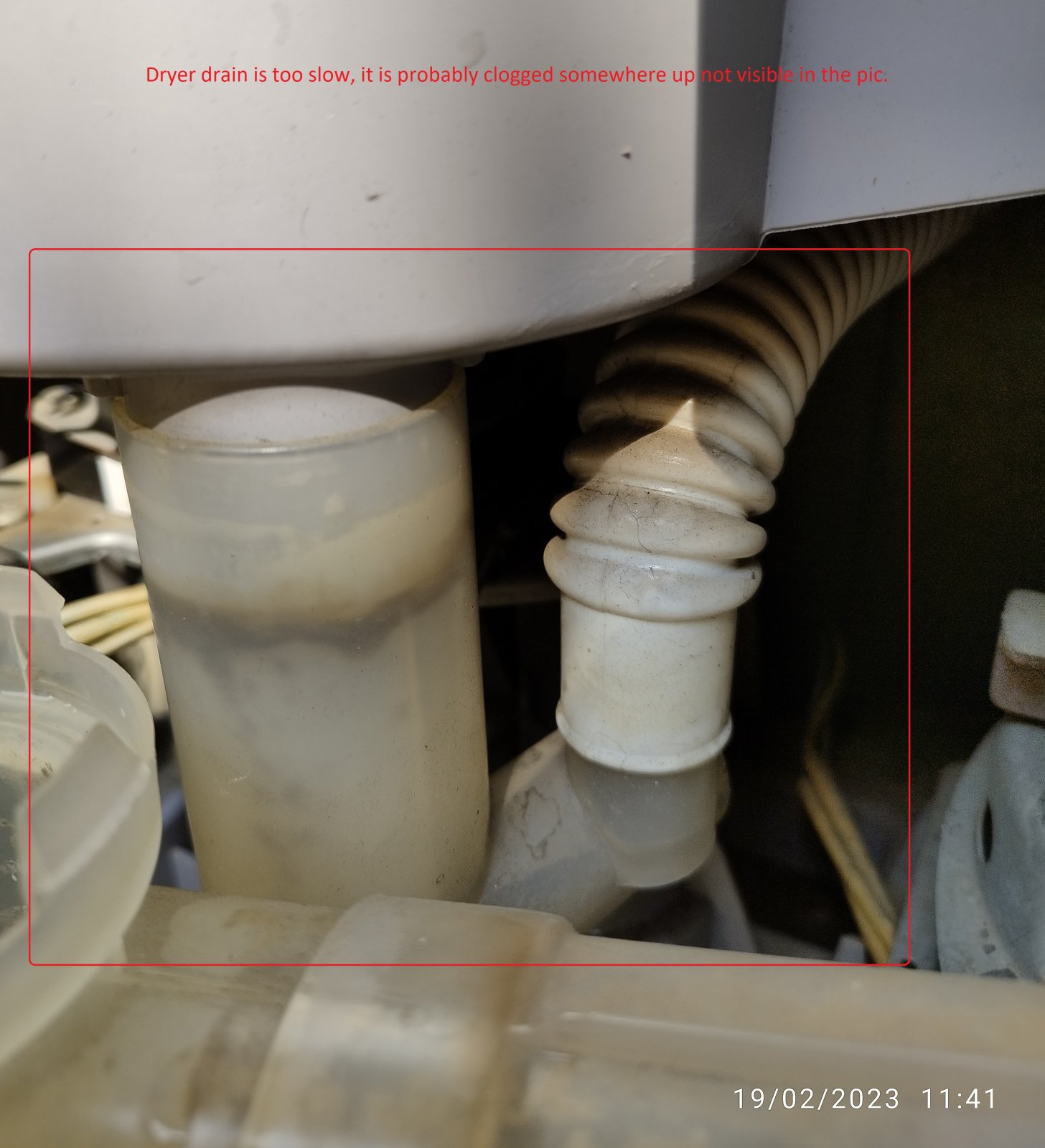

@blr_p Now my dryer is stuck. Water does not drain out properly and it does not seem like I can open the pipes of the drain to clean it. Just looking for best solution to clean the internals of my semi automatic machine.
I used white vinger with cold water so this drain has cleaned up a bit but not to my satisfaction.
What I am assuming now is that vanish will clean the washing compartment but how to clean dryer drain pipes?
Much thx @blr_p
Why did you use cold water ? try with 50 degree water out of your geezer since your pipes are all plastic. If you find vinegar did something then citric acid will work better. Long term vinegar is not good for seals.
Citric acid and Vanish can both do cleaning but they go after different kinds of residue. An example is I wanted to clean a pressure cooker. Since it was made of aluminium I did not use Vanish. I boiled some water and put about 60 gms of citric acid in it and let it sit for two hours. I was amazed to find all the residue came out without any effort and this almost half century old pressure cooker is like brand new.
Hot temperature helps. Giving enough time to do the job also.
Fill them with cleaning liquid (Vanish or citric acid, your choice) in them for a few hours and then drain.
If it is some lint or cotton then it might need some mechanical prodding.

I now remember when this happened. The dryer sound changed suddenly after a wash few months ago by my mom. This was stuck ..
Stuck in this chamber.
Since I had to open the top I cleaned almost everything.
Very happy to DIY this.
Bingo! something slipped in between
For the benefit of all those here who can't DIY their top loaders, how long did it take for that buildup to accumulate? I think you did a clean Feb '22 so just a year old then.
That's what I would expect in a machine that cannot do hot washes. I don't know if you use fabric softener but this is all the residue from the SA8 detergent.
How hard was it to remove? was it stuck on and required effort or just peeled off.
The best plan for you is to do this manually on a yearly basis. Everyone else sticks to hot maintenance washes every couple of months or in my case, I alternate between an 80-degree wash and a tub clean with higher water level every month.

Bingo! something slipped in between For the benefit of all those here who can't DIY their top loaders, how long did it take for that buildup to accumulate? I think you did a clean Feb '22 so just a year old then.
The build up that I cleaned exactly 1 year ago was done after many years (first time tbh machine is 6+ years old). I was surprised to see this build up today. Drain was clogged last time not this time. The blockage was in the dryer chamber because of something slipping in not pure buildup as you can see.
I can do hot wahses by using hot water frequently if it really helps. I don't use any fabric softner but can change to something else if you suggest.
Very easy.

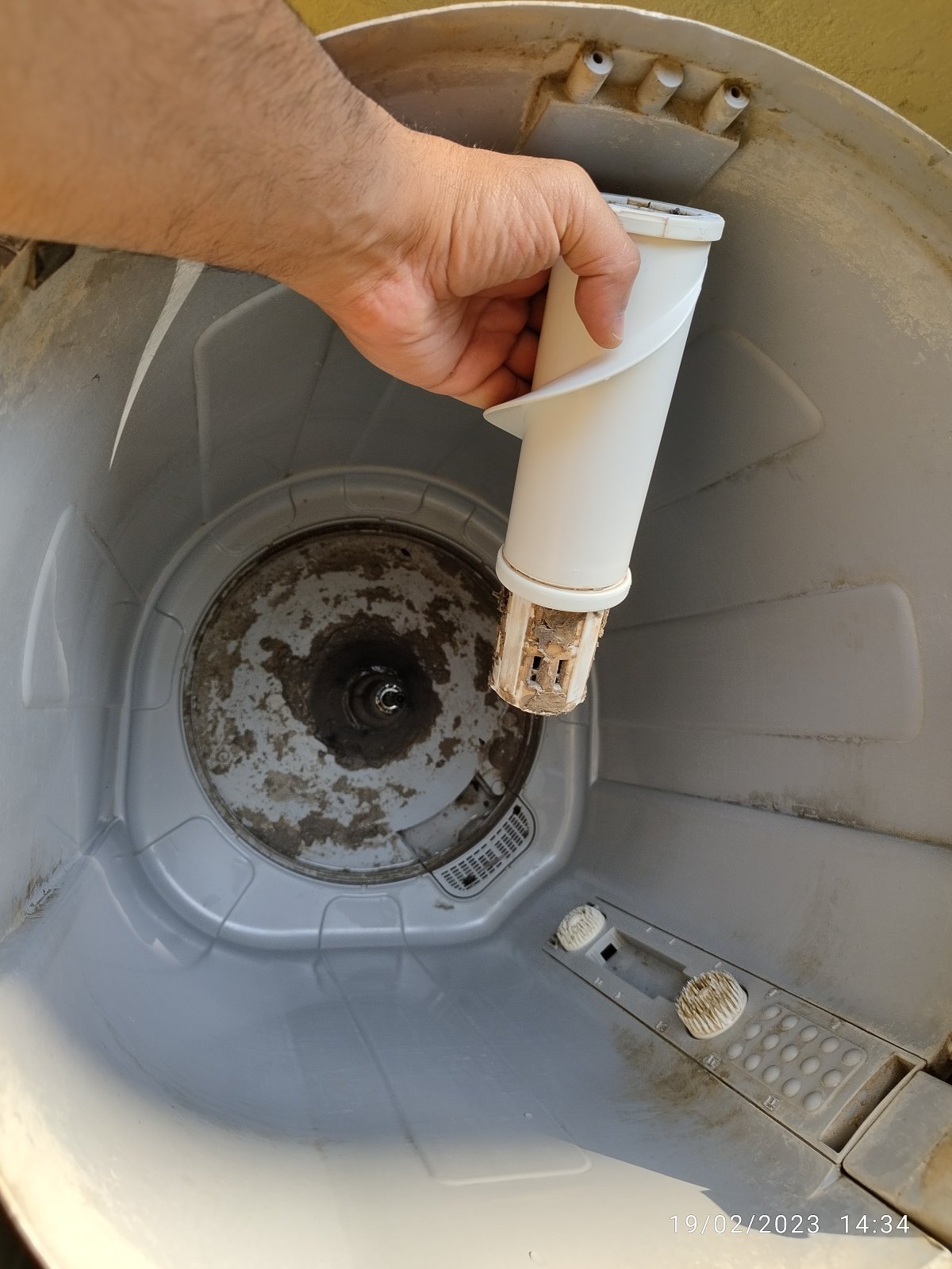

Something was here which is missing as it broke off. Could all the fast build up be because of this missing?

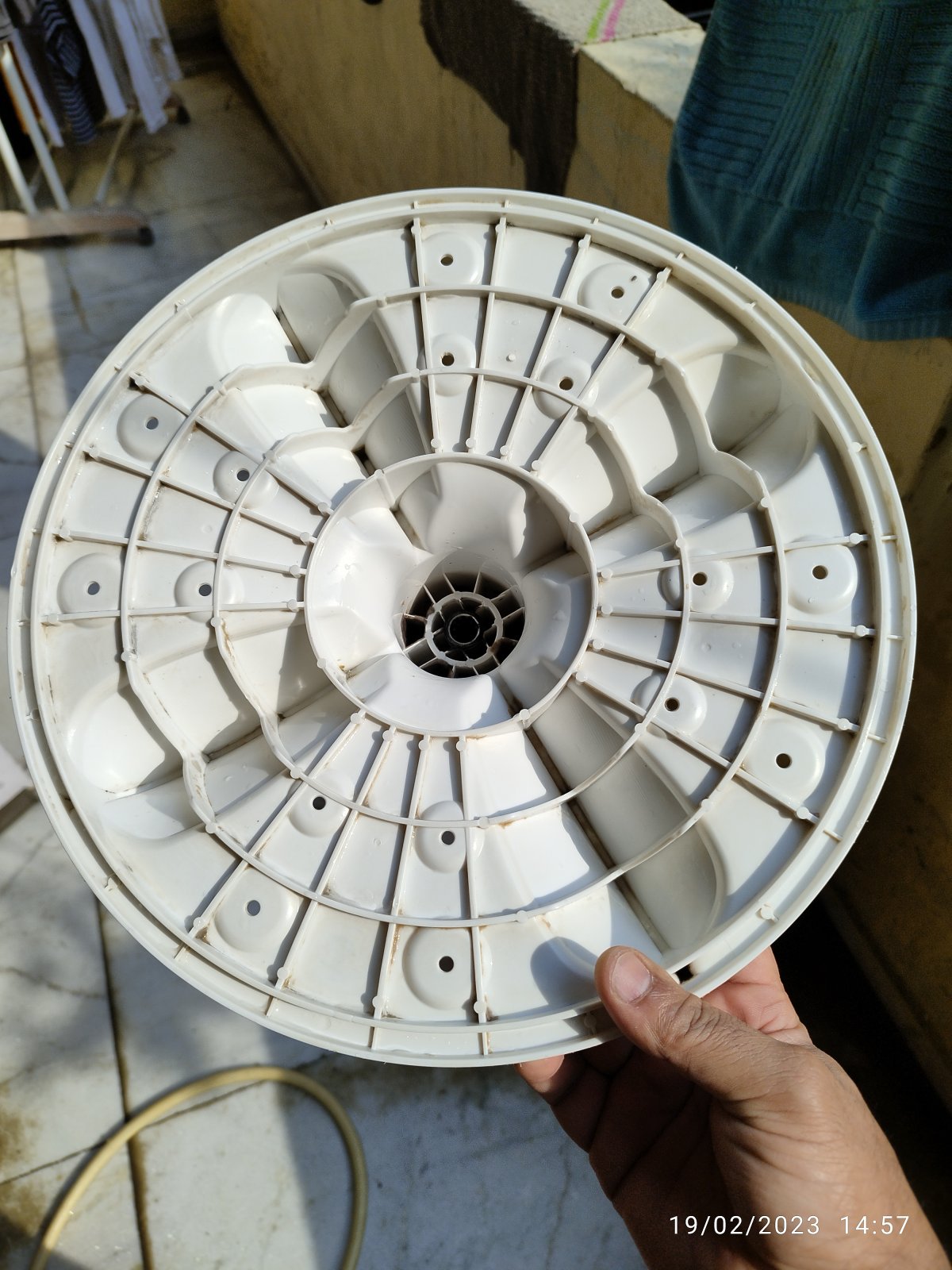

The buildup under the impeller is mainly from the SA8 then. I do not see any scale so you do not need a descaler. Not sure if the black stuff at the bottom of the tub in the second photo is mould. Maybe.
That is one year of SA8 liquid detergent buildup. Good you posted these photos as they serve as an approximation for others as to what to expect when using liquid detergent. If Fabric softener is also used then expect double this residue, particularly if you cannot wash in warm water or use hot water. This is why the LG top loader manual says to make every fourth wash a warm wash.
Very easy.
That is good news then for others who cannot get into the machine. So long as maintenance washes are regular the wash action should clean most of the residue.

Your case is easy as there is no steel basket so 90% of the tub will be clean. The residue is only under the impeller and the part of the tub that the impeller covers.
So you only need enough hot water to completely submerge the impeller and no more. For those with regular top loaders, they will need to fill the entire tub right to the top as there will be residue on the back of the basket as well as the rub.
The missing something is your lint filter which seems to be missing for some reason. There is no lint that I can see in your latest photos. The buildup under the impeller is from liquid detergent residue.
To clean these pipes the hot Vanish solution needs to fill them and sit there for at least an hour. So you will have to figure out how to fill them. So after five minutes maybe run the drain pump. Plug the pipe outlet then stop the drain pump. Let it sit for an hour then let it out when you empty out the main tub.
Considering the amount of plastic piping as well as the tub in this machine you should not use any chlorine bleach like Clorox or Rin. Try the Suma D4 tabs if you need to remove any smells or mould. Use about four with enough water to cover the impeller. That will be about 5-10 litres of water. Let it sit for an hour in hot water. Keep in mind the Suma will not be as effective at removing detergent residue as Vanish. In theory, you should not need the Suma but it's good to have it if necessary.
