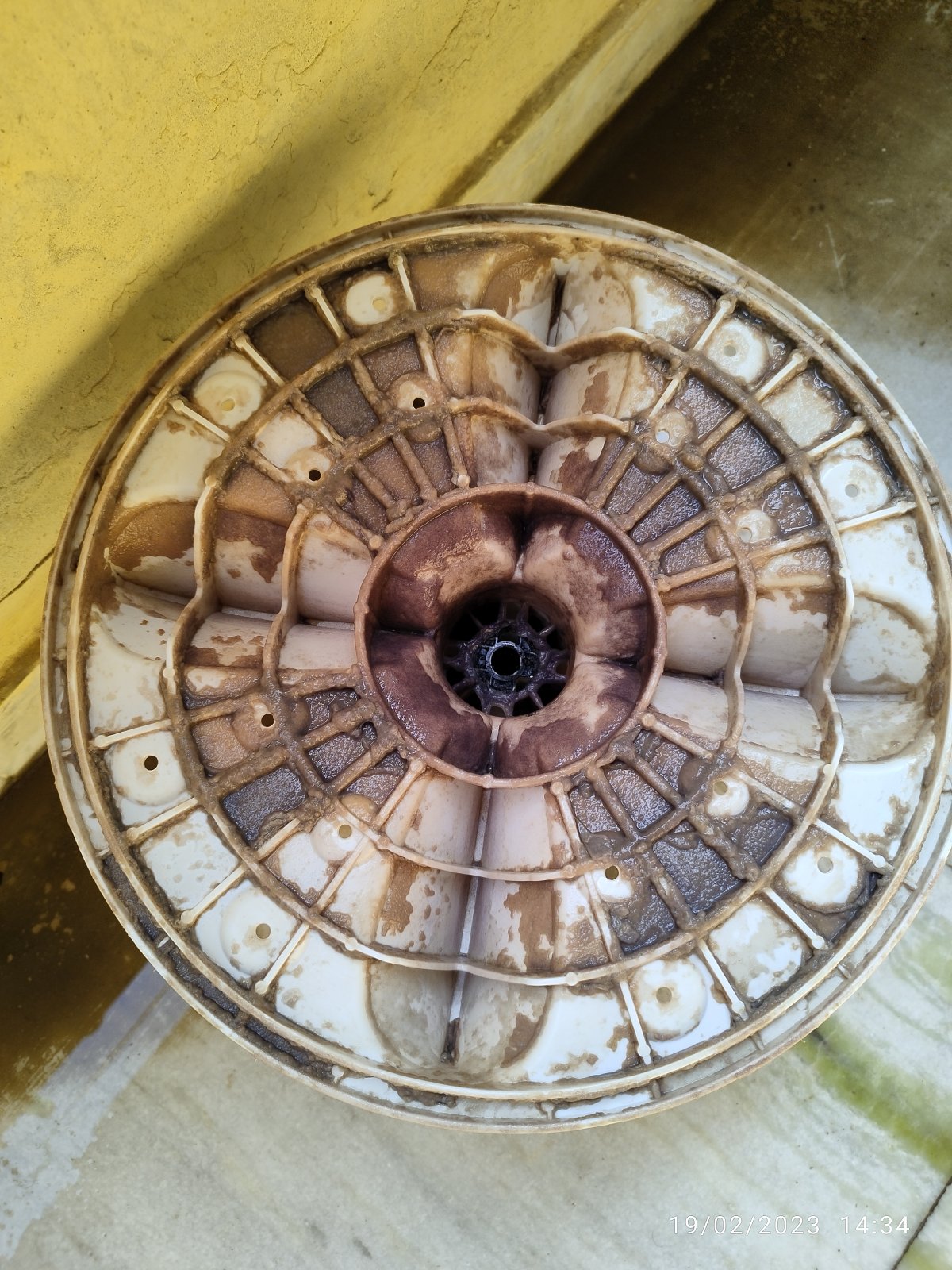

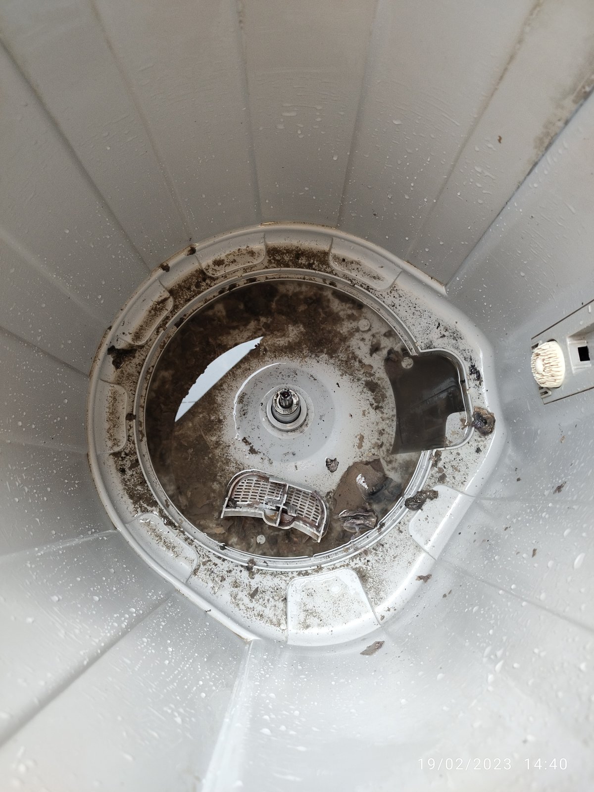

The buildup under the impeller is mainly from the SA8 then. I do not see any scale so you do not need a descaler. Not sure if the black stuff at the bottom of the tub in the second photo is mould. Maybe.
View attachment 160927View attachment 160928
That is one year of SA8 liquid detergent buildup. Good you posted these photos as they serve as an approximation for others as to what to expect when using liquid detergent. If Fabric softener is also used then expect double this residue, particularly if you cannot wash in warm water or use hot water. This is why the LG top loader manual says to make every fourth wash a warm wash.

I don't know what clog you are referring to but if you want the deal with the residue under the impeller...
Yes it is soft easy to remove dirt whatever it is called.
100gm Vanish powder in hot water. Let it run for a few minutes. Then let it sit for an hour. Then run it again for 15 minutes. Done. Repeat every couple of months. Dissemble after a year and compare the difference with the photo above. Your case is easy as there is no steel basket so 90% of the tub will be clean. The residue is only under the impeller and the part of the tub that the impeller covers.
So you only need enough hot water to completely submerge the impeller and no more. For those with regular top loaders, they will need to fill the entire tub right to the top as there will be residue on the back of the basket as well as the rub.

The missing something is your lint filter which seems to be missing for some reason. There is no lint that I can see in your latest photos. The buildup under the impeller is from liquid detergent residue.
It broke.

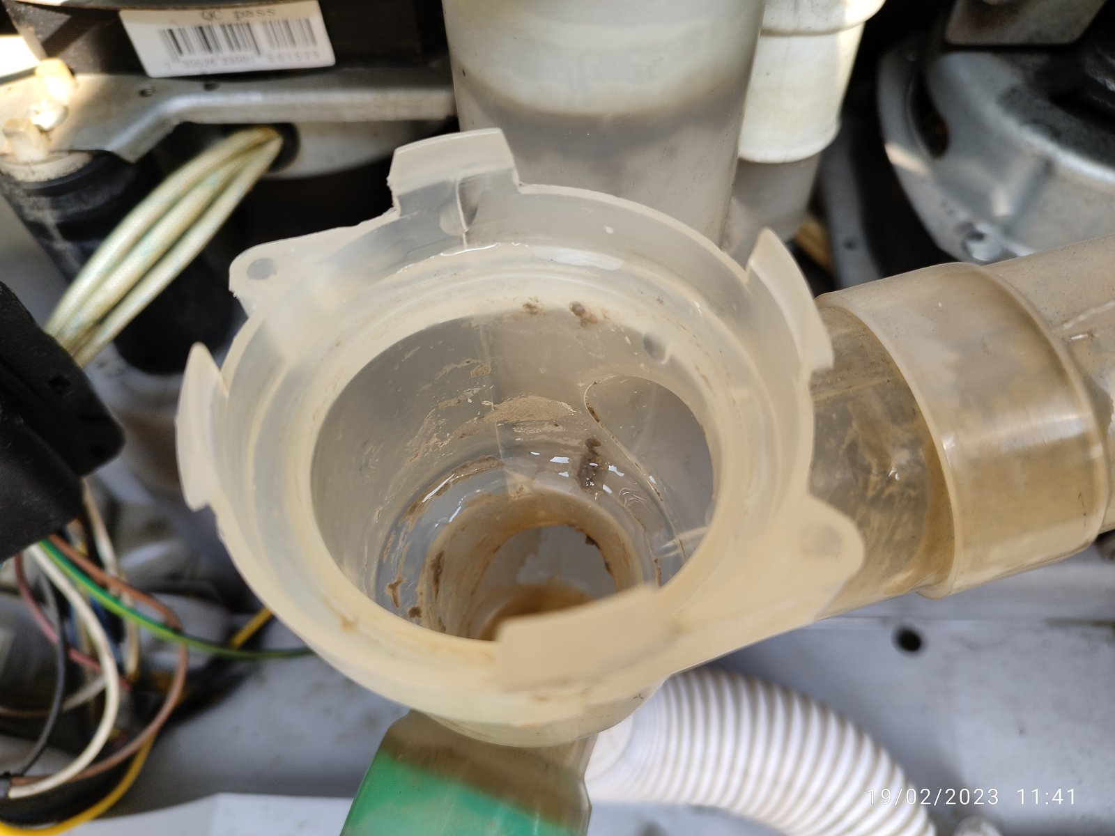

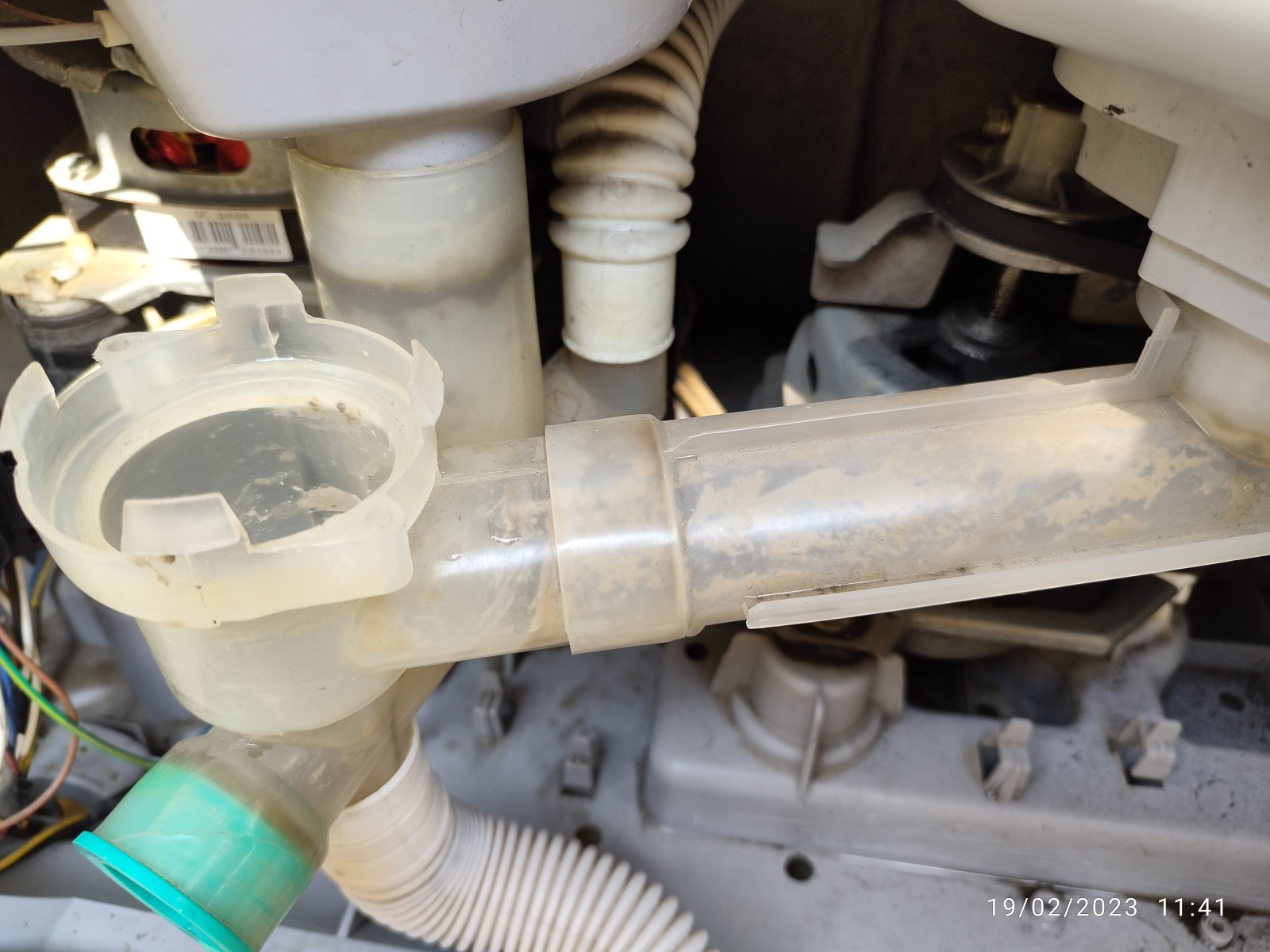

View attachment 160929View attachment 160930
To clean these pipes the hot Vanish solution needs to fill them and sit there for at least an hour. So you will have to figure out how to fill them. So after five minutes maybe run the drain pump. Plug the pipe outlet then stop the drain pump. Let it sit for an hour then let it out when you empty out the main tub.
I figured out how to do this while cleaning. Machine needs to be opened from rear.
Considering the amount of plastic piping as well as the tub in this machine you should not use any chlorine bleach like Clorox or Rin. Try the Suma D4 tabs if you need to remove any smells or mould. Use about four with enough water to cover the impeller. That will be about 5-10 litres of water. Let it sit for an hour in hot water. Keep in mind the Suma will not be as effective at removing detergent residue as Vanish. In theory, you should not need the Suma but it's good to have it if necessary.
I won't thx again :)

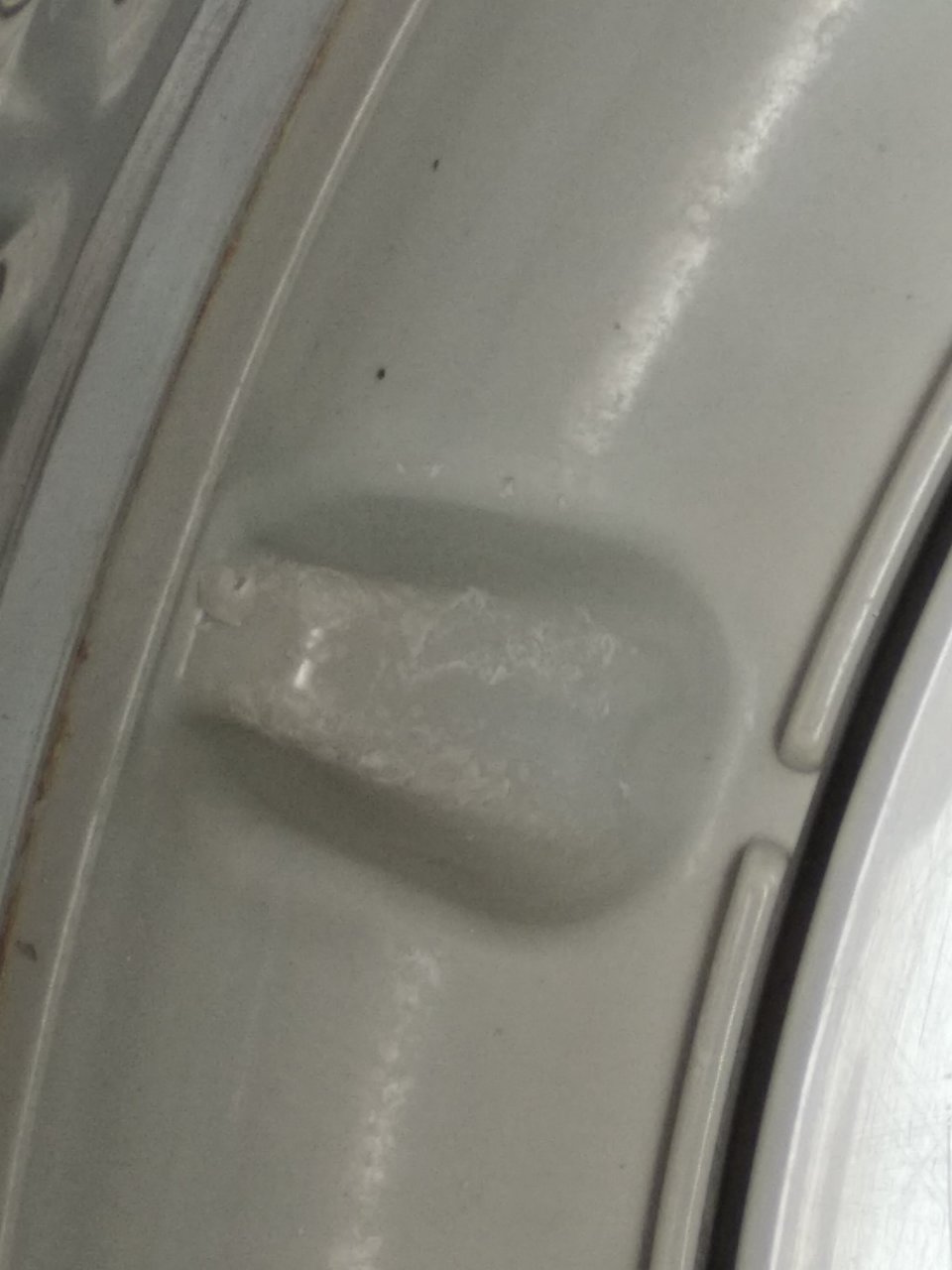

That descaler powder messed up the plastic in my washing machine. All the top part of the plastic inside the drum has become like this. Some deposit looking like a fragment of a rock came out by breaking some plastic edge below the agitator I think. Guess I'll have to buy a new wm soon. Don't know what broke since the machine finished it's job without complaining.
If I'm not wrong, that rock is the scaling itself. And those marks you see on the plastic maybe that's how the original plastic looked like before it got dull looking scaling cover. I'm not sure but I think you need to run descaler a few times more. :dead: . @blr_p might know what's happening.
What descaling powder?
Yes, that rock like thing was scales which got removed. I never saw the plastic in such bad shape before I used this descaler brand. Ice used IFB and other descalers and none of them messed up the plastic in the drum.
What I understand by the "top part of plastic inside the drum" is the disc that encircles the impeller. Just that.
The part you posted here isn't the impeller but a disc that encircles it IIANM
How is the impeller and is there any damage?
I find it weird that just one component got damaged but otherwise every other plastic thing in the machine is fine. Is that correct?
How long have you been using that descaler to get an idea of the time it takes to cause this damage?
Yes, looks like the part encircling the impeller. The top of the impeller is fine. I don't have the tool to remove the nut that's holding it to the tub to see what damage has been caused. I don't know where that plastic bit came out of. I've searched the tub but nothing is broken afaics. The part does seem it came out of the machine because it was there in the clothes when I took the clothes out after everything was done.
I used the descaler for about 2-3 hours i think. I had let it run the entire wash cycle and shut off the machine for 2 hours because I didn't see any dirt in the water. After that I let it complete.
In other words, just one part was affected and nothing else. That is the part made from ABS and the rest is all PP. Why would they make one part from a different plastic :banghead:
Don't have to remove anything. If the impeller is fine then the bottom is as well.
The way you said messed up your machine i thought the damage was much more extensive. It is not. Just that circle.
So this happened after just one try then?
Should be easy enough for people to tell then. If there is no visible damage after the first use then it will be fine.

In July I think. Had only one packet of that IFB descaler which cleaned a bit.
This is the bit I'm interested in. You're saying IFB's descaler helped? :oops:
To get an idea of the damage to @6pack ' machine, It's ONLY limited to the area between the red circles.
It probably came out of this gap. You should post that rock here.
That implies the disc is PP which I would expect. These are injection moulded parts. It makes ZERO sense to use a different plastic for the impeller and that disc which for all purposes looks identical to me.
But if you see further up there is some damage to that disc. So it's not clear. Is it damage caused by the descaler or just wear and tear after ten years of use?
Now that it is clean you can more clearly see the plastic.
Another thing is the disc appears white here but the pic he posted later is grey. Could just be the lighting.
