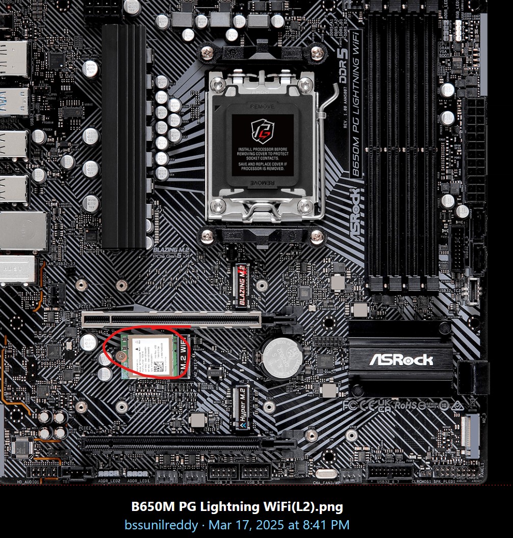

Then how can we connect the wifi E card?
There is no facility provided at the rear panel.
See here once:

If you guys would actually look at the board.... It does have M.2 E slot thats for WIFI. :laughing:

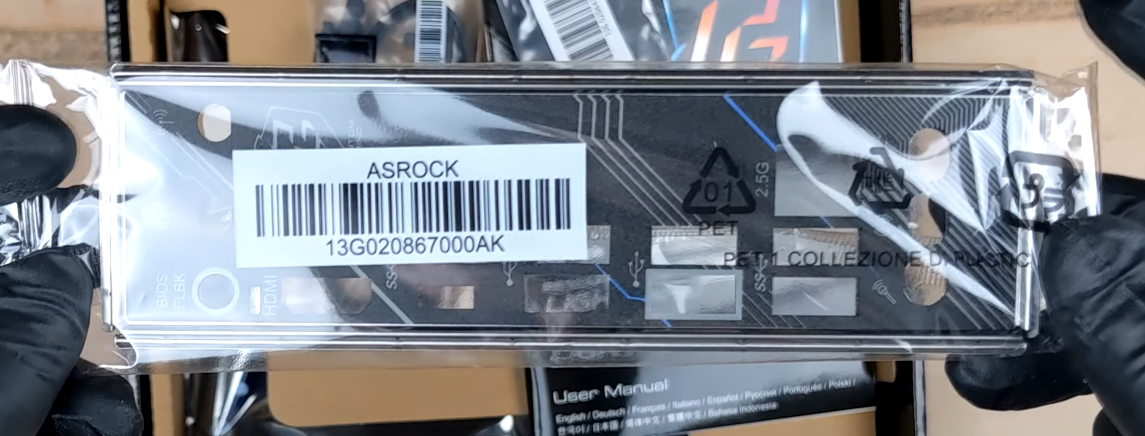

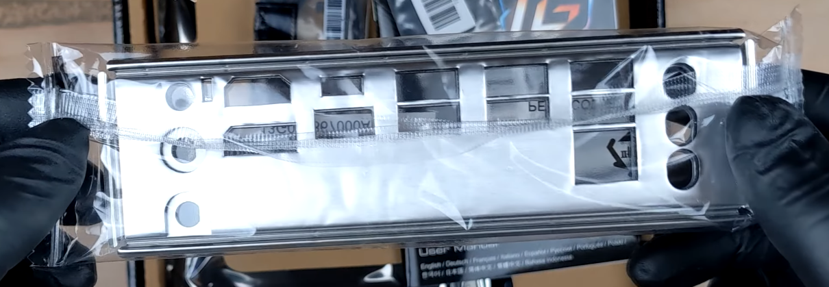

Asrock might be showing non wifi PG Lightning images for Wifi PG Lightning model I think.
They are showing correct images because the antenna slots in the I/O shield are on both WIFI and non-WIFI motherboard models. It's cheaper for them to make one I/O shield supporting both models (and maybe more) than to make multiple different ones. After all if the consumer decides to buy non-WIFI model and afterwards install WIFI module by themselves they won't have to install the antennas in PCIe brackets. It's a win-win thing.
