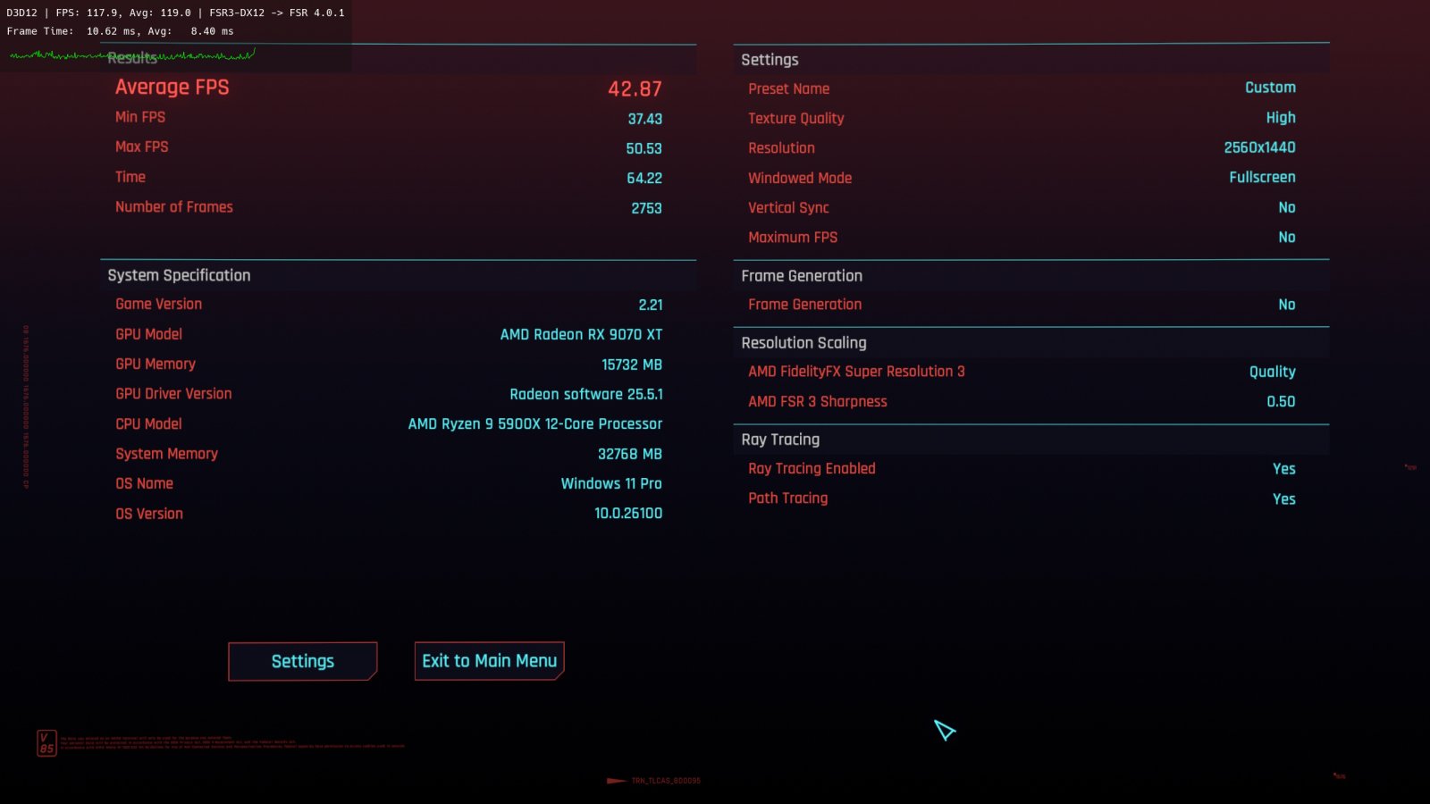

Did a quick run of built-in benchmark in Cyberpunk 2077 at 1440p. Settings:
  • Preset: RT Overdrive (i.e.Path Tracing enabled)
  • Upscaling: FSR3 Quality -> FSR4 Quality (using Optiscaler)
  • Film Grain and Chromatic Aberration turned off
Take note that I am running my 9070 XT with -30% total power, so a regular one should perform better. ~43 FPS seems okay, and you can turn ON frame generation to have a smoother presentation.
I personally play at 4K, and this card isn't fast enough for 4K + Path Tracing even at FSR Performance, but regular RT modes work well. I also find 4K FSR Performance to be much more temporally stable than 1440p FSR Quality.
Let me know if there are any other specific benchmarks you'd want me to run.

This is what i wanted to see thank you so much for taking your time to post this

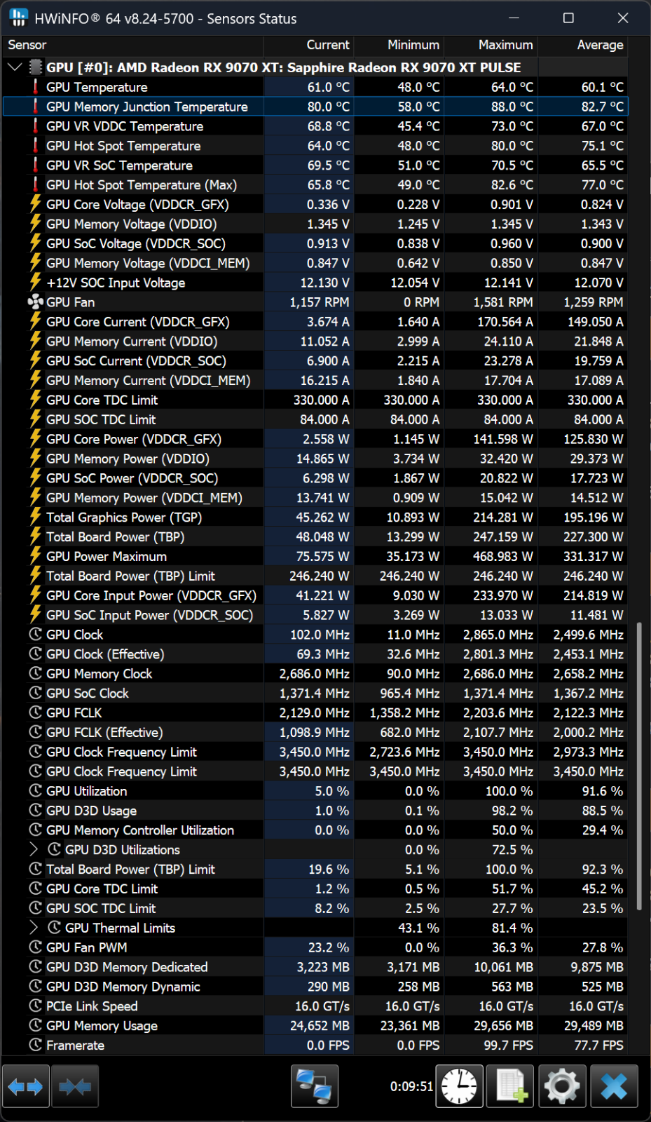

Funnily enough, I moved back from 70% PL → 81% PL to regain some performance. Here's my temps after a 5 run loop of the Metro Exodus Enhanced Edition benchmark.
  • Core Temp: 64 °C
  • Hot Spot Temp: 80 °C
  • Memory Temp: 88 °C (!)
  • Fan Speed: 1581 RPM
Attached a screenshot of HWiNFO as well. I get the feeling the GPU is programmed to allow memory temps to reach ~90 °C. My ambient temps are ~10 °C lower with the recent rains, but GPU temps seem same while fan speed is lower. I had seen over 2K RPM when benchmarking last month during the peak of summer.
yes, so you will need to change fan curve to get lower temps. At 2k rpm you will get lower temps vs before.
Since fans can be easier to replace, i run them slightly higher ~65-70% in my case and get lower temps.
Memory temp in high 80s seems to be normal, so it should be fine.
