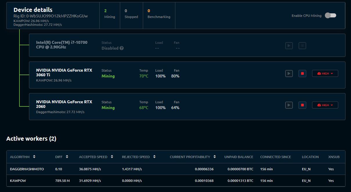

So I recently bought 3060ti LHR for 49k and I had planned on selling my 2060, which has been mining since march, to recoup some of the cost but in the last couple of weeks Bitcoin and Ethereum have gone up quite a lot and LHR cards, contrary to popular belief, are quite profitable. My 3060ti LHR is more profitable than 3060 non-LHR and all 2000 series cards except 2080Ti.
So I have decided to keep both for the time being.

68-70C do you want to roast those GPUs while mining bro????
Try keeping them under 60C and reducing your OCs [emoji14]
temps are around 62C with them.
Still very high. Core Temp should be less than 55-56C. Run OCTune and lock coreclock at 1100MHz and Memclock at 2250MHz.
2060 should give 32-33mhs hashrate. You are consuming more electricity and running on higher temps with lower hashrate. Very inefficient.

Those temps are achievable only in an open mining setup, no way to get those temps in a normal pc case with 2 GPUs running so close to each other.
As for the 2060, I have it running at lowest possible voltage ( uses 85W) , it's memory just doesn't overclock that high.
Those who are unaware, Kawpow uses core as much as VRAM and it needs all the power mostly so you cannot have low temps on that
Daggerhashimoto doesn't use core as much hence you see lower temps on that.
Yes, I'm running it at 80% tdp so around 160W.

As for the 2060, I have it running at lowest possible voltage ( uses 85W), it's memory just doesn't overclock that high.
..but as I can see you are running just Nicehash's overclock at 'High' which is not the best OC in the world.
Any experienced miner would advise you to OC yourself via OCTune or Afterburner and not depend on Nicehash. You can check below screenshots for some idea -

Yup, both Kawpow (raven) and Octopus (conflux) are core intensive which means power hungry which implies higher temps than ethash, but it's not that bad actually if you know how to OC or undervolt properly Also there is a workaround imo so that GPU doesn't heat up -
1) either lock the coreclock at lower clocks => lower power consumption => lower temps
2) or max out the coreclock offset but minimize the power limit
Kawpow doesn't need memclocks so keep it at 0 offset or even reduce it and see if Watts drop. You will lose out on few hashes but your GPU and electricity bill will remain in check or you can just mine Autolykos2 (Ergo) which is a mem intensive algo like Ethash.

I'm not using QuickMiner as it only support daggerhashimoto which is not very profitable for 3060ti so I'm using normal Nicehash miner so I can mine using different algo on both GPUs. The problem with Normal Nicehash miner is that it doesn't have a OCTune (as far as I know), instead you have to use the power targets in the web interface ( where it says high in the screenshot ). It can be disabled using a toggle in the nicehash app. I have disabled it and using afterburner to undervolt and set power limits. So basically that toggle in the web interface doesn't do anything unless I toggle it in the app.

Maybe with high end cards like Strix or MSI Suprim but I'm happy with the temps considering I have low end INNO cards.
Okay, that's an issue. Why not run quickminer/trex miner for 2060 and the other miner for 3060ti? Though I can understand if you won't like the hassle of two miners.
