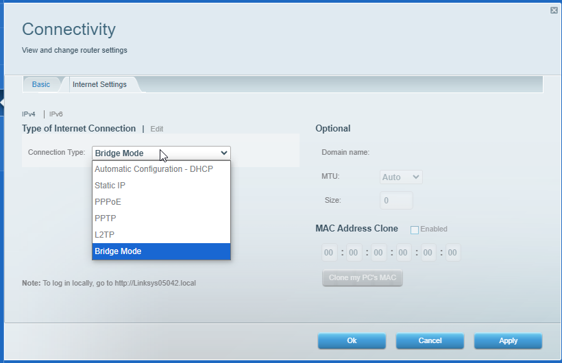

In linksys firmware bridgemode option does not allow to enter static IP right?
You need to do DHCP binding in your airtel router of whichever router that is assigning IP and put the mac address of your Linksys routers in the main router and assign them a static Ip there.
