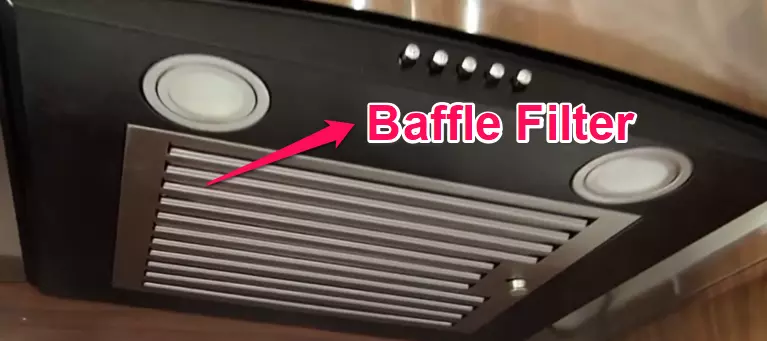

I looked for -
high suction power - 1000 and more will be fine
baffle filters - these can be self cleaned and last longer. carbon filters are costly and has to be replaced. i didn't prefer filter-less, don't remember now why, but it has its downsides I guess

Basically, u need a filter to filter out oil particles. Smoke will go out of the duct. Oil will be trapped if you have the filter. If not , it goes upto the suction motor.
Auto clean is a concept where motor runs at high speed , which melts all the oil and grime that is collected over the time inside the chimney and is collected in a container at corner of the chimney.
So, you need to do this auto clean process more times to keep ur motor clean and run efficiently.
I personally, not comfortable to put motor at risk, instead , I want a filter as a protection which will hold all this oil and grime. You can simply clean these baffle filters by soaking them in hot water+lemon+detergent for couple of hours. They are made of SS, and hence long lasting.
